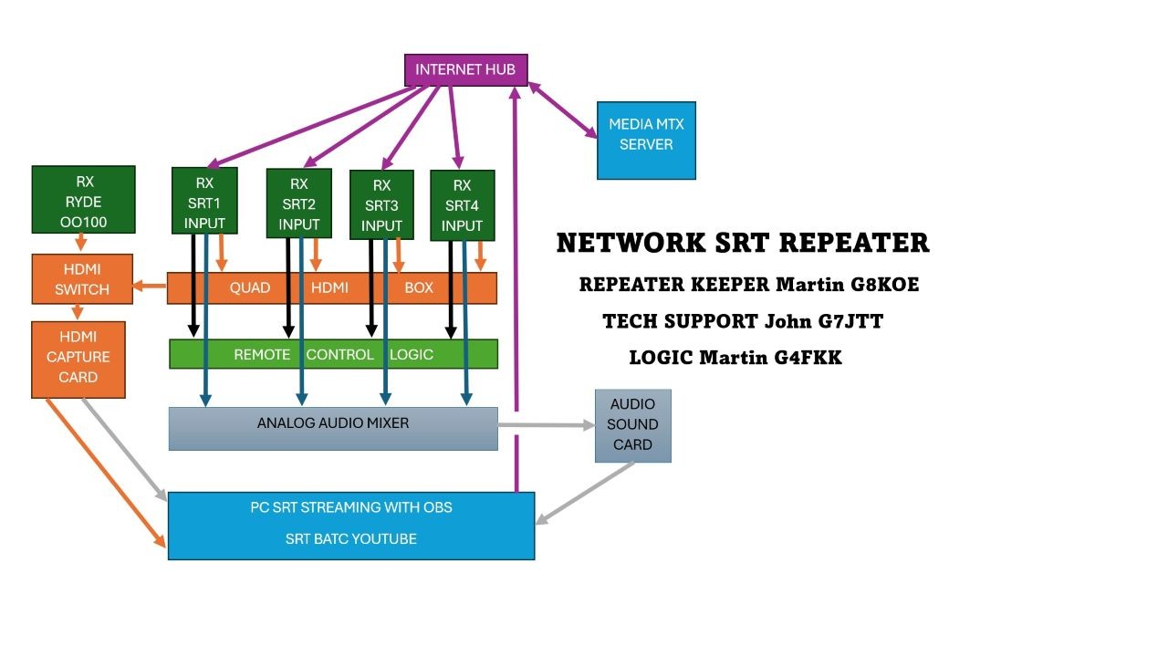

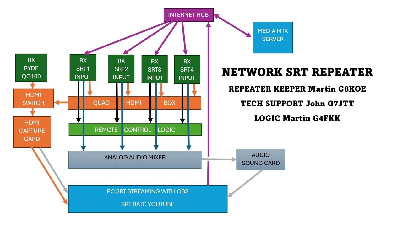

Re: Secure Reliable Transport
Hi Andy,
I had help from John G7JTT with the Media MTX server.
The logic was Martin G4FKK.
A block diagram of how it is connected.
73's
Martin
G8KOE
73's
Martin
G8KOE
