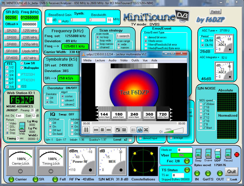

Now my MiniTiouner works well with MiniTioune (=Tutioune for this specific Home brewed tuner).
Minitioune V0.1c_beta SR250.jpg (379.22 KiB) Viewed 13463 times

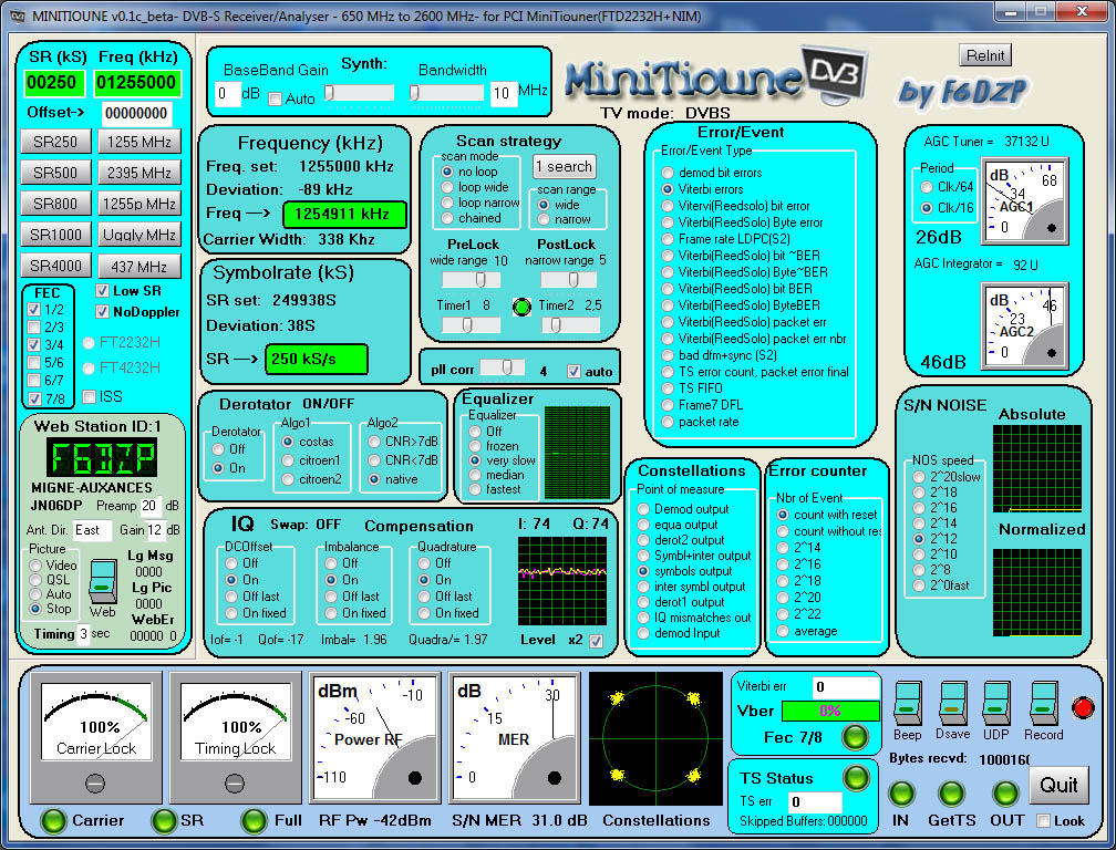

I have tested SR125 up to SR5000.
latency is very very short for low SR as I am using a very little buffer.
vLC receiving TS from Minitioune1.jpg (328.87 KiB) Viewed 13463 times
I use VLC for decoding video and audio. Latter it will be done by MiniTioune.

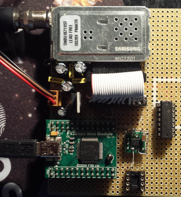

Finally I used very few components:
- FT2232H minimodule
- Samsung DNBU10711IST NIMtuner
- 74HC10 (DIP14)
montage avec NIM samsung_.jpg (128.99 KiB) Viewed 13463 times
about power supply, we need 5v, 3.3v and 1v.
I use an external 5V power supply(but we can add a 5V regulator if we want to use 11v to 14v for mobile...)
I have added a 3.3 TO220 regulator and a LP3879 with only 3 capacitors for 1V.
I will add a LNBP21 to produce 13v, 14, 18v or 19v for LNB or LNA power supply and it gives also 22kHz signal.
I have tested also SHARP BS2F7HZ0169 that is OK for low SR;
Next week I will test the EARDATEK EDS-4B47FF1B+ that we can find inside TBS5980 ot Prof7500 USB tuner.

Beta version of MiniTioune is available for betaTester.
I have began to get my notes for creating the schematic.
We have to decide definitively which option we put. I suggest to put both connectors that fits for SHARP/EARDATEK or Samsung NIM.
We can add easily some led to know that TS is present, or a PIC to switch something when TS is present or for counting packets ...???
Who want to create some proto pcb for that?
Shematics are on vivadatv forum.
Jean Pierre F6DZP

Minitioune software now works with 3 different NIM tuners: Samsung, Sharp and Eardatek. We have just to say which we use in Minitioune.ini
All of these NIM allow to work down to 125 kS/s with a fast lock as tutioune1600v0.6h do.
Beta version of Minitioune is available for who want to test.
Jean-Pierre F6DZP
