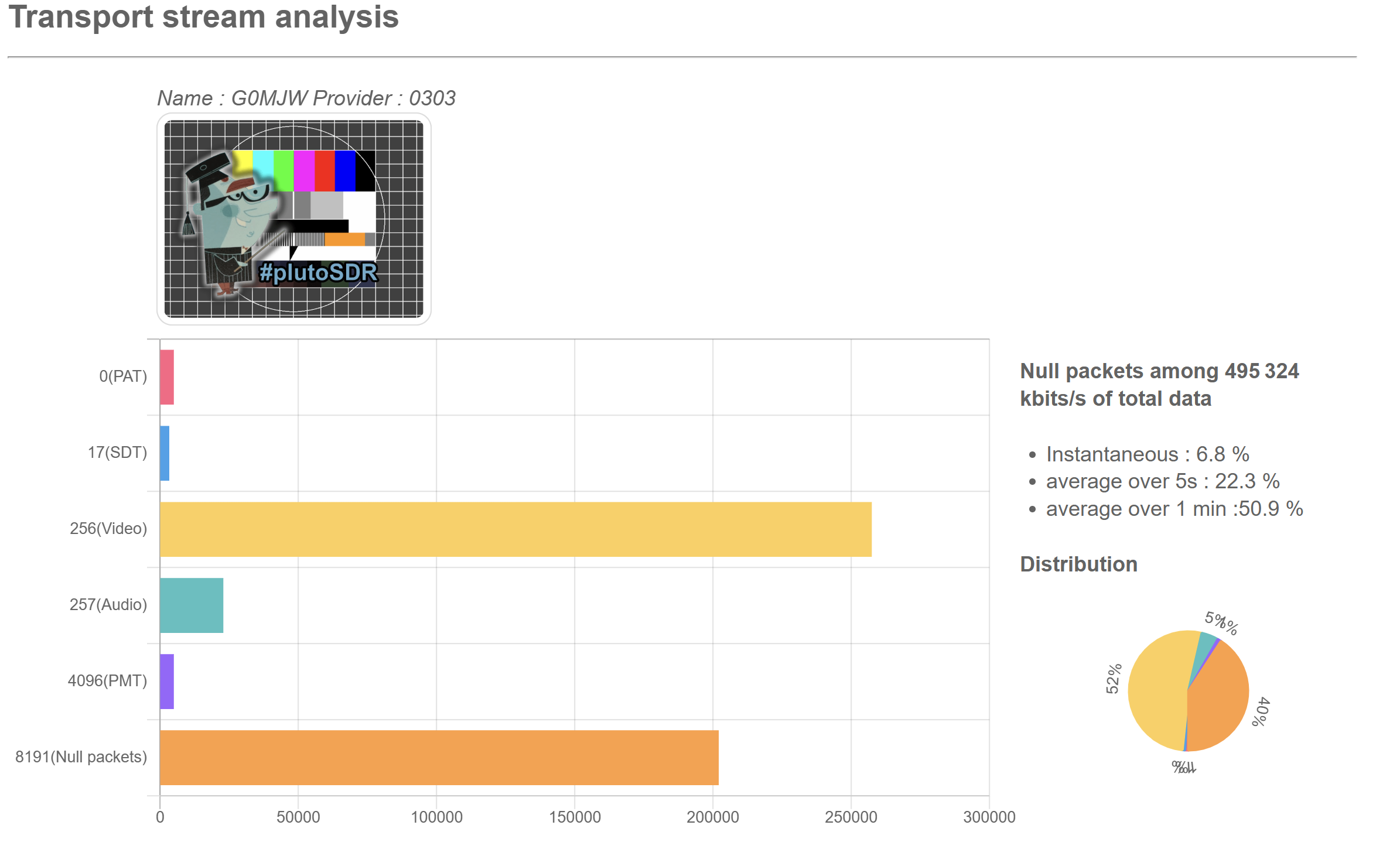

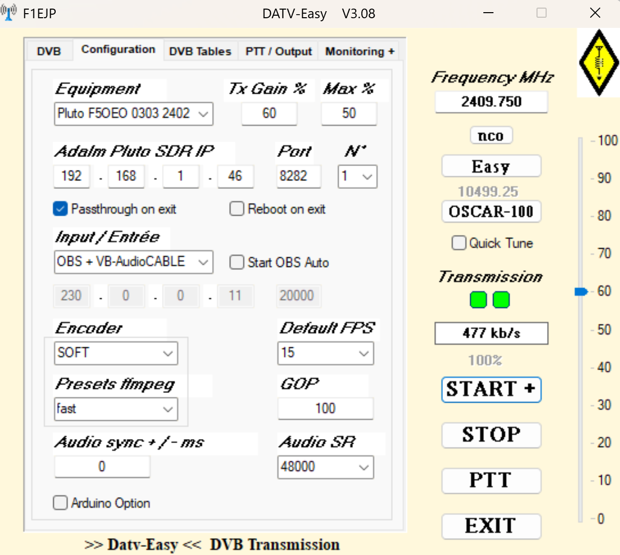

I don't use DATV Easy. However it has two basic modes, DATV and Passthrough. You will want one or the other. They are under the system tab. Don't forget to apply settings. I also have the "Remux - Force compliant" further down that page enabled.
However, it appears DATV easy sets these itself because there is a "passthrough on exit" checkbox in the DATV easy configuration. When I checked, my Pluto was in DATV mode when DATV-EASY was sending and it had also disabled the Remux. I had to fix that as I use it with my script. So, my conclusion is you don't need to do anything in the Pluto 0303 websettings with DATV-Easy.
Some screenshots
TS analysis tab on Pluto:

DATV Easy setting
Screenshot 2025-10-03 100432.png (366.5 KiB) Viewed 2791 times

Post by g0mjw » Fri Oct 03, 2025 9:21 am
I did a test on QO100 - DATV Easy is working, but it doesn't seem to be setting the power very high - probably I have not set the maximum high enough. I think the maximum is the maximum and the slider is the percentage of that maximum - your problem might be there. You can also control it with the slider in the Pluto web page.
