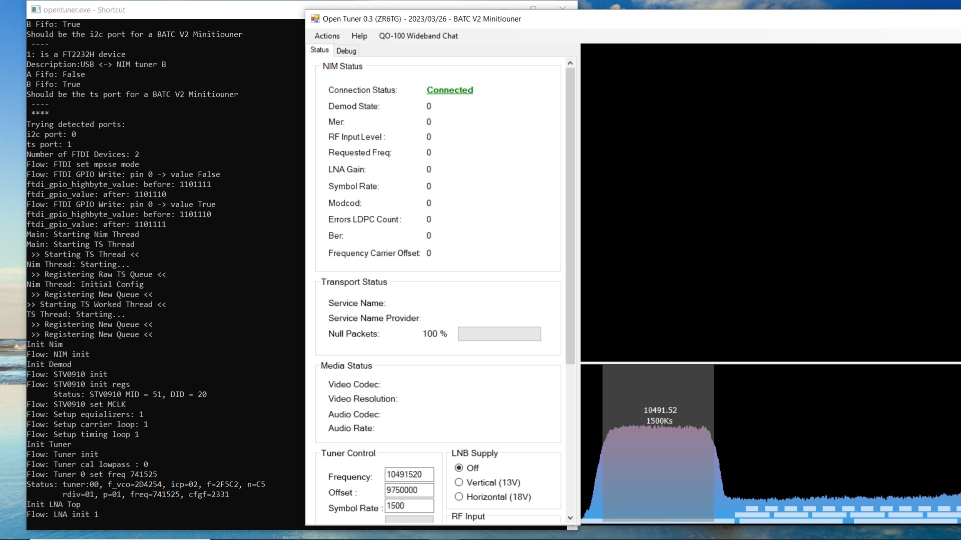

Help required
I have been trying for some time to get Open Tuner 0.1 working without success.
My tuner is a Minitioner V2 using a Serit tuner. This tuner works OK with Minitioune s/w and also with the s/w in the Portsdown 4
I have installed the latest version of Open Tuner but when I try run it the tuner appears to be detected but the setup does not complete.
The QO100 display is OK and also the chat but no signal received.
I have replaced the FT2232H module but still no signals received.
Arthur G4CPE

Hi Arthur
Suggestions - LNB LO, LNB socket in the Minitiouner, LNB supply? I assume you are using 64 bit Windows.

Post by G8GKQ » Mon Mar 27, 2023 5:19 pm
Arthur
Do you have one of the early tuners without an LNA? Looks like the same problem as we had with Ryde and those tuners.
Arthur
I think I have one of those in my Limenet Micro. I could test.

arthur21 wrote:
Mon Mar 27, 2023 4:35 pm
Help required
Arthur G4CPE
Can you show the rest of the log in the console? its ending right before the LNA init section.
Arthur
Interesting. I have another ham who contacted me, and it fails on the lna section with the id's not returning properly. I wonder if this is maybe related? I thought it was maybe a hardware issue, but since you mentioned it, maybe I'm not handling it properly.
