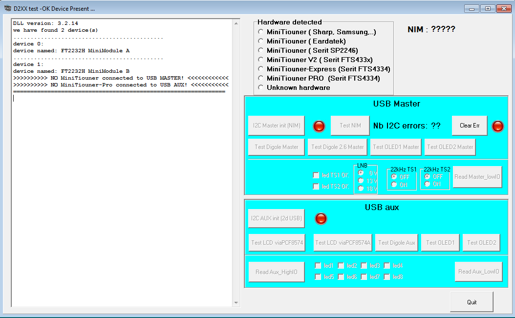

Running TestMyMinitiouner gives: file
Clicking I2C Master init (NIM) and clicking Test NIM do nothing - greyed out.
Mike.

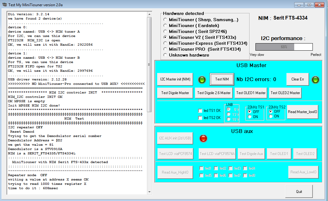

I have attached a snapshot from my TestMyMiniTiouner_V2_0a..
See how the difference in the device names found in my snapshot, attached.
On on the BATC wiki page, there's a link to the instructions for instaling the FTProg module programming software and the template XML file to apply, once you have the FTProg software installed.
