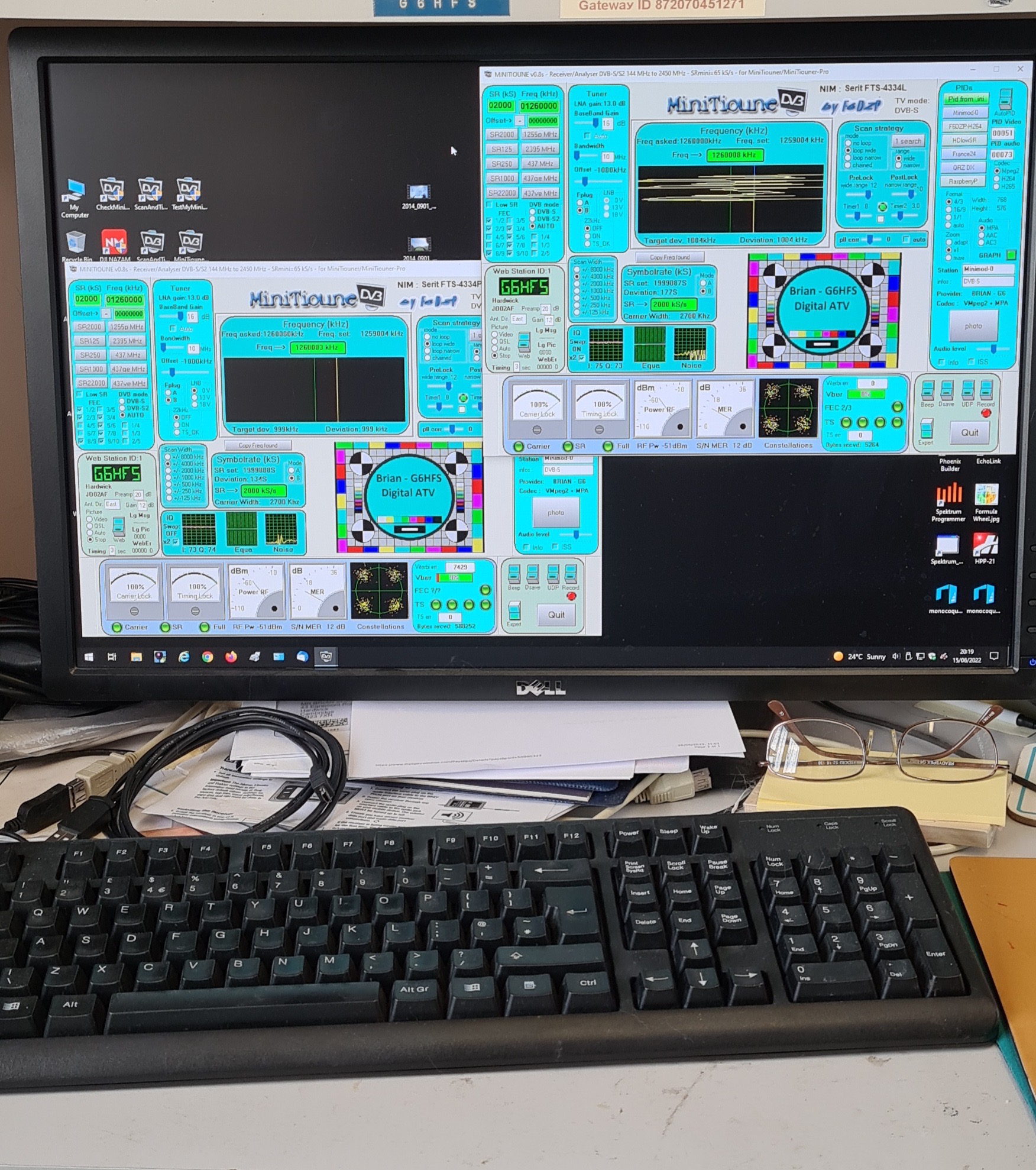

Any one else used a MiniTiouner and MiniTiouner Pro on one PC, as it seems to work ok but now need dual screen or higher res to fit both windows on screen.

Post by M0SKM » Wed Jun 15, 2022 9:12 pm
Hi Brian,
Yes two Minitiouners work fine but I don't use the Pro. There is a conflict If I try to start two instances of Minitioune simultaneously.
