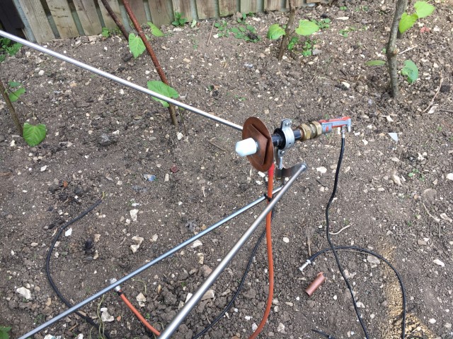

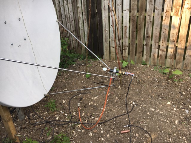

Along with Graham and Tim, I purchased a set of longer arms and LNB holder from Rimants.
These arrived today, with super fast delivery, and were superbly made in stainless steel. I naturally abandoned everything else and spent most of the day on it but I finally managed to find the magic 1 dB extra! Plus I now have room for an N type Tx connector which I need after I burnt out the SMA patch lead!
I went back to basics and based on the dimensions diagram on the forum used the string method to find the focus point – I then set the bottom strut to the right length to put the LNB further away than it and then set the 2 sides arms to that length - I could then slide the LNB forward in it's mount to the correct position. I also marked the focus point on the dish with black marker and viewed through the 22mm pipe to ensure the LNB would be pointing at it.
Overall, very impressed with the quality of the parts and speedy service from Rimants.

Hi Noel,
looks good - hopefully I'll get similar results to yours.
Even with my non optimum feed point I managed 500K S thru es'hail today (with just 25 watts) and choppy audio went away.
Out of interest what lengths did you set the rods to ?
Regards Tim

Thanks Noel for this feedback!
Let me suggest one small test to make sure your LNB is properly located....
We all know that CM antenna has 22.6* offset angle. You also can find out exact elevation of the satellite your antenna pointed at. For example, if the elevation of the satellite 22.6* than the "face" of the dish should be exactly vertical. If dish is leaning forward or backwards than there is need to adust height of the LNB up or down, your LNB-holder has this possibility. To do this test you have to use digital inclinometer.
G4WIM wrote:
Tue Apr 30, 2019 7:37 pm
Could you provide some links on how to find the focus point etc ?
Tim, look couple of posts back where I've presented collage with all needed information.
