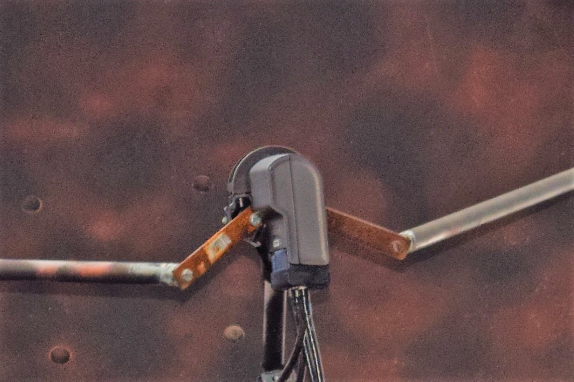

satdxer
Posts: 20
Joined: Sat Jan 26, 2019 6:10 pm
Re: Channel Master 1.2m Dish
Post by satdxer » Wed Apr 24, 2019 4:55 pm
make some longer support arms.
Hi to be honest there is no reason to make longer arms and no reason to over complicate a very simple modification, its as simple as this.
All my reports here are with the above setup 1.2 channel master dish.
Yes, it is quite simple and well camouflaged (little bit rusted holder though :twisted: )but I do not think this solution can provide best performance of the system. Seems that LNB is located too close to the surface of the dish, so LNB's phase center could not be co-located with antenna's focal point. Reception is, of course, possible, but, again it will never be best as it could be.
P.S. looked in your link but did not find your name and any pictures of your dish. But, I am pretty sure, if you were placing LNB in proper position you would certainly have even more astonishing reception results whatever good/bad they are right now. :D
