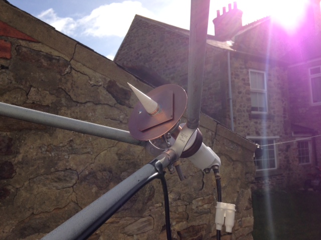

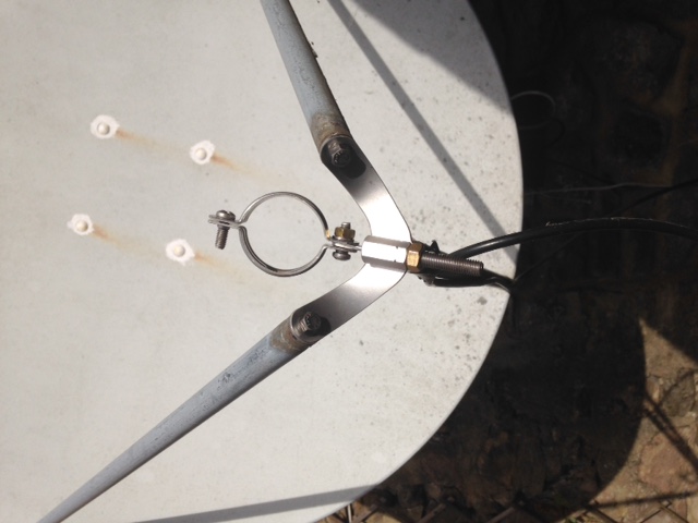

Tim I get a MER9 occasional 10 on my Channel Master with Mikes duel feed and Bob Platts dielectric design (cq-tv187) combo.
Also running with a modified LNB mount to get the feed more in the focus as it fowls the arms with the standard plastic LNB holder and is too far forward.
For me this had the edge over a red rocket dielectric. Others have reported different results with machined dielectric so may be down to material used.

That LNB holder looks like one of Rimants designs?

That's the MJW dual band patch feed described in CQ-TV 263 which "everyone", well 90% of people, are using.
Lot's of people have built them and they perform incredibly well with no need for any filtering to run duplex - apparantly someone in Germany has made over 300 parts and sold out!
But very interested in Terry's LNB mount - have to try that on mine to see if it makes any improvement.
[edit]
Terry, can you confirm yours is a 1.2mt CM dish - if so 9 - 10 dB MER is very good. If that is the case do you think it is down to the revised LNB mount? I did find them on a finished ebay listing but quite expensive ao want to make sure it's worth it before making further enquiries.

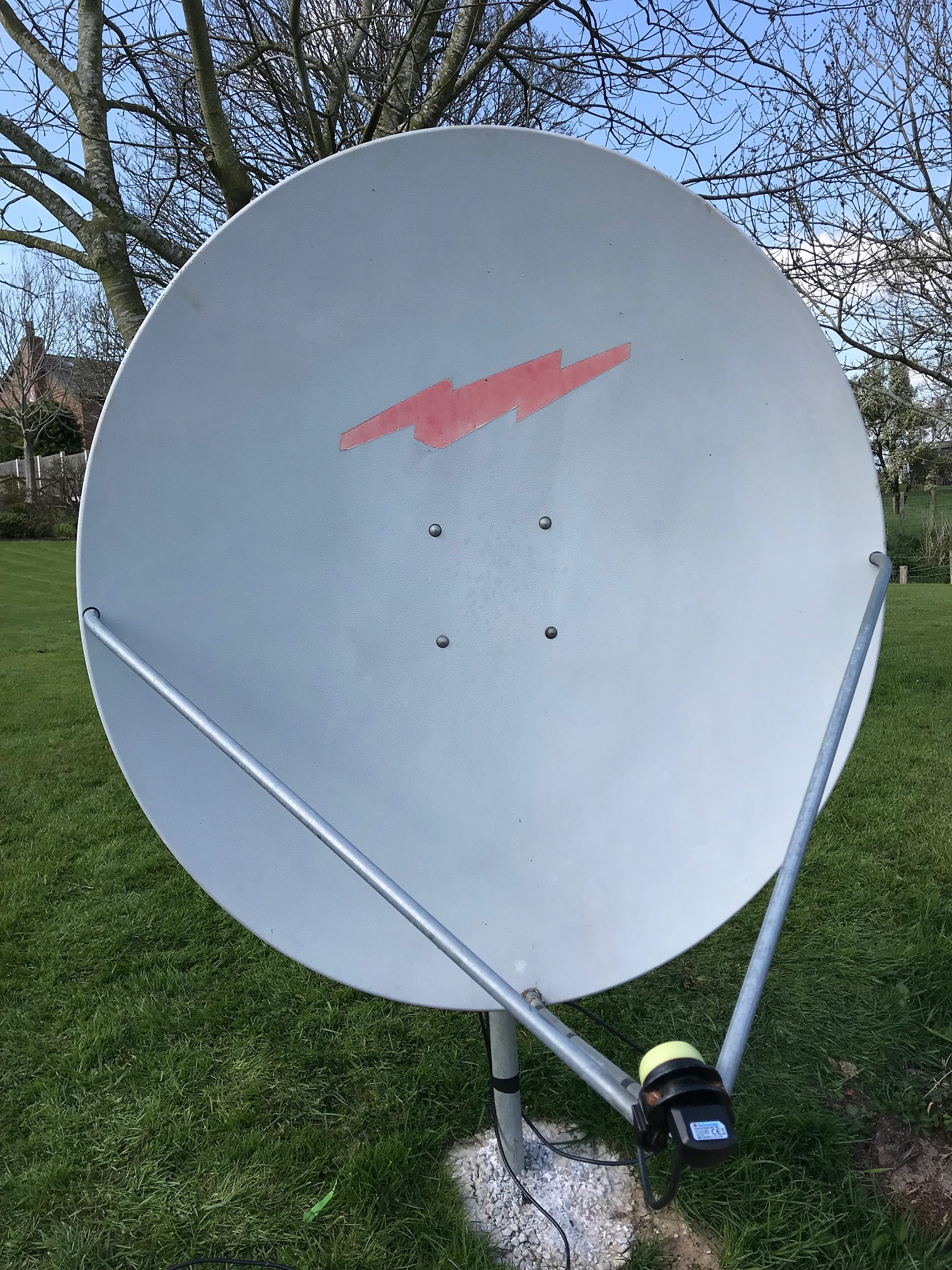

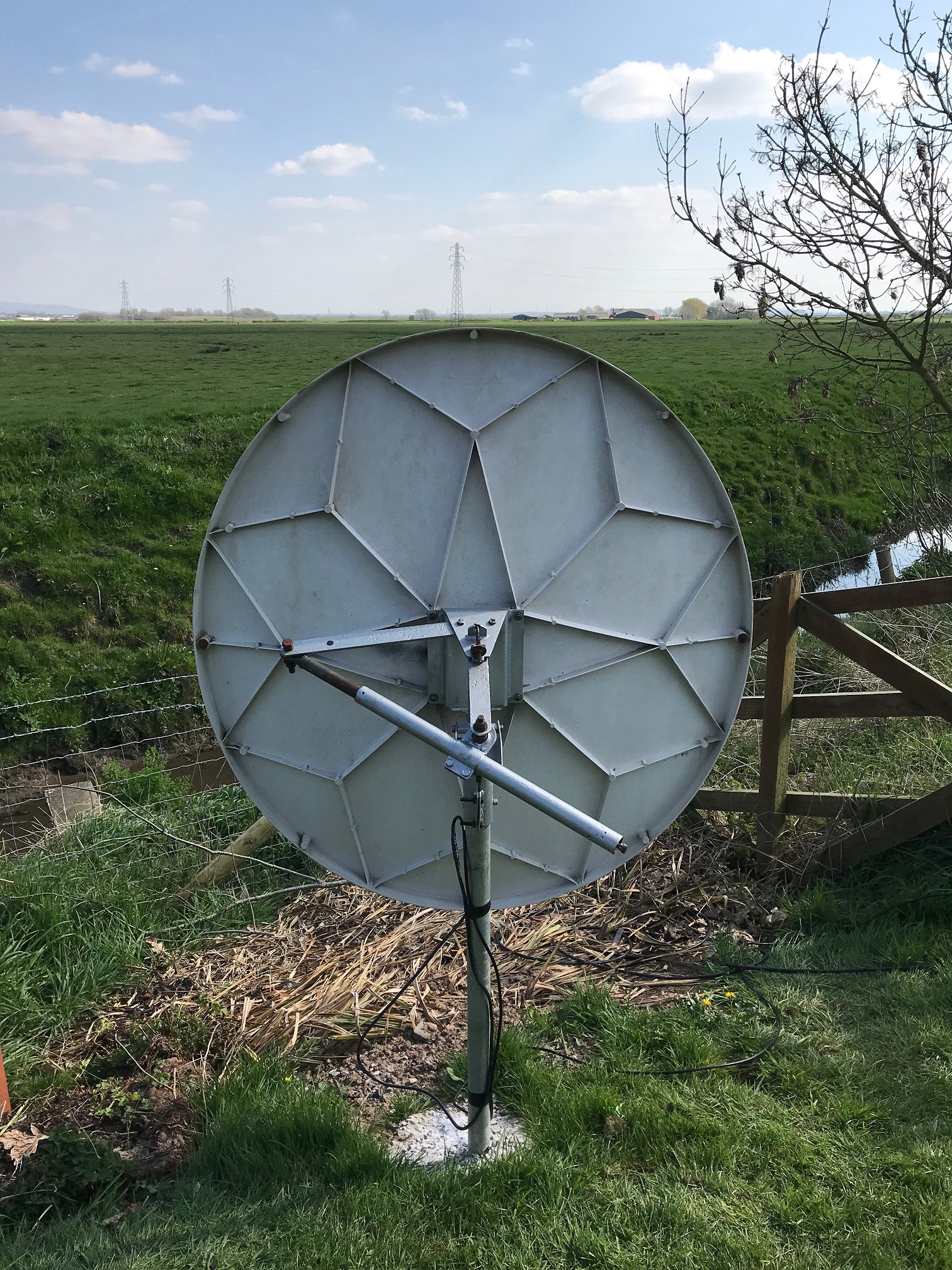

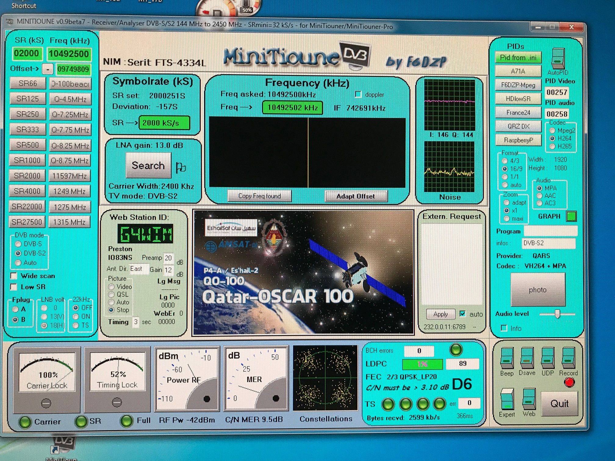

got the dish installed - nobody told me how sharp a 1.2M dish is at 10GHz. Luckily I could turn the polar mount lead screw manually to get it more or less spot. Beacon at MER 9.5dB and D6 - about 3.5dB better than my 70x80cm dish.
I wish I'd put a T bar through the mounting post when I set it in concrete - 3 feet in the ground and 3 feet out surrounds by a lot of concrete, hopefully it won't act like a wind vane ! The pole is 50mm thick walled aluminium and seems quite sold.
Charles - thanks for the link to the mount, I'll order one in readiness for when I've made a dual band feed. Edit, just seen the price !!!! Me thinks I might try and fabricate one myself .....
Here are a few pictures of the dish - not much between me and the bird !
