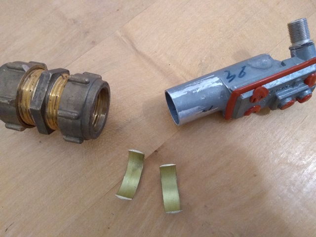

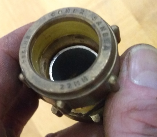

Progress on two projects today, one of them DATV. Using a new Octagon OSL SO I opened the case (tabbed, two down each side) and then carefully filed off the two die-cast tabs just behind the horn. Then I hacksawed off the concentric horn unit and cleaned up the edge.
This is a very loose fit in a 22mm compression coupler, in fact it passes through the stop-ring in the centre of the coupling. This is helpful as its not a bad fit in there. To make the 22mm olive grip the LNB it needed sectioning and about 4-5 mm removing equally (2.5 each) from the two halves. With some careful assembly the whole assembly can then be tightened up and securely grips the LNB outer body.
Pictures show the outcome.

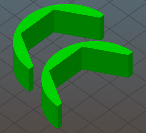

Post by radiogareth » Mon Feb 11, 2019 6:17 pm
That was fun :-)
30 mins to print.
