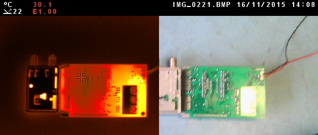

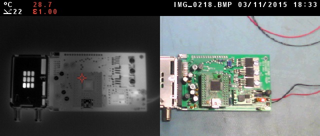

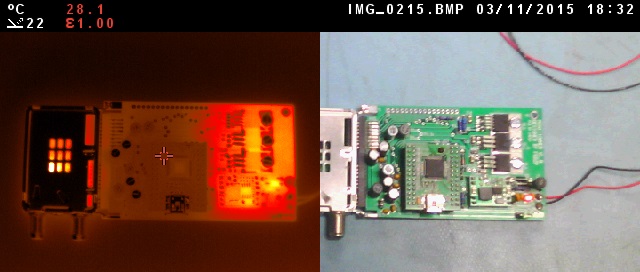

Two thermal images of a working MiniTiouner
Posts: 1535
Re: Build your own USB tuner- will work with Tutioune
Post by G4EWJ » Thu Nov 05, 2015 4:53 pm
Fascinating. The regulator bolts seem comparatively cool. Can you do the underside?

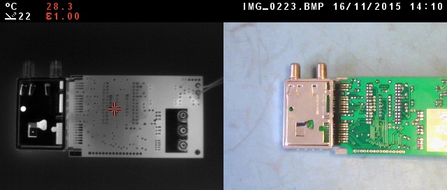

G0ATW
Posts: 20
Joined: Sun Feb 24, 2008 11:10 pm
Post by G0ATW » Fri Nov 20, 2015 7:46 pm
Sorry for the delay Brian.
This is the underside of the board, note the screws washers and nuts all had heat sink compound applied.
Cheers.
John G0ATW

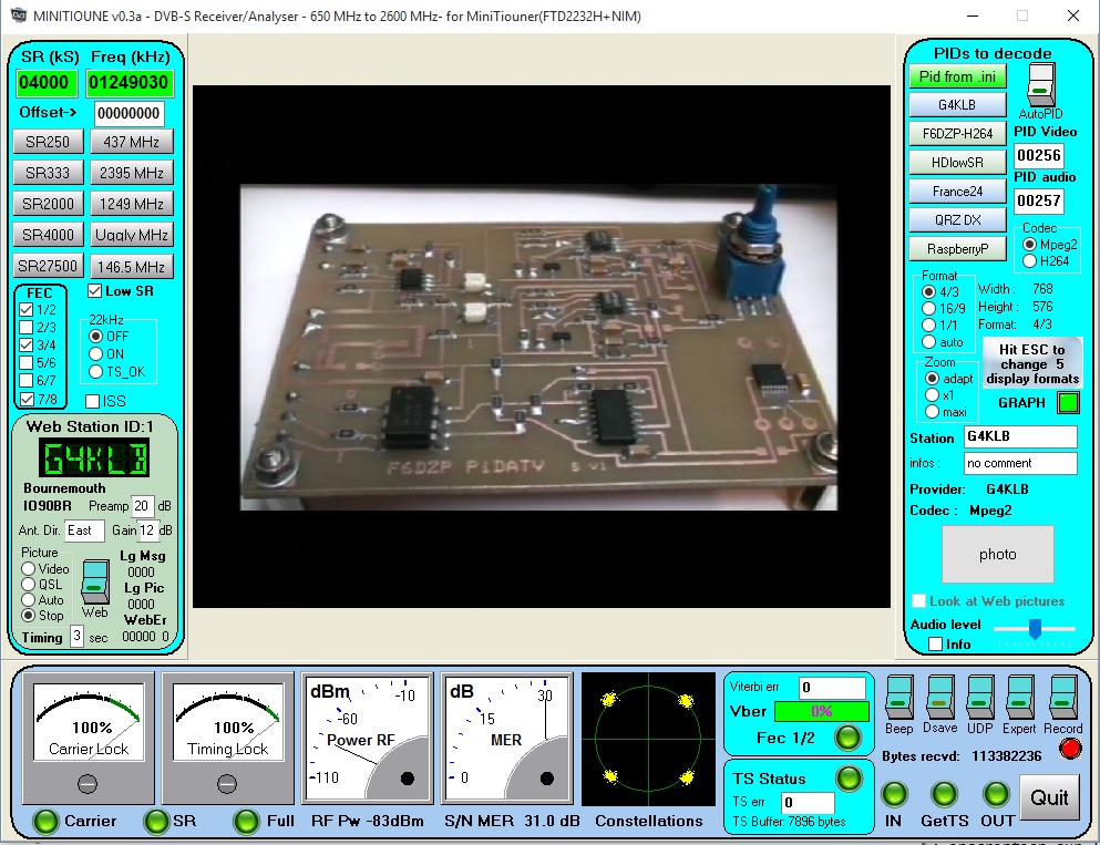

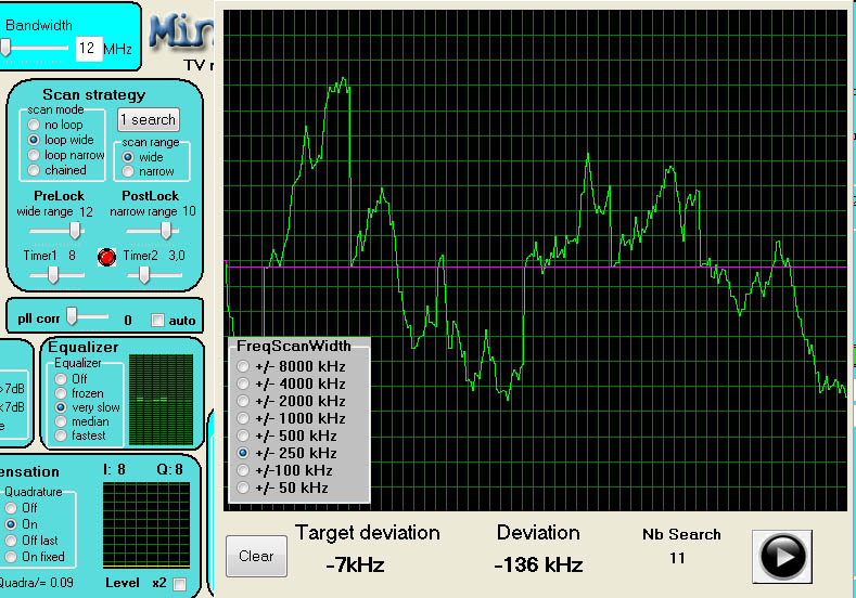

a new version of Minitioune is available.
improvements:
- TS buffer size is adjustable. New value used now gives only 1/10th sec of latency.
- HamTV implementation is completely done. Minitioune can be used for receiving ISS DATV signal.
- all buttons can be preset to a value when Minitioune start
- Derotator scanning can be observed using a new window.
Gestion du scan_.jpg (208.86 KiB) Viewed 11293 times
You can download this new version here:
http://www.vivadatv.org/viewtopic.php?f=60&t=441
Jean-Pierre F6DZP
