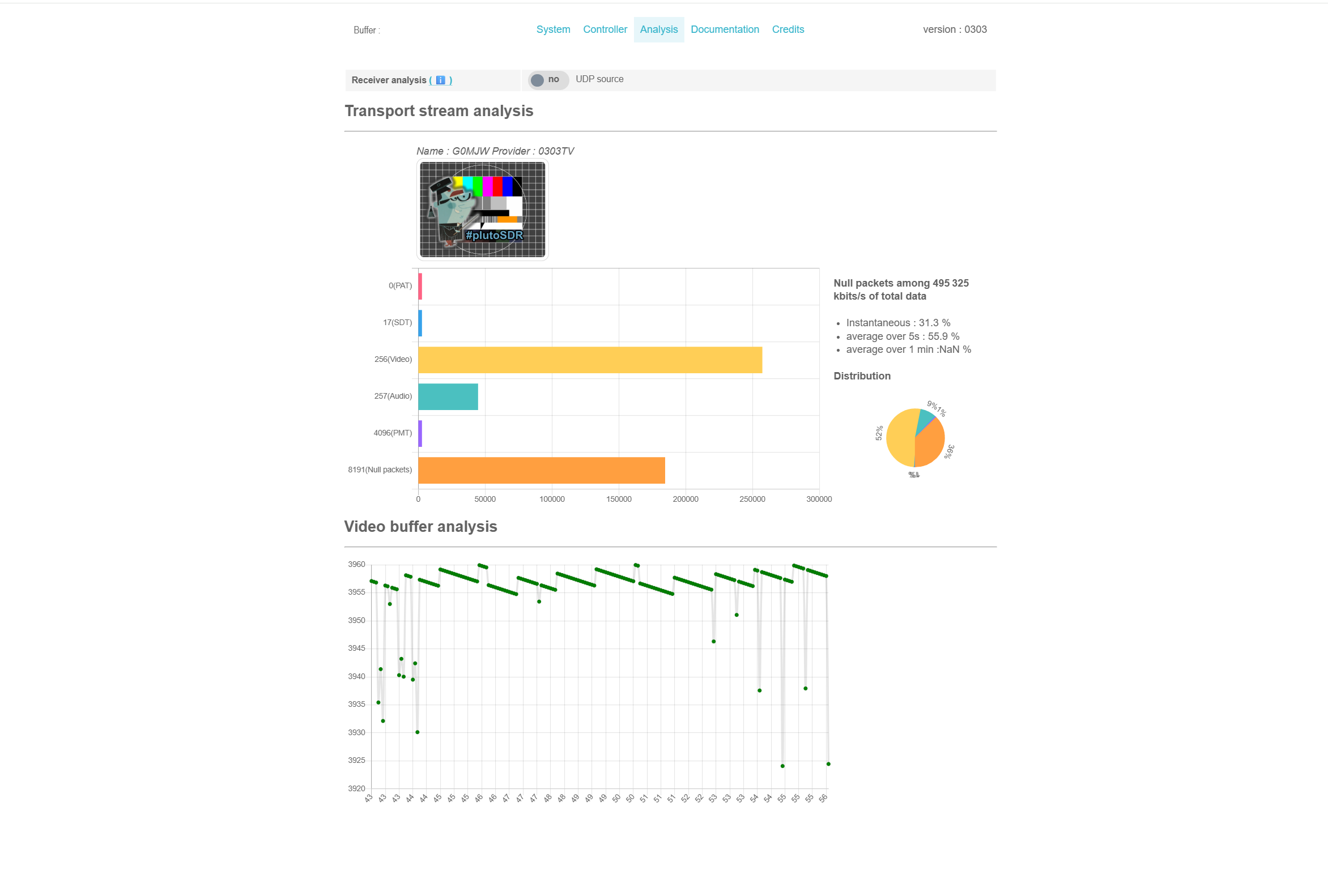

But you didn't answer my question so I am not sure how we can help more. I asked if you were sure there was no output. Not if it works with a different piece of hardware that uses a very different means of generating the RF. I think maybe there is RF but at a very low level. You can tell if the Pluto is getting the transport stream from the analysis tab. You showed that earlier, so I assume that is working.
Screenshot 2025-10-06 232632.png (188.43 KiB) Viewed 18 times
If that is there, the video is getting to the Pluto. As long as the Pluto PTT is active, there will be RF coming out.
