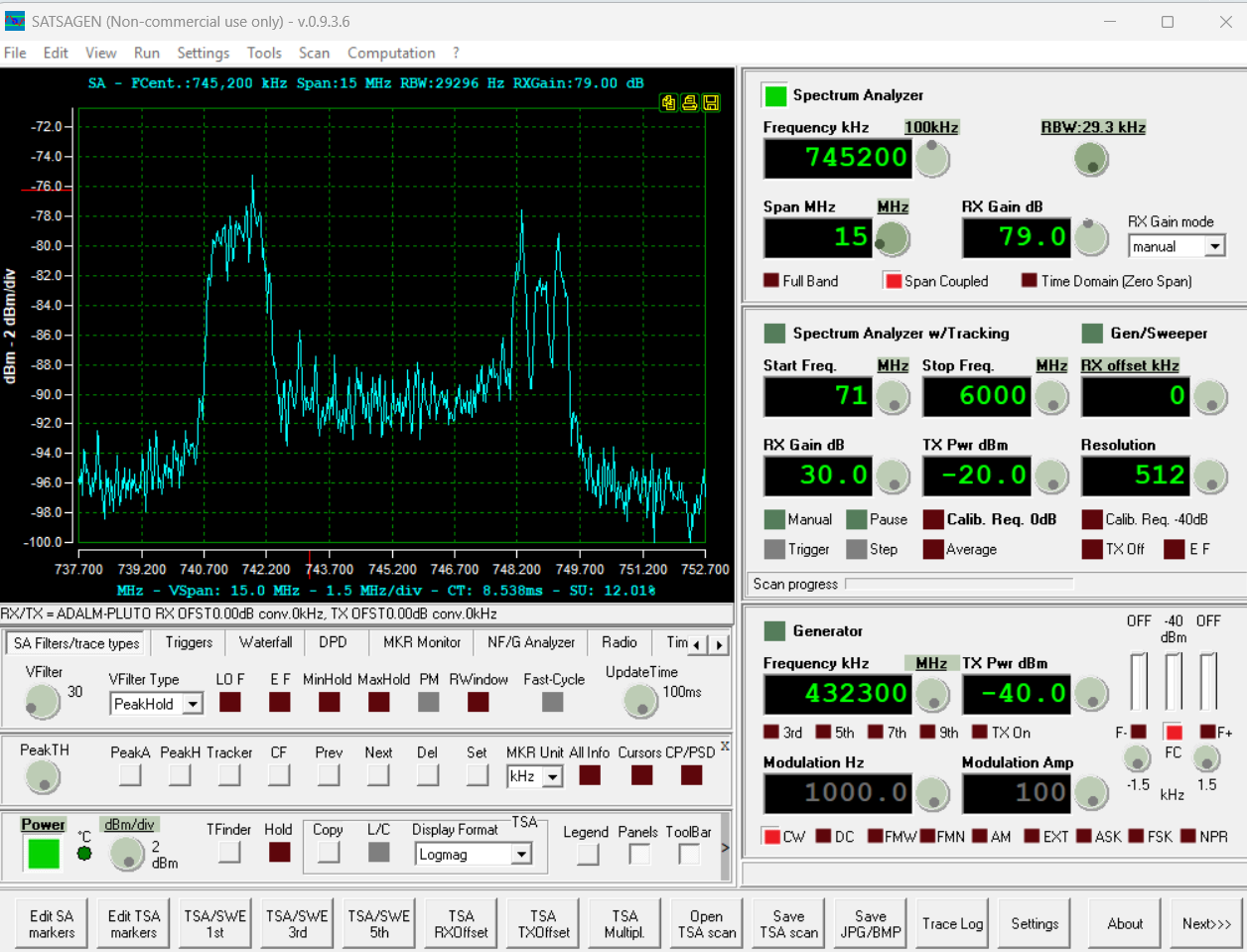

Finally, have you come across satagen? https://www.albfer.com/en/ download at https://www.albfer.com/en/satsagen-download-page/ - this turns the Pluto into some pretty capable test gear and a good way to figure out if it is working or not. If that doesn't work, perhaps there is something wrong with the Pluto or its power supply.
Edit - here is Satsagan acting as a spectrum analyser on my QO100 IF
Screenshot 2025-10-04 100757.png (329.8 KiB) Viewed 84 times
