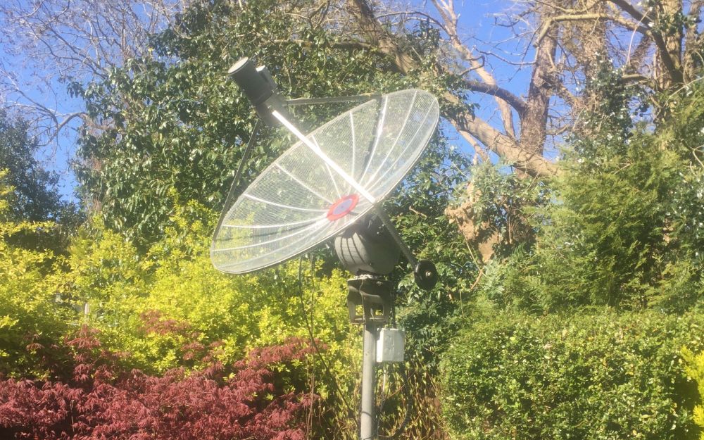

This is a photo of the equipment I used. The circular piece of cardboard in the center was there temporarily, to check how well it tracked the Sun.
Good luck with your project.

Well, I was thinking of a more detailed image, but from a distance it's not ideal.
Anyway, I saw you used a regular pole to install the panoramic head; they usually need to be mounted on a tripod.
How did you mount it on the pole?!
Sorry for the questions, but I wanted to know if your project is feasible for me.

The PTZ camera mount is mounted on the pole using items from my junk box. It's held by 2 old aerial brackets and an Alluminium plate. Additionally for added strength there is a 10mm bolt through the pole to hold it all together. It doesn't look pretty but does the job.
If you have basic mechanical engineering skills and the resources, anything is possible.
