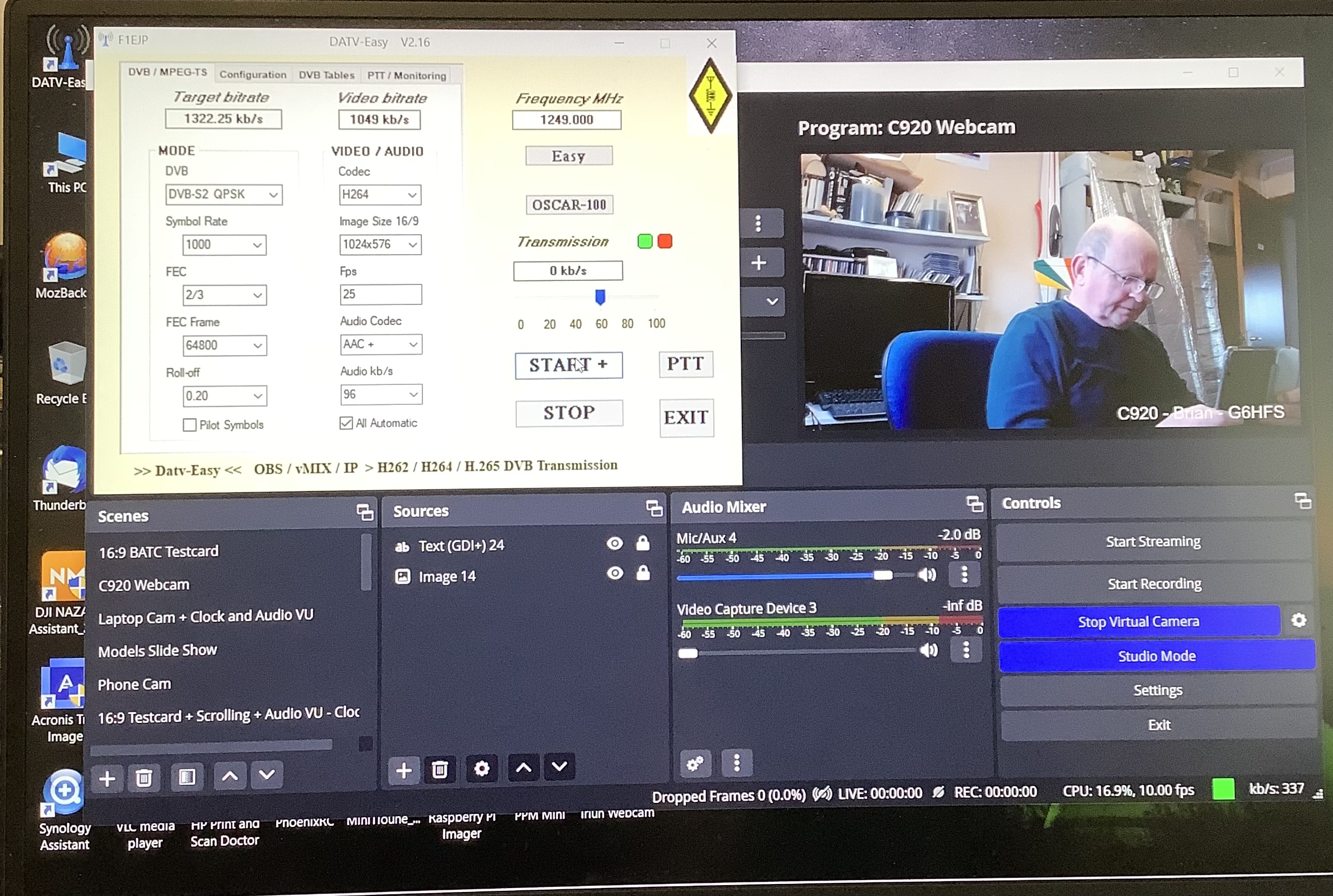

Thanks for the reply, getting some where now but no rf from pluto the green transmissions are on, with a bitrate so I must be still doing something incorrect any more suggestions.

Can you show us all the configuration tabs? What firmware is in the Pluto, is it matched etc etc. I don't see any transport stream being generated.

The picture was just taken as I stopped the stream, it seems the portsdown 4 dirty does not work with datv easy, have spoken with Martin G8KOE today.
So either a second Adalm Pluto or change firmware.
