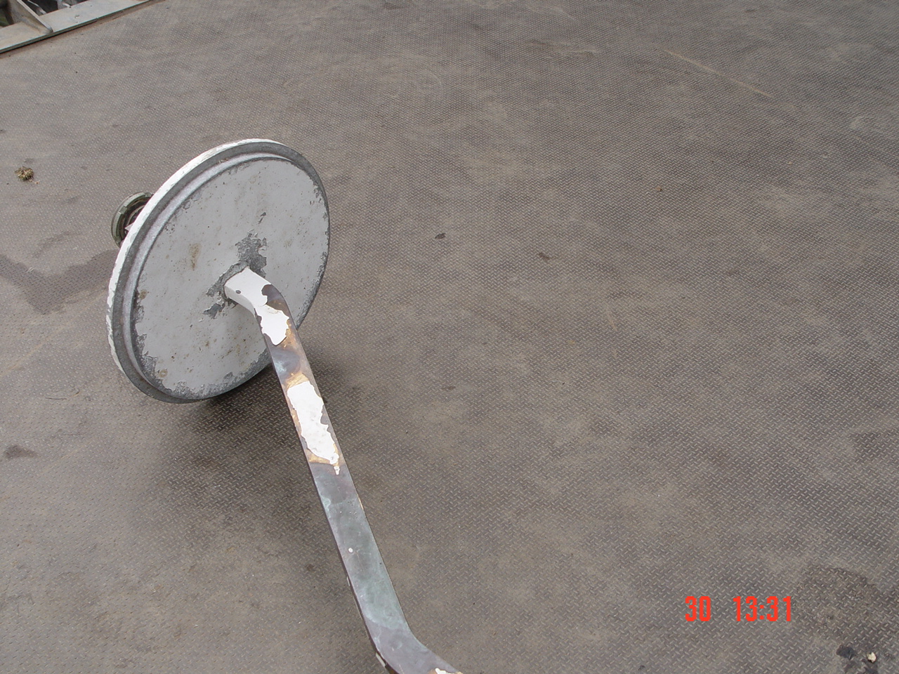

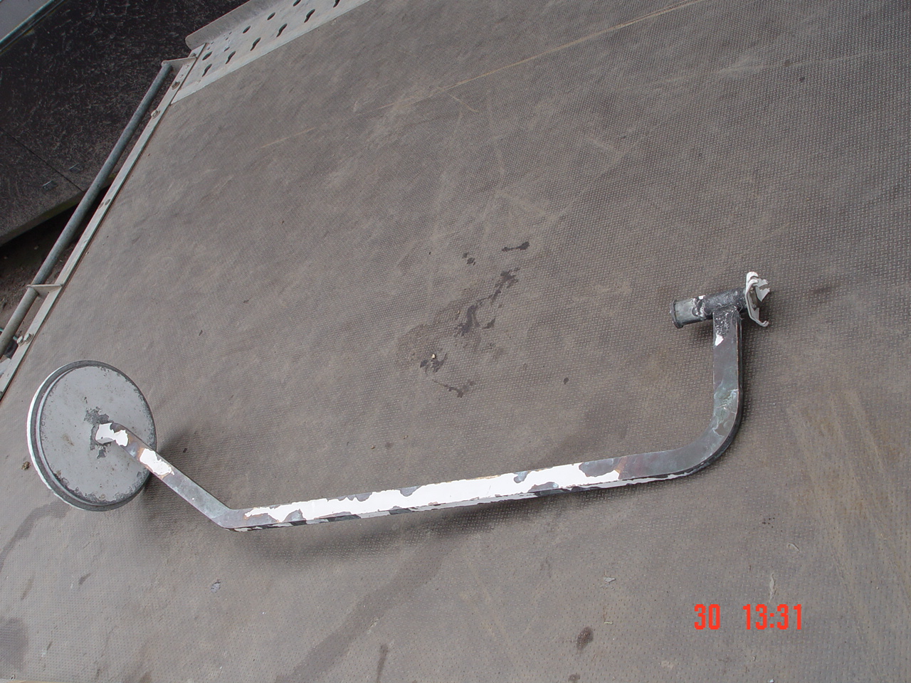

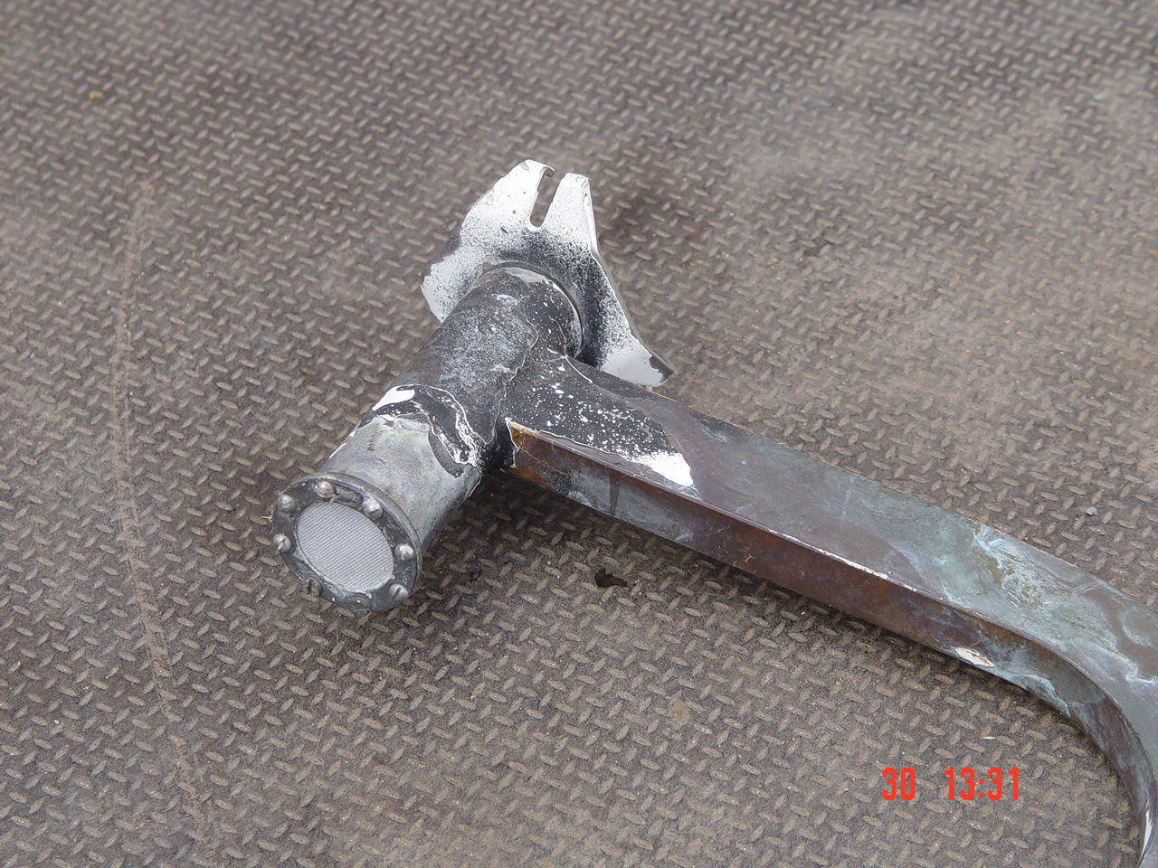

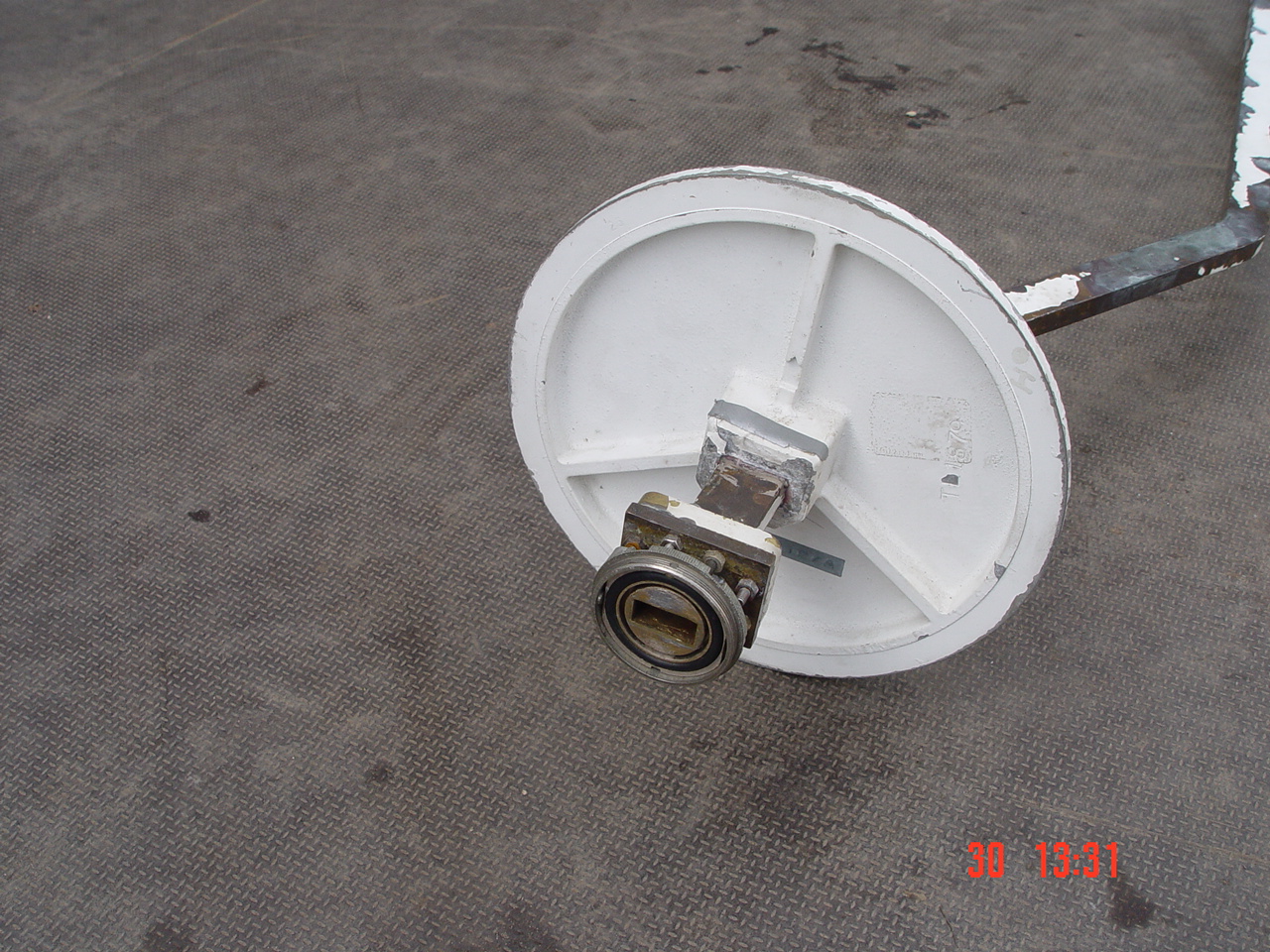

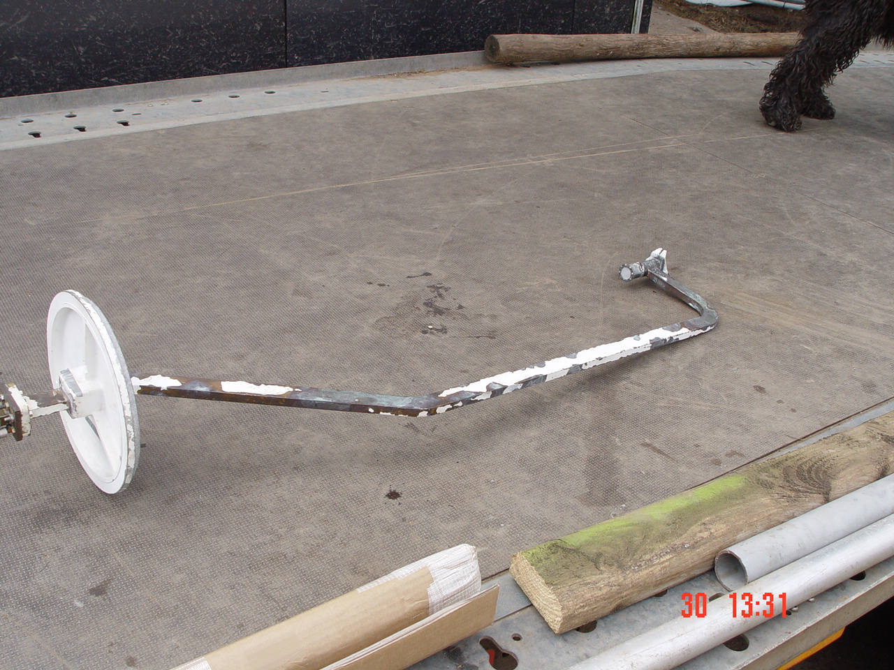

OK, thanks Mike. The dish came with an original Andrew feed, like a shepherd's crook, photos attached. it is undamaged and very sturdy. What i have done is accurately measured from the cast alloy plate the crook's waveguide goes through to the meshed feed entry. I have duplicated this distance of about 3 feet from memory, to place the mouth of the POTY tube the same distance. Accuracy was to within plus or minus a couple of mm. Is my simplistic approach OK? I have built in a goodly amount of vernier adjustment both ways, just in case. I am not sure what frequency the shepherd's crook affair was designed for, but I am assuming the feed point is the feed point whatever the frequency?
I also made the POTY holder do two things, one is obviously to hold the POTY and LNB, but also to allow me to slide the POTY out and insert a 22mm dead straight tube into the holder, that I then use to align the POTY tube holder concentric with a 23mm hole in my replacement for the shepherd's crook dish centre plate.
