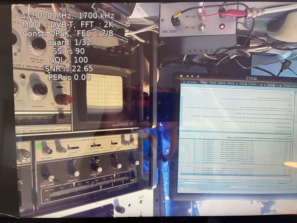

Re: Compatiblity DVB-T2 1.7MHz
And the display. The camera image is upside down, but that is a teaser for something else that I am working on for the Portsdown....
- DVB-T.jpg (225.95 KiB) Viewed 19718 times

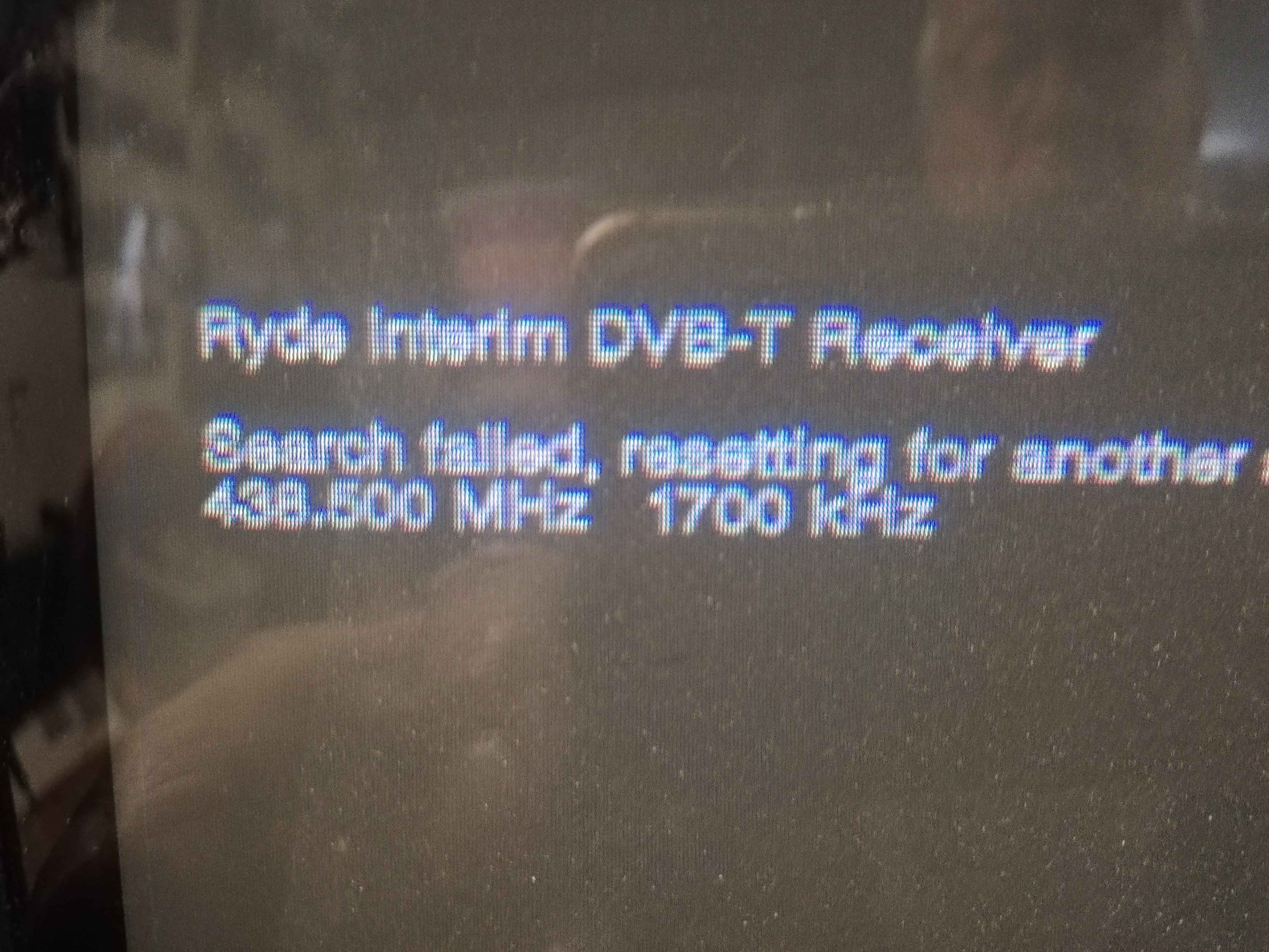

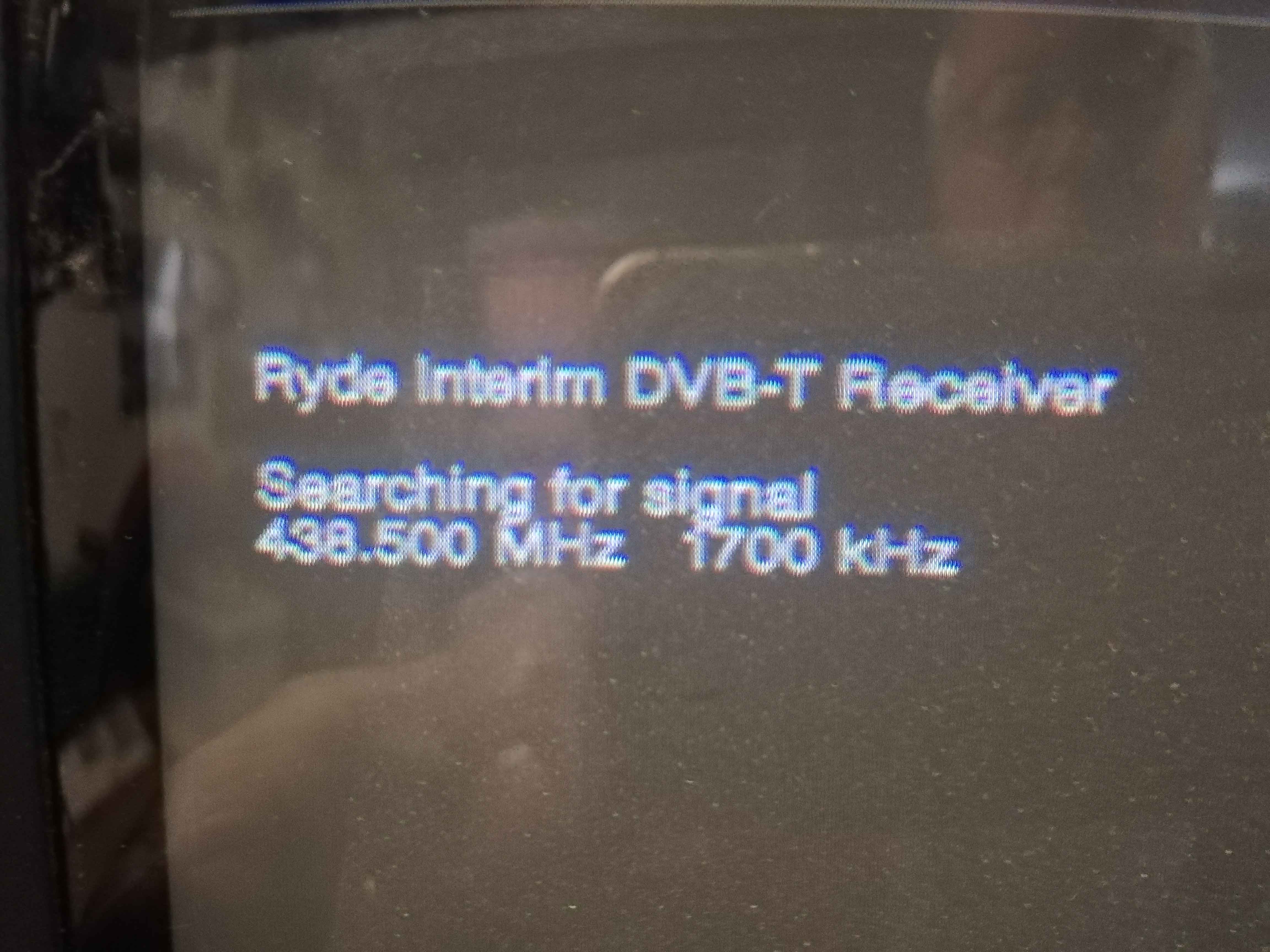

Dave,
Please find two photos of Knucker searching "438500 KHz at 1.7 MHz BW"
73's Patrice
73's Patrice
- Knucker 1.7MHz BW
- IMG 2.jpg (837.16 KiB) Viewed 19406 times
- Knucker 1.7MHz BW
- IMG 1.jpg (527.97 KiB) Viewed 19406 times
