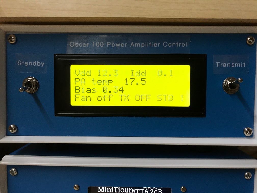

Re: 250W Linear PA using Ampleon BLC2425M9LS250 mosfet
Here's a picture of my PA controller.
If a PCB were to be created the same board could be used at both ends but populated as required.
It matches the Minitiouner Pro.

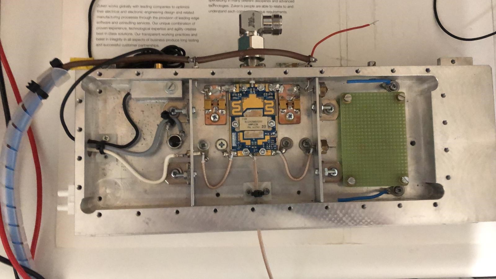

I've purchased ampleon 250w module and mounted in a Siemens case. It works fine, I'm
waiting a dish illuminator to proceed with Datv tests.
Got some trouble with internal bias compensation.
See attached picture.
Bye!
This is really a good idea. On one hand to operate the power amplifier remotely and to monitor its function, temperature ... (!).
On the other hand to use the same blue housing as for the minitiouner. An optimal team!
Half of it I am using thus far.
Although I have hardly any special experience with the design for a pcb. Nevertheless, I would like to see the schematics and the code. (Programming is not a problem)
Once again thanks for sharing your idea.
Walter
