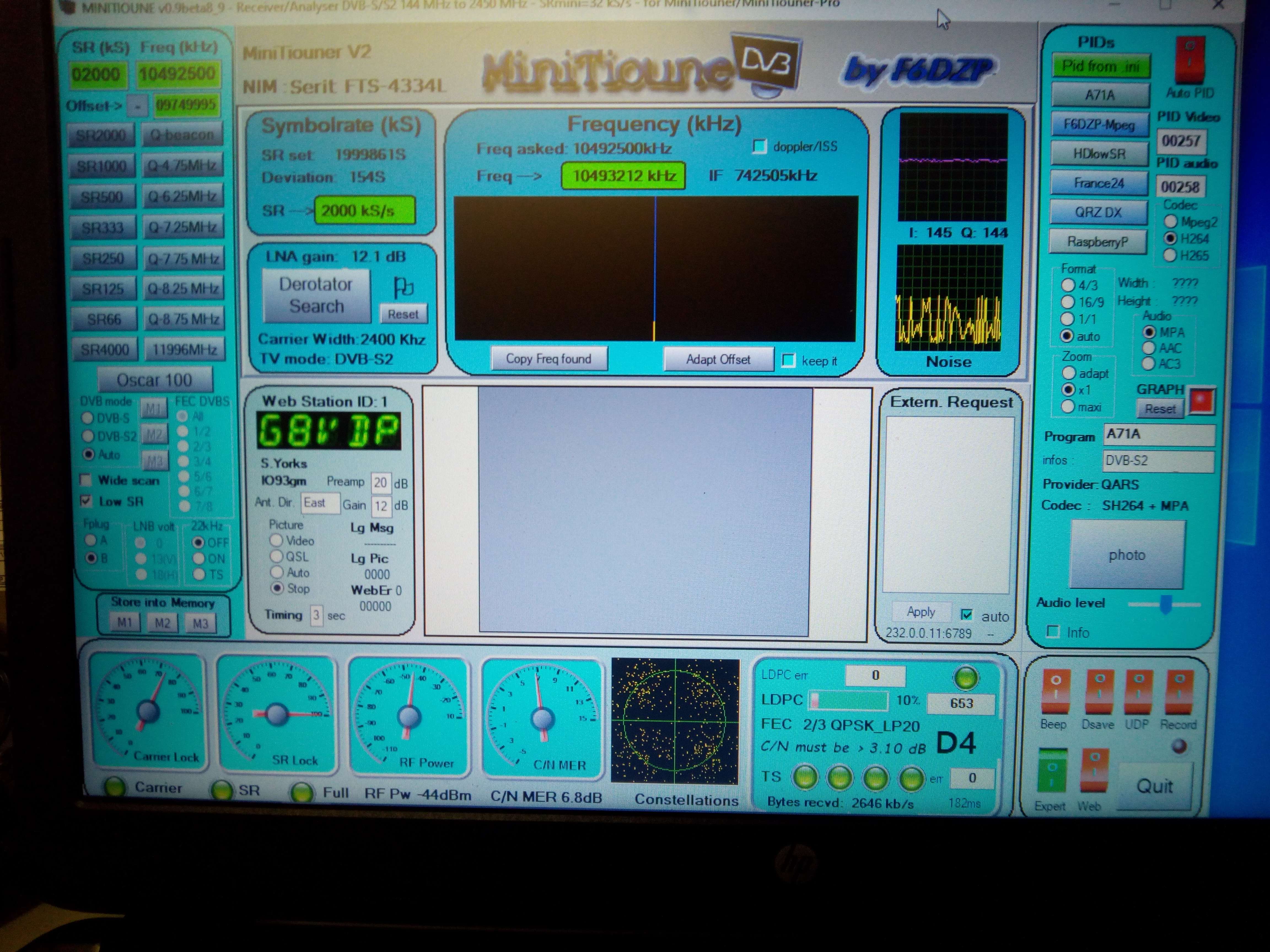

Hi, I fully understand what you are saying. with respect, I wonder if you are understanding what im saying.
[/quote]
With respect no, because you did not explain it very clearly the first time and I am not sure I want to help any more, but last try - re-program the FTDI module.
Everything is working except for the data getting to the PC. I take it there is no Transposrt stream received, your photo does not show that part of the screen If there is a TS, dump it to a file and look at it, maybe some bits are always 0 or 1. If you look at the schematic you can see the data lines and control lines. One of these may not be working. Look at them with a scope perhaps? Dry joint? Who knows. Something could have failed, or got zapped.

Ignore now I see the screen image But is there any actual data being received ? That would tell us a lot. If there is it is probably corrupted and there is a problem with one of the date lines. if no data then it could be the FTDI module.
Don't worry about LDPC errors - that's just how hard the error correction is working. A screeenshot would help. Oh - you posted one as I was writing - right there is data. I think one of the data lines is not working. Perhaps re-solder the pins in case on is a bad joint? On module and on FTDI connector.
Edit - Hang on - you have got the stream data - it has the beacon callsign. You must be getting valid data! Record some, then try to play it back with windows media player or VideolanClient (VLC)

I had to edit last post because the screen image appeared - the good news is it looks like the minitiouner is fine and sending valid data. You can't display the beacon on the Portsdown reliably - the rate is too high for it. I should have remembered that.
I go back to the problem looking like software. You may not have changed anything but windows has a habit of changing things all by itself. You do not appear to have a valid .GRF file. (that red box on the right should be a green one)
Can you run the test_my_minitiouner utilits and see what it says?

Mike, I'm puzzled very much so.
You say above
"I go back to the problem looking like software. You may not have changed anything but windows has a habit of changing things all by itself"
The thing is. The photo above is of my laptop with Minitiouner.
I also posted a photo of my Portsdown and a link to a video of it receiving the beacon.
I also have another Portsdown (old style)
On all 3 systems , I was receiving the beacon using Minitiouner and they "were" producing video on screen no problems
Forgive me but I can't see it being a software issue as the laptop uses different software to the Portsdown yet the issue of no video has occurred on all 3 systems whichever I use and they all stopped showing video on the same evening within the time it took me to shut down and move the Minitiouner from one system to the next then boot up the software.
I think doing that, I've deduced that the issue is in the Minitiouner hardware. Or am I wrong again ?

I am somewhat confused as well, because throughout development of the LongMynd receive software on Portsdown, I have never succeeeded in displaying the picture from the beacon on the Portsdown. It just can't do it.
Please could you try to display another QO-100 signal that is known to be 1000KS or below and encoded in H264 (NOT H265)?
As for the Windiows PCs, you may well find that Windows Update has broken the video player. Try using UDP, either from the Portsdown or from the MiniTioune software and displaying the picture with VLC.
It is very unlikely that connecting the MiniTiouner to the Portsdown has damaged something in the tuner, as there is no direct connection. Also the fact that MiniTioune software is displaying A71A and QARS means that it must be getting the transport stream from the tuner - so the problem is in Windows.
