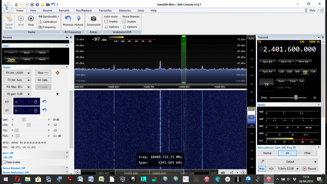

3 steps forward 2 steps back!
Well due to a coughing fit I found that the vox appears to key the Tx!!
So as the Lime I understand works duplex ..I tuned to my tx freq expecting to see a big signal appear!
Nothing appeared! I still can not click on the TX button..and I suspect I may just be seeing the Vox system working
TX Tone Tune and drive being still greyed out...although the TX square does go Yellow when Vox is keyed!
I always felt that the Minitune once mastered was worthy of a good pass at O Level
If I ever hack this it's got to be worth a PHd!Image
Screenshot (39).png (289.85 KiB) Viewed 5444 times

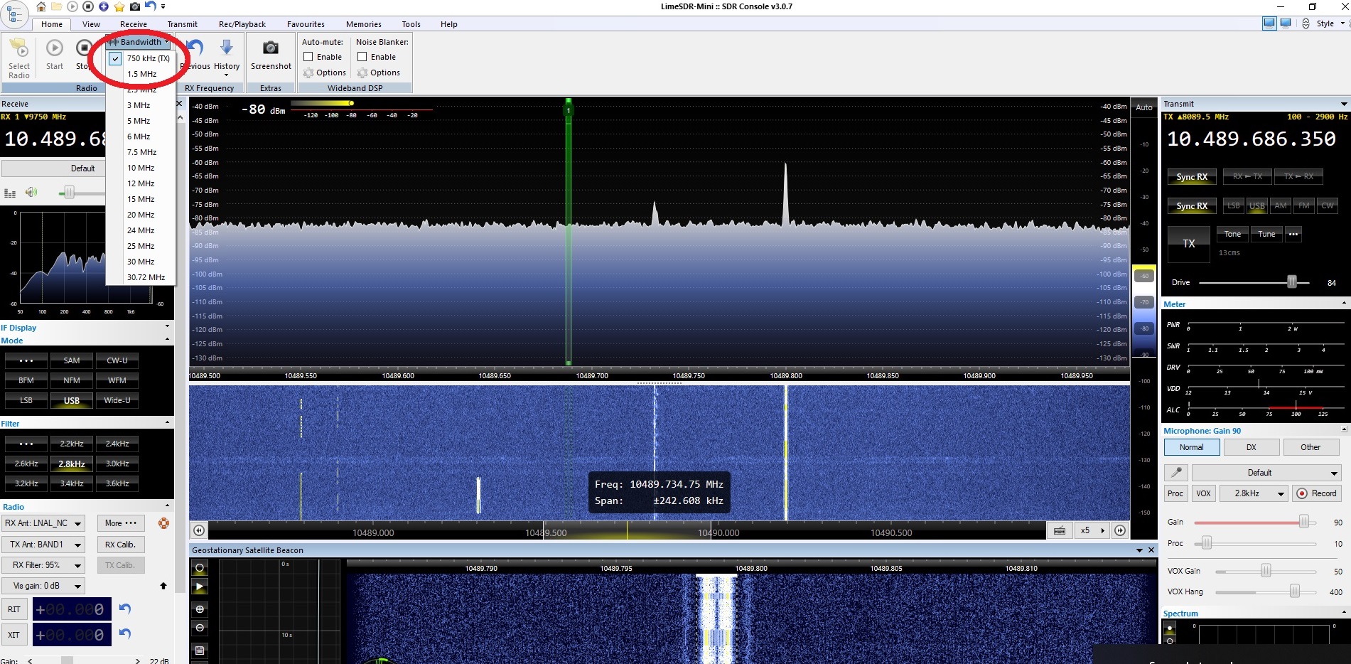

Post by G4KLB » Mon Apr 22, 2019 10:54 pm
If you have a greyed out TX box its normally because 750KHz isn't selected
