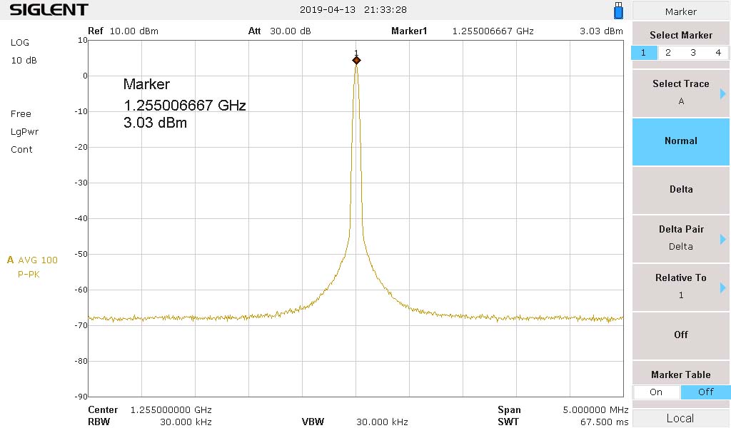

I have updated Portsdown and Lime software to latest versions and still get no modulation on H264, but I do get a carrier now whereas before there was no transmission signal at all. Attached photos show what I am getting.
Carrier.
Carrier.
MPEG2.
MPEG2.
H264.
H264.
Regards,
Nick.

When I transmit with H264 there is still no modulation, but also, when I touch the screen to stop transmitting, whilst the Tx LED does go off the Portsdown is still transmitting - the signal can be seen on the spectrum analyser.
Also, the Tx signal can vary from around -40dBm to -3dBm,
If I now switch to MPEG2 and transmit the spectrum analyser shows a modulated signal, and when I touch the screen to stop the Tx LED goes off and transmission stops OK. Same if I select carrier.
So, transmitting carrier or MPEG2 works OK. H264 is still giving problems.
Why it still transmits when the Tx LED is off is really strange.
I tried these tests at 1255MHz and 437MHz and got the same results.
I have no problems with setting different attenuations with the on board PE43703 attenuator - this seems to give the correct attenuations as set in the menu.
Regards,
Nick.
