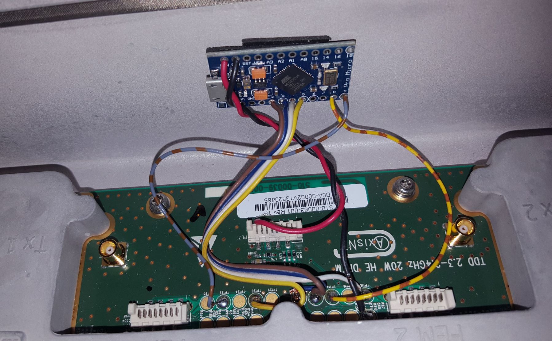

The device needs an embedded computer to set the values for the PA on every power cycle.
The OM who modifies it , is named in the auction.
Mine has got an Arduino for both PA parts.
Documentation is more or less not available..... I have not yet contacted the original supplier of the device, he is located in the UK, but merged a few years ago...

Thanks for picture of Arduino, have sent off email to Staszek, sp6gwb@netgate.com.pl
For his help...

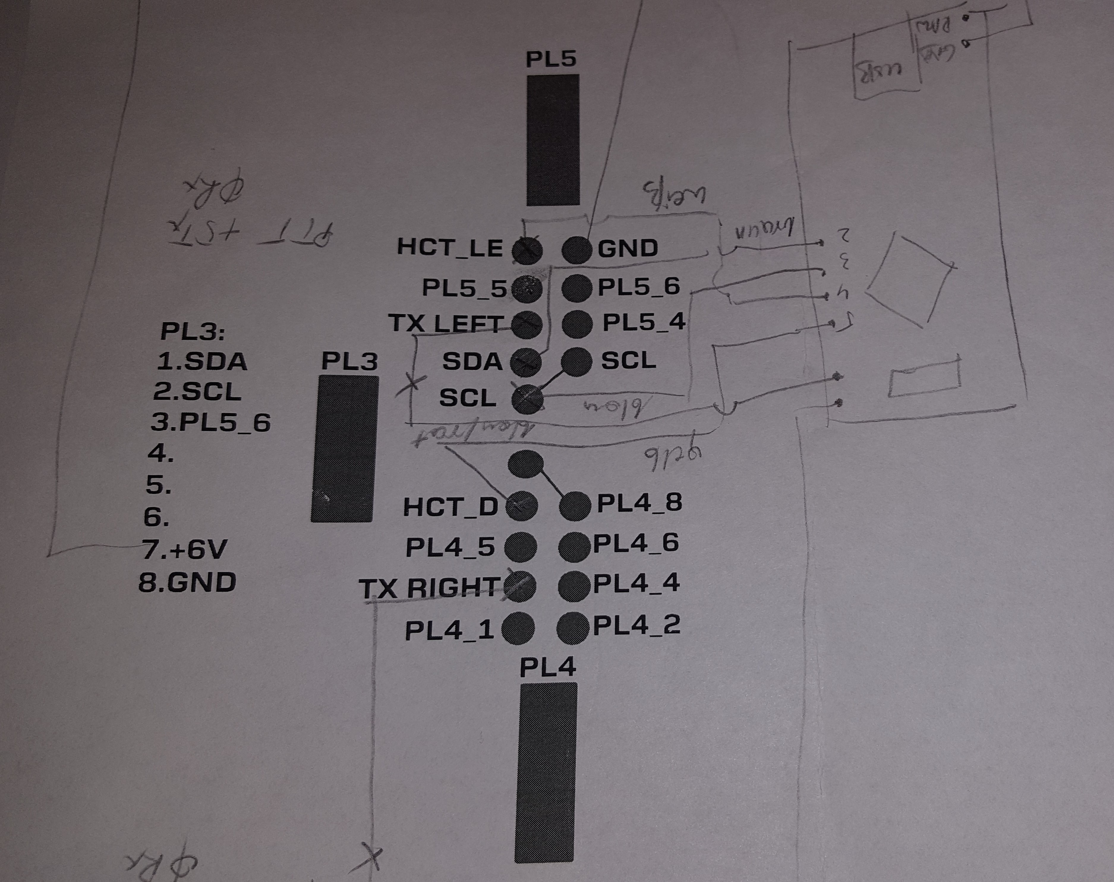

Post by DG8KD » Thu Feb 21, 2019 3:26 pm
Here some infos regarding the connections of the arduino:

Post by G8DKC » Thu Feb 21, 2019 5:23 pm
Hi Rainer,
Thank you for the pin out, apparently each PA requires individual settings on 4 transistors.
Together, the settings require 10 parameters.
So looks like some study in Digital PreDistortion (DPD) measurements etc so a big ask and long study.

Yes please. I have quite a bit of arduino experience. If someone has one if we can look at the SPI bus perhaps we can work out what needs to be done. Failing that, just wire it up as a regular PA and bypass all the digital stuff.
