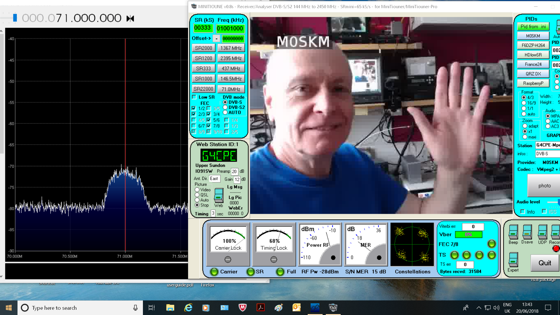

Today I received pics from Steve on 71.0MHz. Tomorrow we hope to work in the other direction.

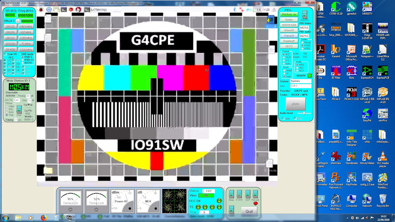

Arthur G4CPE and I have completed the two-way on 4m; there had been a problem with my receive upconverter which is now resolved. Both of us have temporary vertical antennas and the tip of mine doesn't even reach gutter height.
We are using ex commercial converters originally 1GHz in and 70MHz out; these use a 930MHz oscillator. Arthur has tweaked and moved the 1GHz filter from input to output and our 71MHz input reads 01001000 KHz in Minitioune. Input is via an amplified 70MHz SAW filter.
