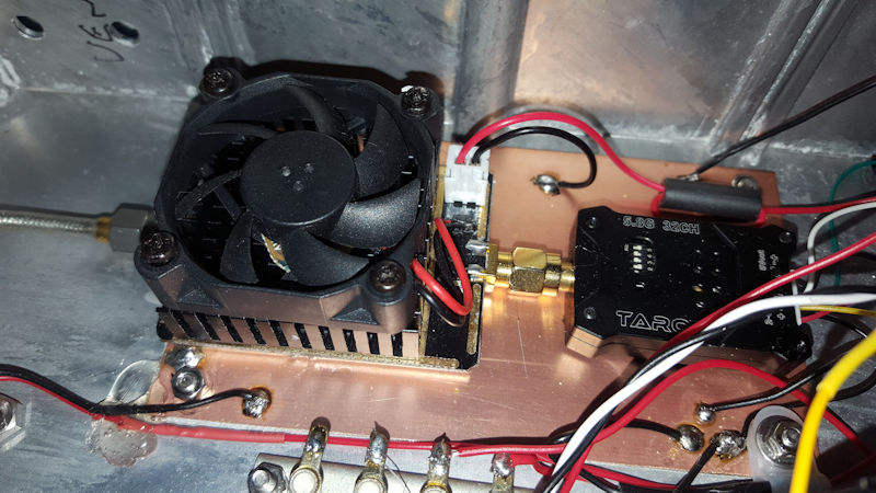

Re: ATV on 6cms - It's Cheap and Easy on 5665MHz
Hi,M0AYF wrote: ↑Tue Jun 19, 2018 1:55 pmHi,
After reading all the posts in this thread (and if I understand correctly) we have a number of possible options for TX equipment. The 600 mW units, the PA's that will "boost" the 600 mW output to around 2 Watts and more recently 1 Watt tx units.
From earlier posts and links to members web-pages it seems the 2 Watt PA units can be somewhat "fragile" if not treated with care. Are the 600mW and 1 Watt varients just as fragile?
My current thoughts are to buy a couple of the 600 mW transmitters and a pair of receivers to evaluate but as the market place keeps changing I am finding it difficult to decide on the best choices currently offered on ebay.
So I should like to ask if anyone can point me towards a current supplier of tx equipment on ebay which has been shown to be successful and also any tips on preventing the tx from expiringI understand a good heatsink and fan are a wise precaution but does anyone know how sensitive these units are to supply Voltage and static damage etc.
73,
Des (M0AYF)
This setup works for me and produces 3.9 Watts at the N connector.
Tarot TL300N screwed to double sided copper clad board; PA tack soldered to same board. Copper clad board bolted to diecast box with a dab of heatsink compound between.
Holes drilled top and bottom of diecast box to work as a chimney.
73 Steve
