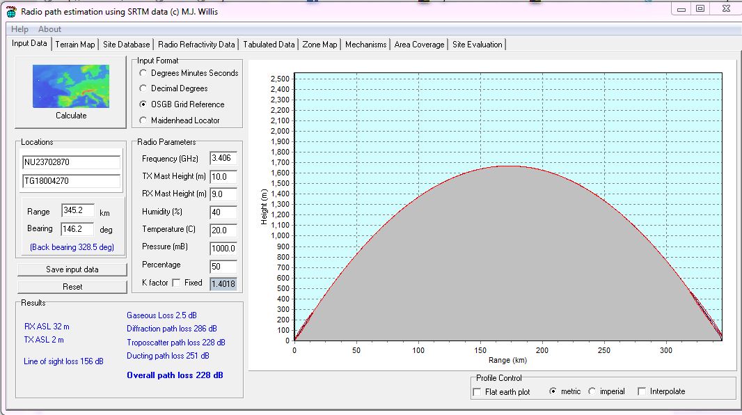

One suggestion for a future record attempt, There is a clear straight line path from West Runton our operating site, right up to the coastal village of Benthall to the South of Sunderland. a distance of 245k. The path appears to miss Flamborough head. Any thoughts from the Yorkshire group or anyone in that area as to whether or not it might be feasible?

I'm local to the Sunderland area Peter.
The only Benthall I can think of is north of Sunderland in Northumberland OS grid reference NU237287
Thats 345km. Do you have the grid reference?
Terry
G8JAN
Posts: 47
Joined: Mon Feb 25, 2008 7:12 pm
Re: Norfolk to Yorkshire - May 9th and 10th
Post by G8JAN » Sat May 12, 2018 10:37 am
Sorry Terry I think we are talking about the same place it's just south of North Sunderland at 55.03'07-65N 1.37'44-34 W 4 metres ASL at the car park distance to West Runton is 345k!
It's a long long haul but who knows with the right sea conditions? It's got to be worth a try sometime I think. What are your thoughts?
Pete G8JAN
Posts: 2742
Post by g0mjw » Sat May 12, 2018 10:58 am
G1LPS Terry wrote:
Fri May 11, 2018 7:34 pm
Terry

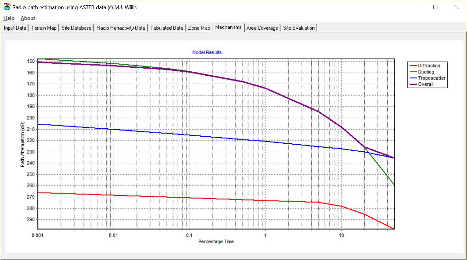

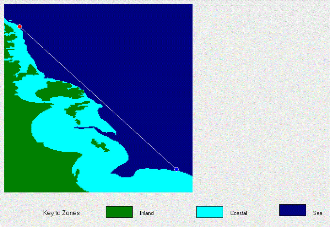

You are looking at the wrong panel - we are assuming this is a ducting path, not the 50% of time path. You can see from the mechanisms panel that ducting will dominate and you can guess this from the zone map as its a sea path skirting a coastal zone.
Try putting in a more realistic time percentage, say 10% or less and you will get a path loss estimate much closer to line of sight.
In other words, it looks entirely feasible given the right conditions.
