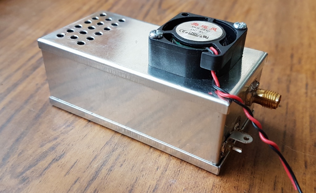

Re: G4BAO driver amplifier
Kit arrived quickly, thanks John. All built up and just to test.
73 Dave.
73 Dave.
- 31320189515.jpg (191.3 KiB) Viewed 4731 times
