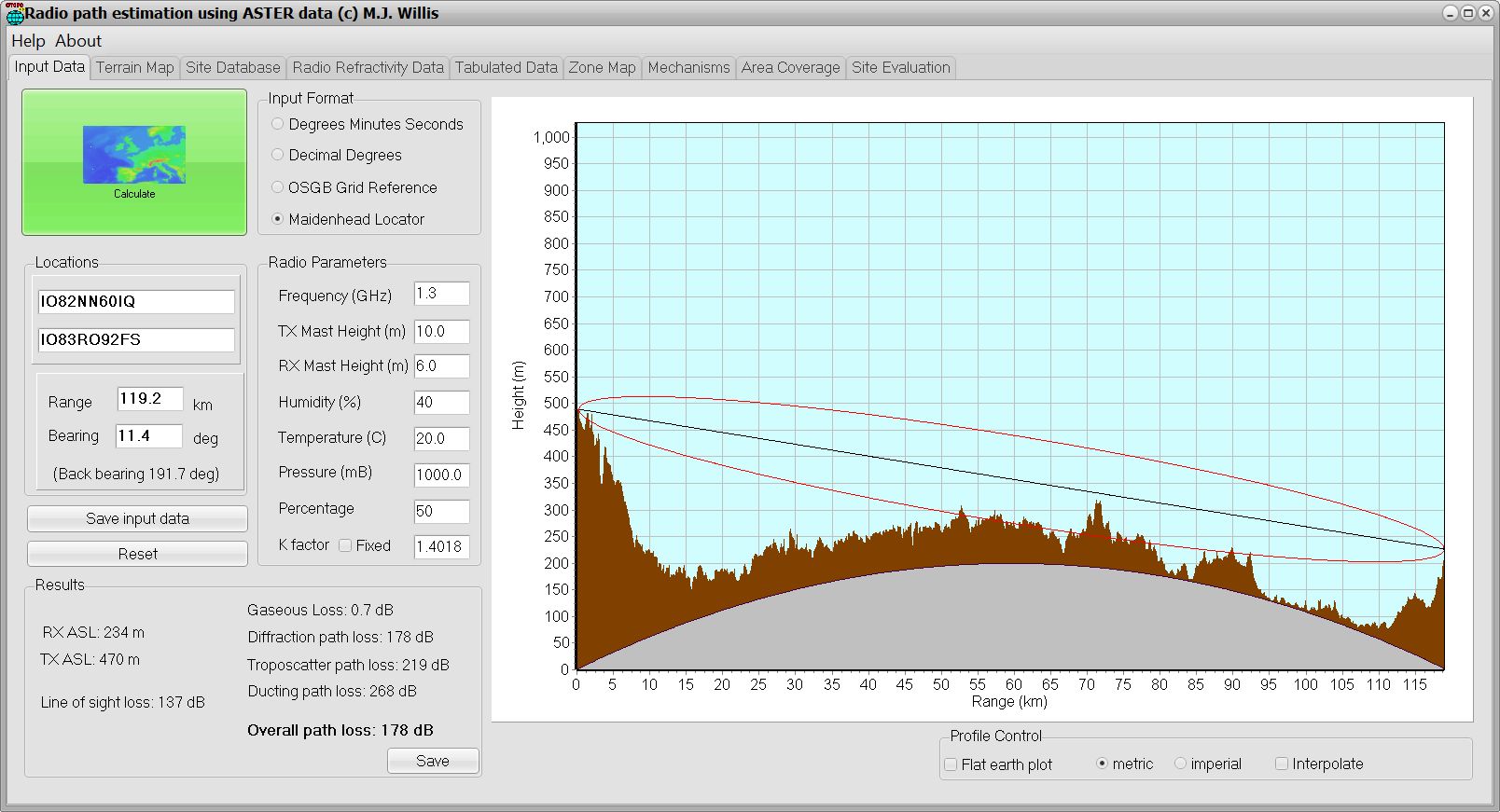

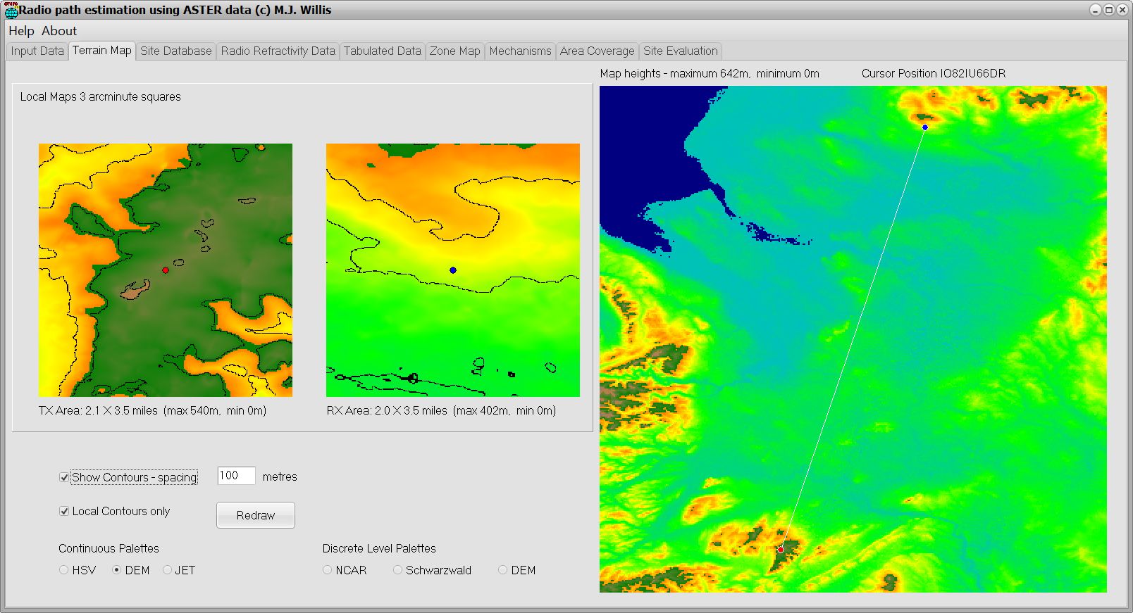

Post by g0mjw » Fri Aug 03, 2018 8:29 pm
I am up on Winter Hill with 2m and 70cm and 23cm.
The path seems line of sight - probably good on 10GHz and 24 GHz if I had it with me. Its 119km long, bearing 11 degrees.
Here is the terrain in between - pretty flat

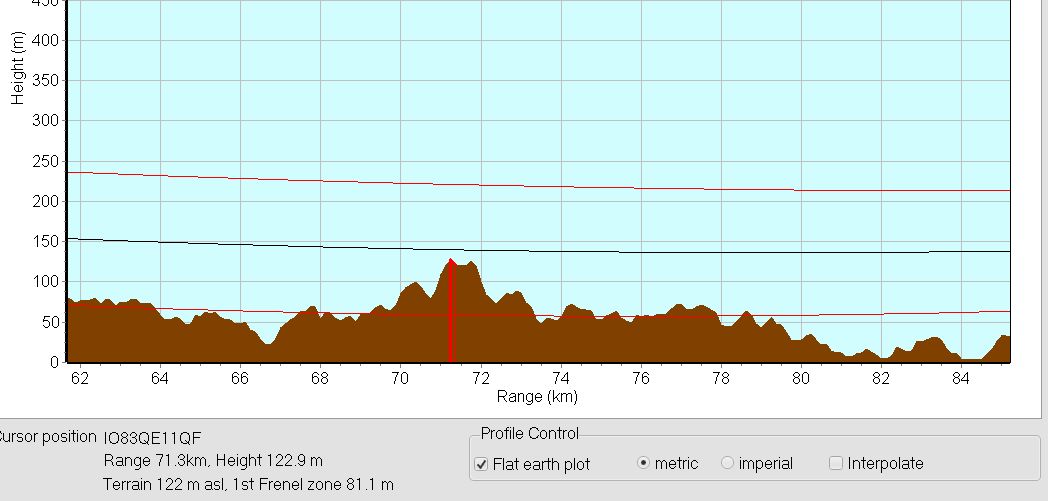

And here is the significant obstruction into the first Fresnel zone... IO83QE11 a local high spot.
