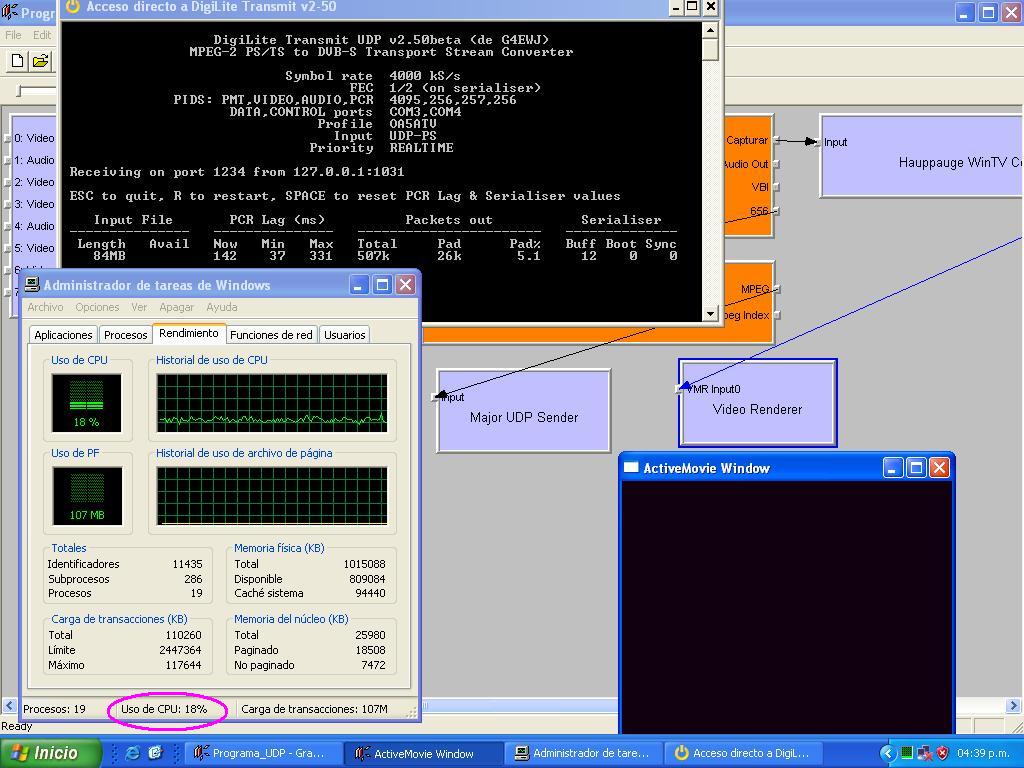

Hi Brian;
This new version is very interesting, many congratulations to you, as we say here: "usted es un cerebrito" . For my digilite transmission system, I use a PC compatible with Celeron microprocessor speed of 2.4 GHz, 1 GB RAM and 80 GB hard drive, with the task manager WXP use is 18%, including a small video window renderer, it's nice not having to write to the hard drive, I can use an old 20Gb hard drive that I have only saved. The "no audio" option is interesting for low SR, I have a question a little off topic, can Digilite only transmit audio ? like a satellite radio.
Best Regards
Josue
OA5ATV
Best Regards
Josue
OA5ATV
- performance of my system
- Rendimiento_UDP_Monitor.JPG (132.32 KiB) Viewed 30816 times
