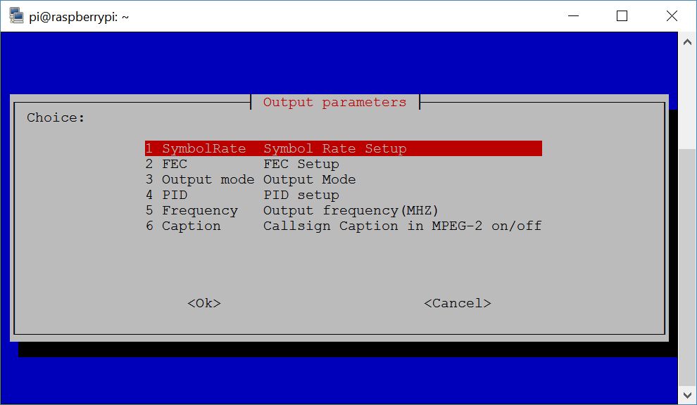

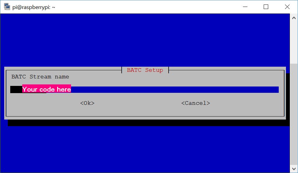

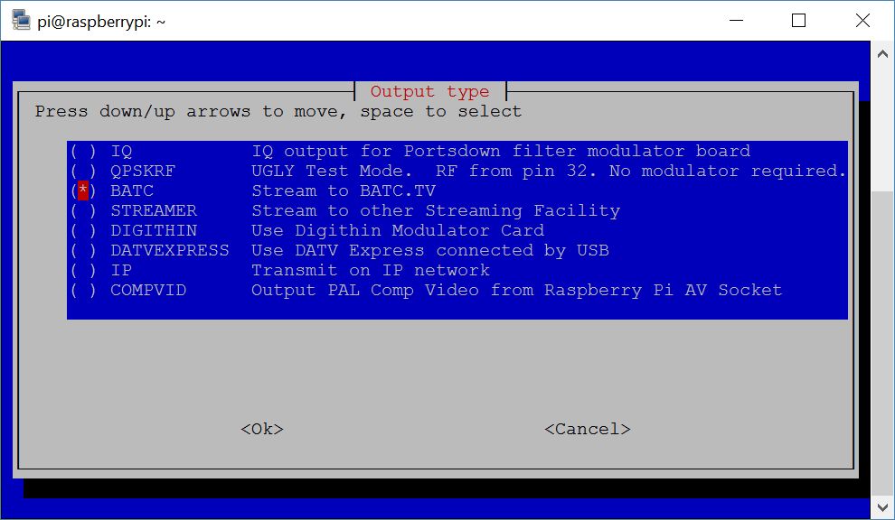

The Portsdown setup requires console mode - you just look on the streamer to find your address and copy it to the Portsdown. I will try to post a picture.
First screen missing as forum only allows 3 - anyway its pretty obvious
