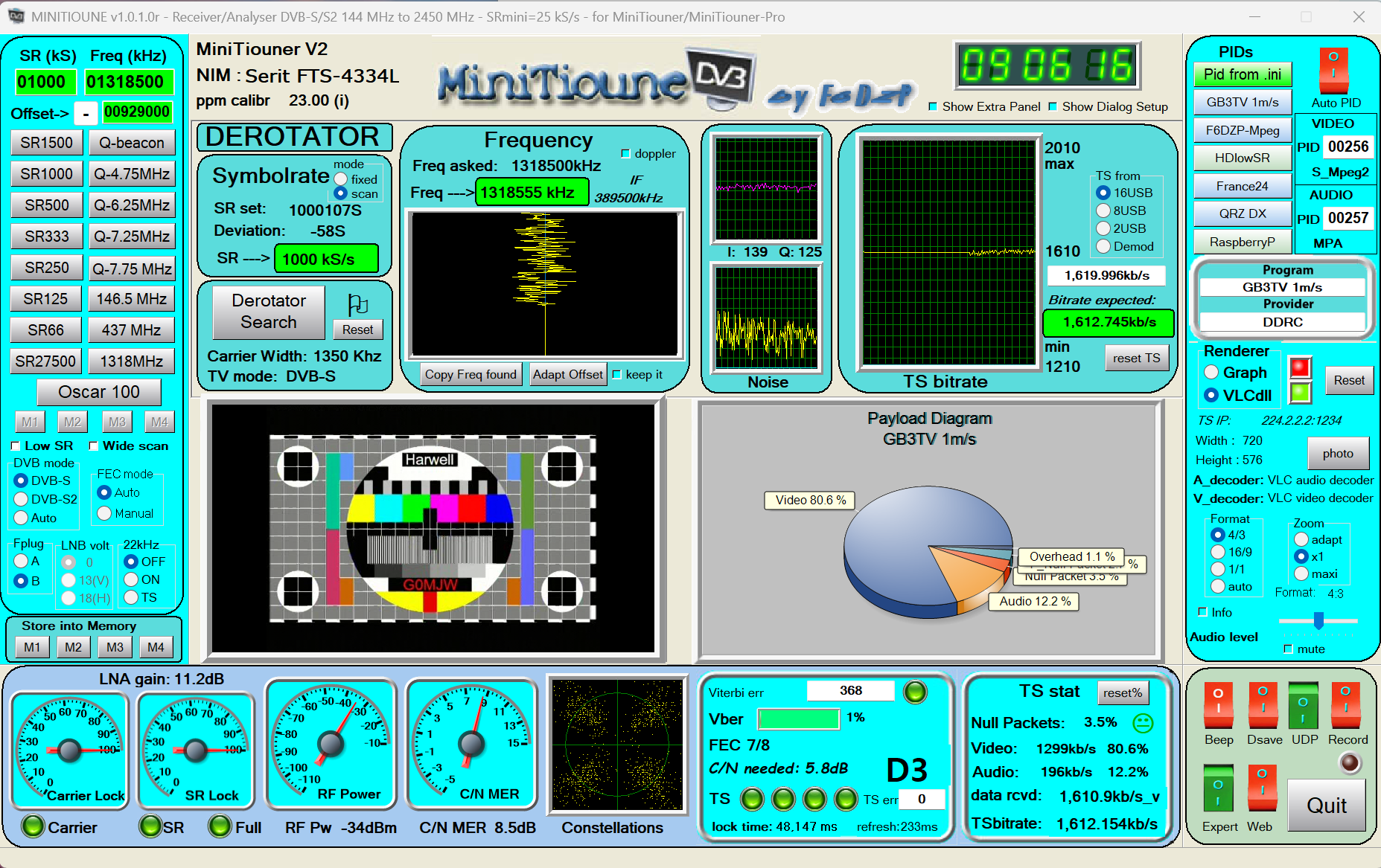

Post by g0mjw » Thu Jul 24, 2025 8:13 am
Quick test, unfortunately my 70cm TX desenses my 23cm RX terribly. So I reduced power to about 1W and
Screenshot 2025-07-24 090622.png (714.85 KiB) Viewed 289 times
So there is certainly an improvement. I am still de-sensing myself so the return of the streamer would really help
Edit Arthur G4CPE came back, so certainly working. If I can get in with 1W to the beam I might investigate a second antenna to avoid the de-sensing.
