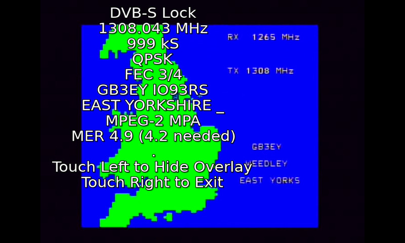

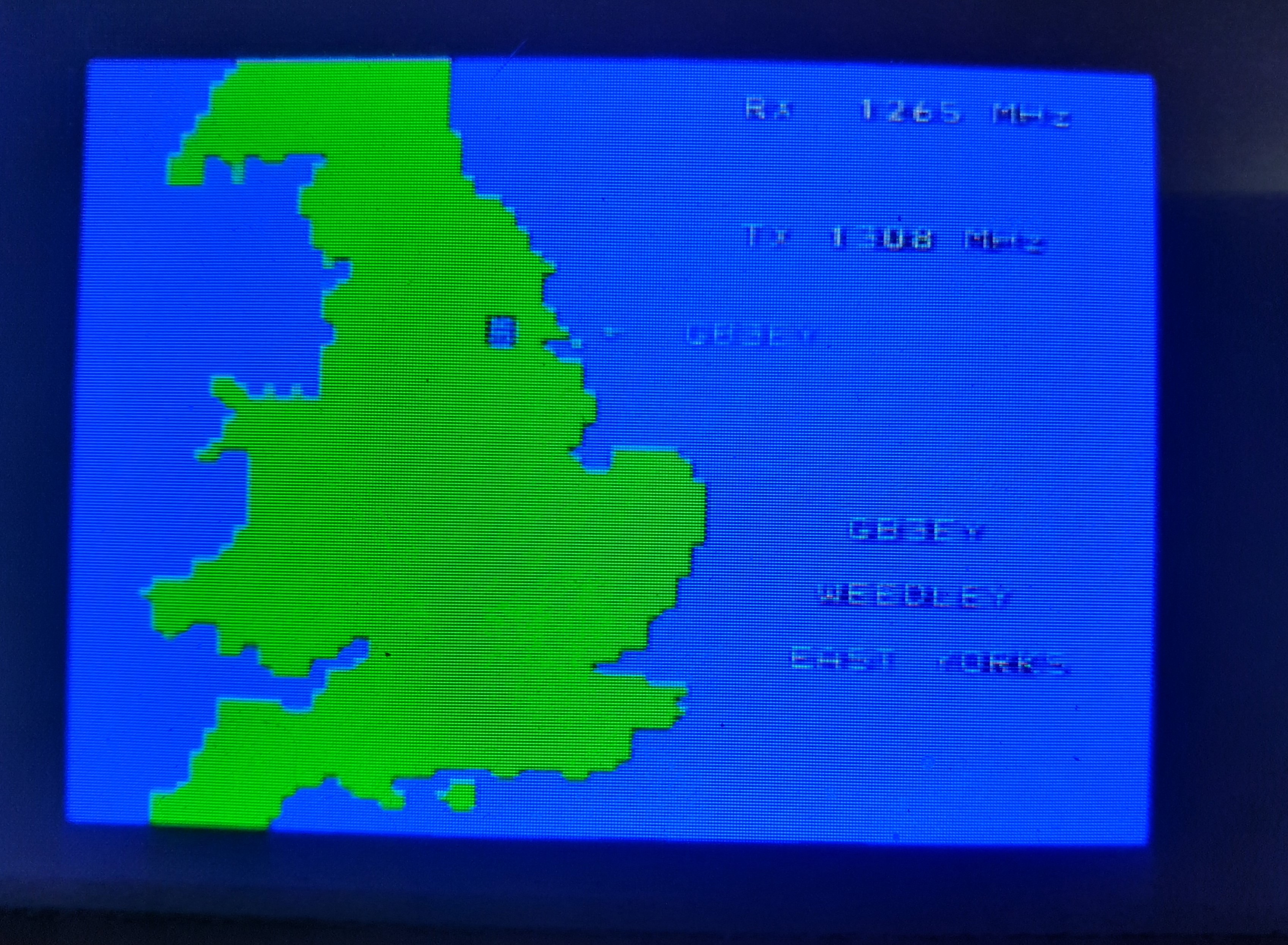

Ive managed to receive signal tonight
in the village of Waltham just south of Grimsby
loc IO93WM
Roger M1CDQ

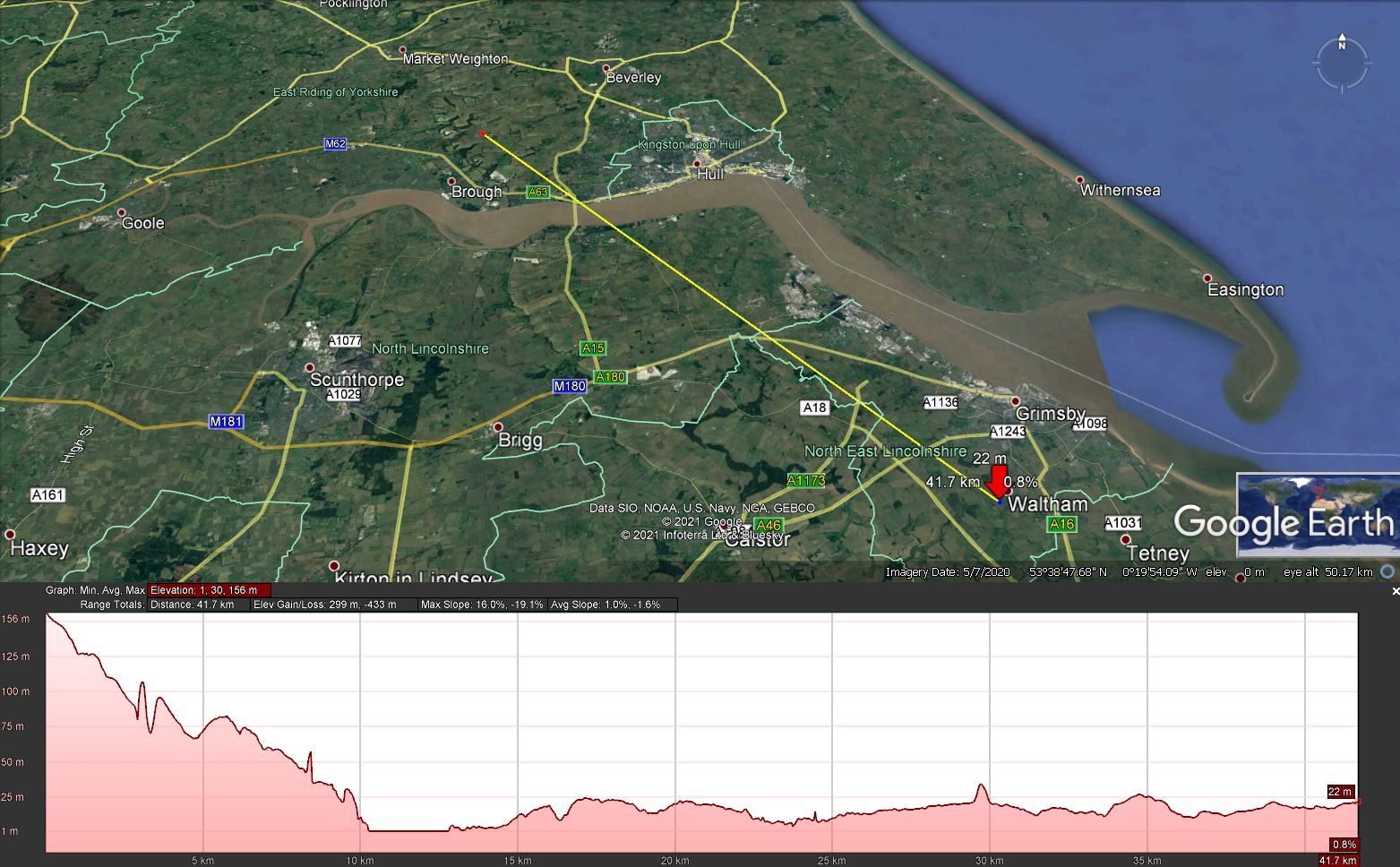

Good to see that you've received EY, Roger. Did you get to the bottom of what was causing your earlier problems?
The propagation tools suggested that you should be able to receive it there with a modest set up comprising of12dBi antenna at 8m AGL and 3dB feeder loss that would give you 8.5 microvolts. That's ample.

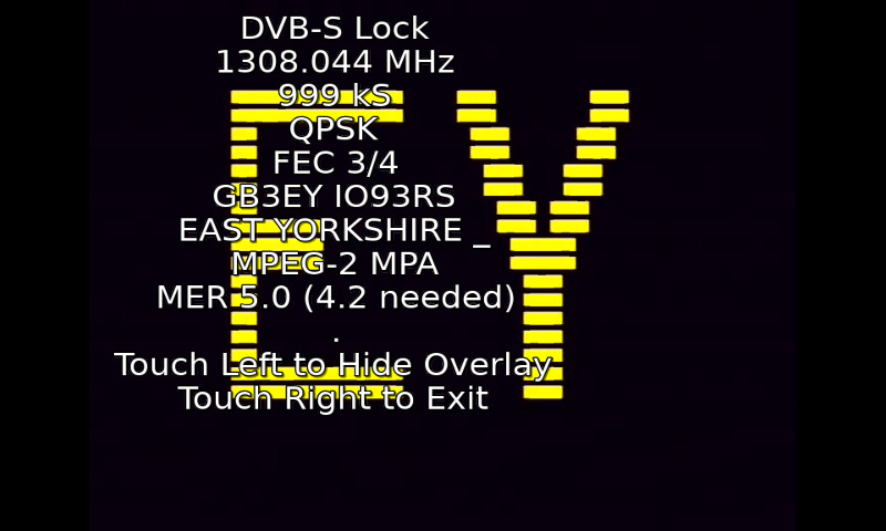

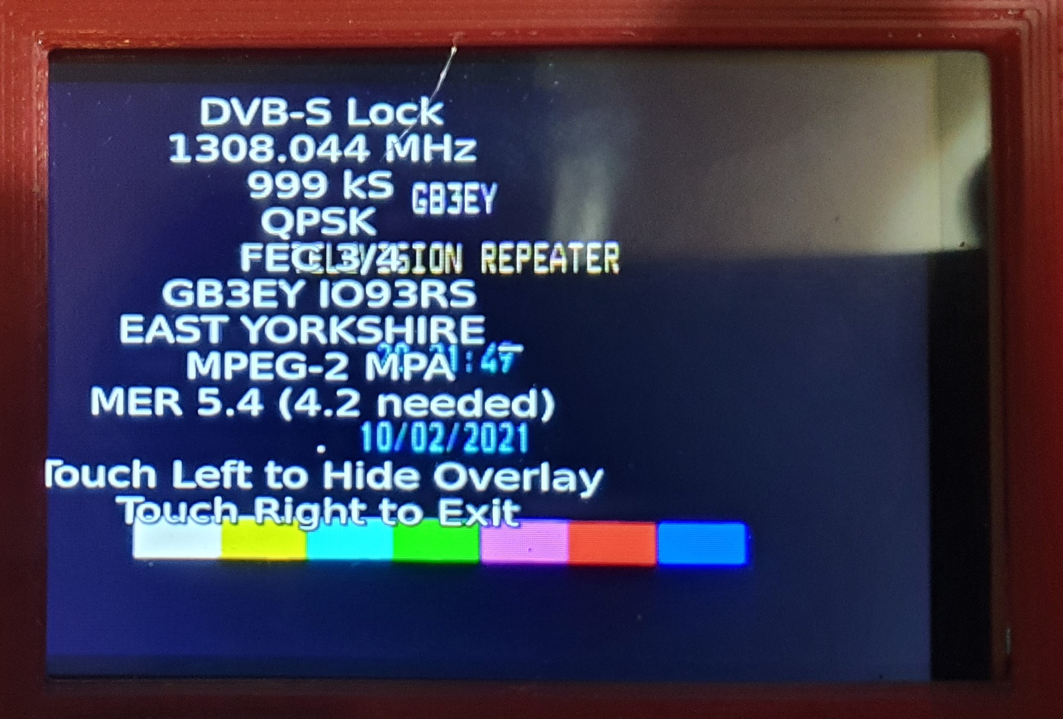

This is strange one for the wizards of the dark art of propagation.
no change to system or beam heading gone from an intermittent mer4 .2 need 4.2 and decodes.
to mer5 signal stronger the darker the night
