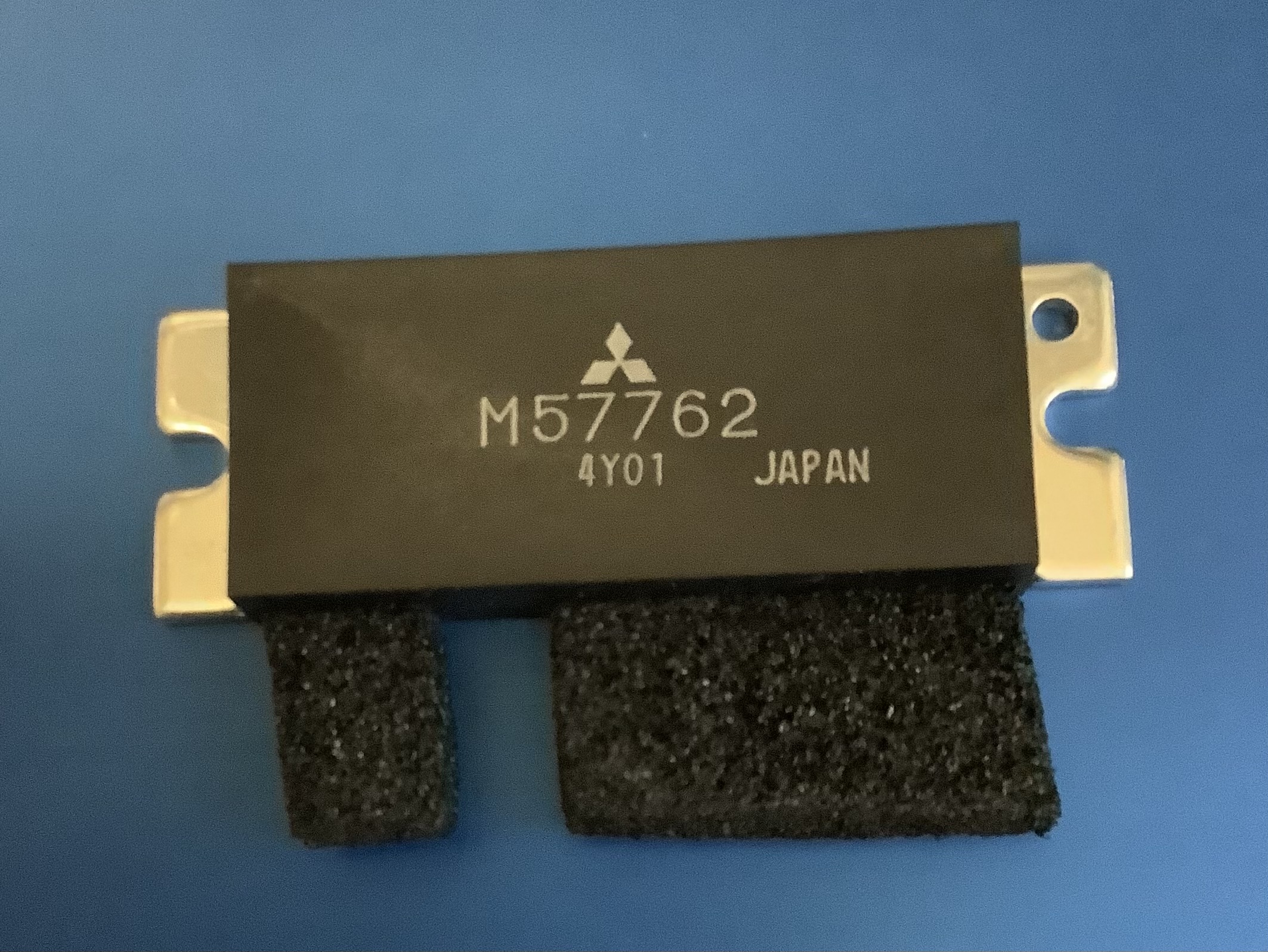

Re: Mitsubishi Power Amplifier modules
Will have to keep this version then
I have some bad results with this module anyway.
I have 2 ra18H1213G in use witch are similar price range but much higher Gain and better linearity
I get easy 15 watt datv out of them.
With only 200mw in on 15Volt.
Benno
Benno

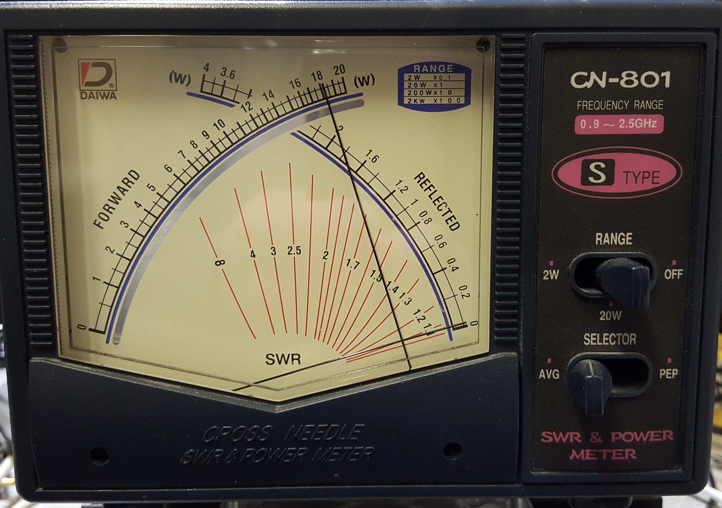

My original gives 18w
- IMG_1039.jpg (1.03 MiB) Viewed 9968 times
But how far down from the peak are the shoulders?
The bipolar M57762 and the MOSFET RA18H1213G perform well in DATV service provided you keep the power output to 5W and 6W RMS respectively. Meters like the CN-801 read about 13% high on a DATV signal.
The gain of the bipolar is about 13dB and the MOSFET version is around 23dB.
Clive G3GJA
Clive G3GJA
