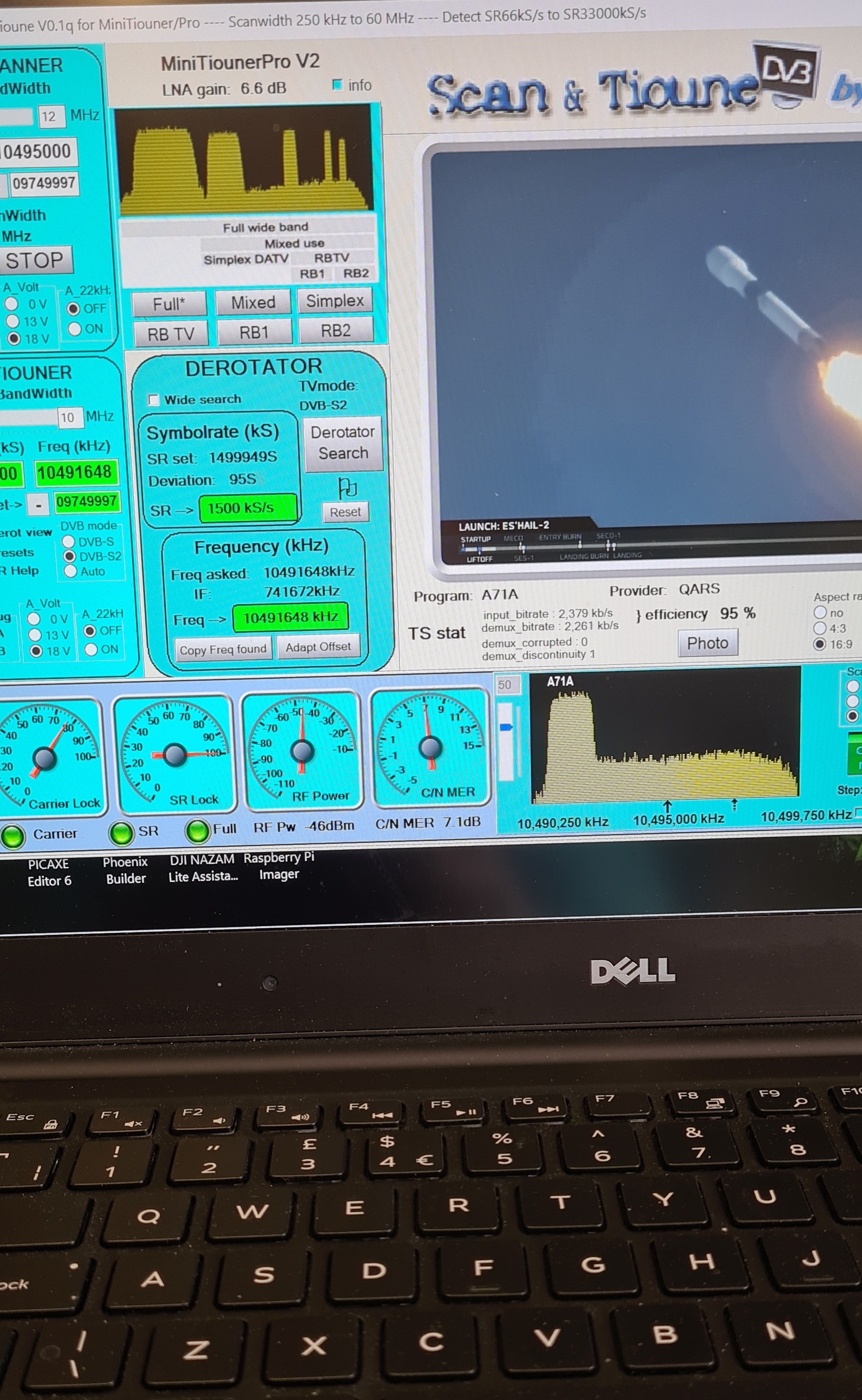

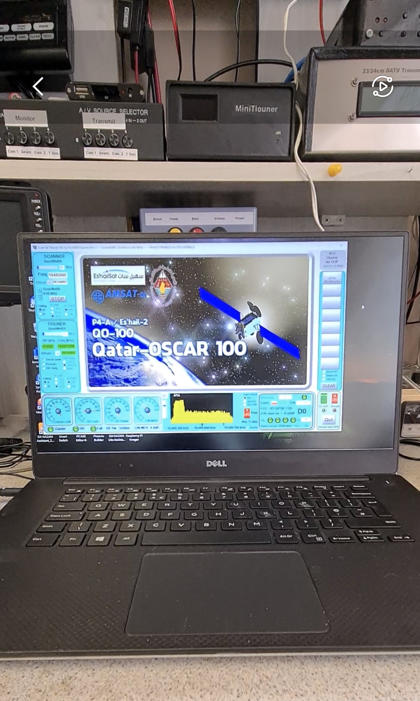

So have managed to get a signal on my small old sky dish, going to try 80cm dish soon.

Post by g6hfs » Thu Aug 18, 2022 6:14 pm
Installed the 80cm dish today, may try a position tweak but looking ok at 7.1db after first alignment, the old dish was boarder line and just over 4.0db

Post by radiogareth » Thu Aug 18, 2022 9:07 pm
That's GOOD for a 80cm dish....
