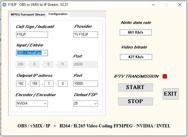

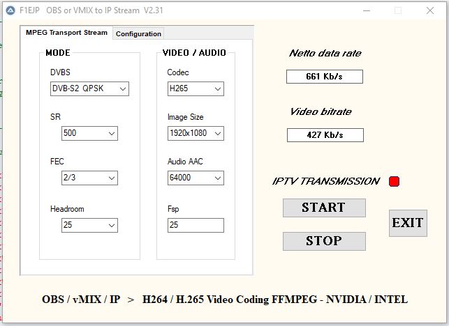

Hello all,
Currently under test and development of a new version in graphical software V2.31
It comes with everything you need plus a few additional options!
No need to have FFMPEG anymore
Input for OBS with virtualCam or vMIX or ip flux
Coding with NVIDIA GPU or INTEL or Soft
New compression enhancements by providing optimized default settings for compression.
Currently being tested :roll:

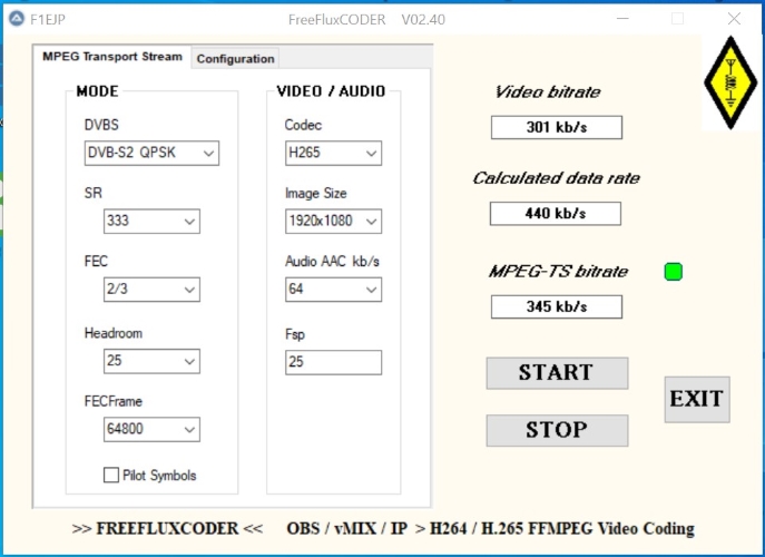

F1EJP
Posts: 81
Re: New Graphics Software to Generate Mpeg-TS Streams
Post by F1EJP » Thu Apr 08, 2021 11:26 pm
Hello
New screen
73 Dominique F1EJP

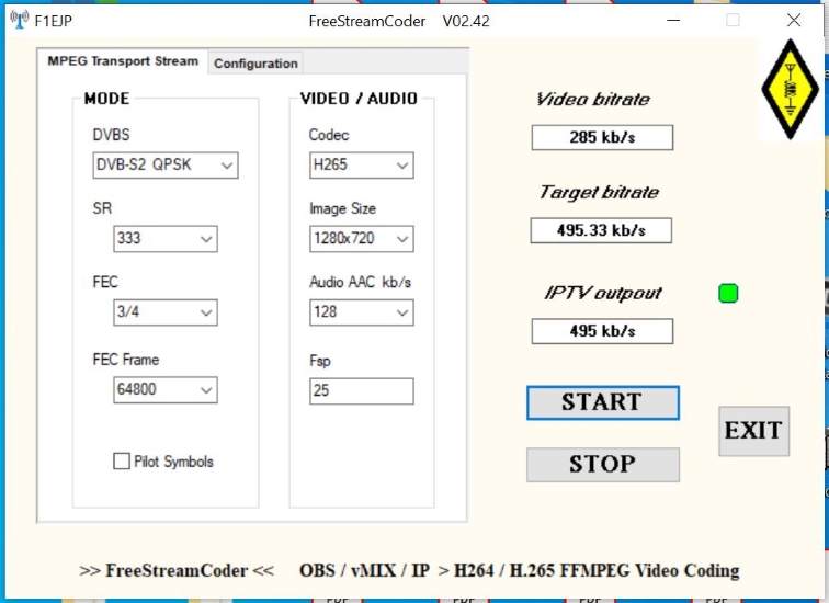

Post by F1EJP » Thu Apr 15, 2021 9:44 pm
Hello
- Version 1 was the batch script ;)
- I changed the name to a more explicit name
- it uses ffmpeg but no need to install it because it is included
We can code with FFMPEG with the support of an NVIDIA graphics card or a recent Intel processor with GPU or in software.
The source can be OBS or vMIX or an already encoded iP stream.
For each value of SR, depending on the configuration, the software proposes tested and approximately optimized default values VIDEO/AUDIO.
>> we can go down to very low speeds of the order of 88kb / s which should allow transmissions in DVB-S2 16PSK SR25
Still in test soon available
