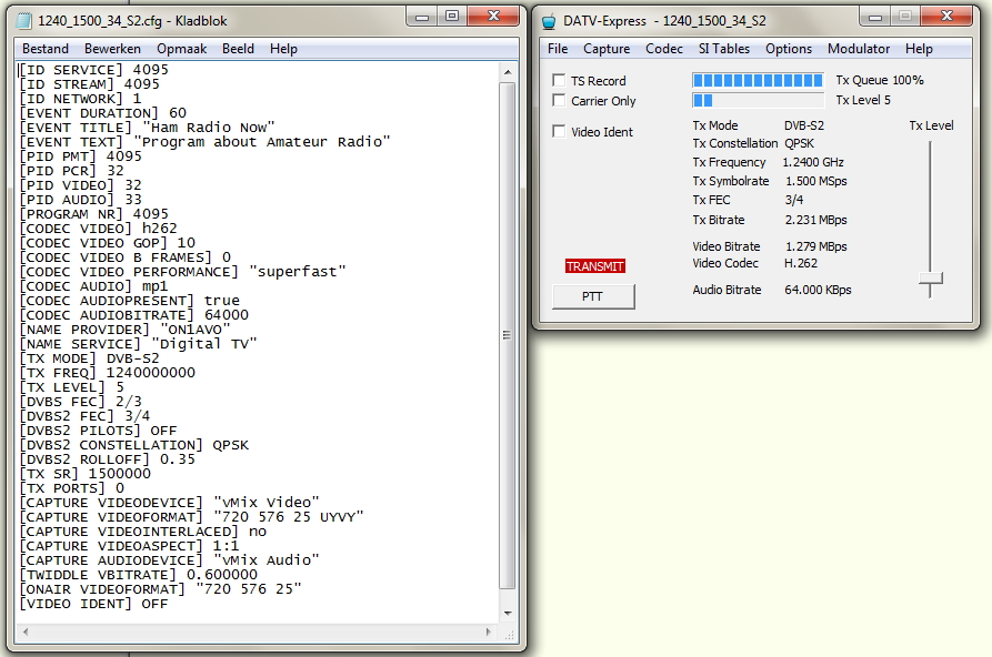

TX queue filling rapidly to 100% in DVB-S2 mode.
Changed twiddle factor, no change.
Same result using H264 (superfast).
Charles any idea?
TX queue DVB-S2.jpg (333.73 KiB) Viewed 3607 times
73 de ON1AVO

Yes,
I have had this problem myself.
After a Windows 10 update the system replaced the libusb-win32 driver with WinUSB
so you will need to run Zadig again and re-install the correct driver.
You will get a message asking you whether you want to downgrade the driver say yes.
Hope that fixes it.
