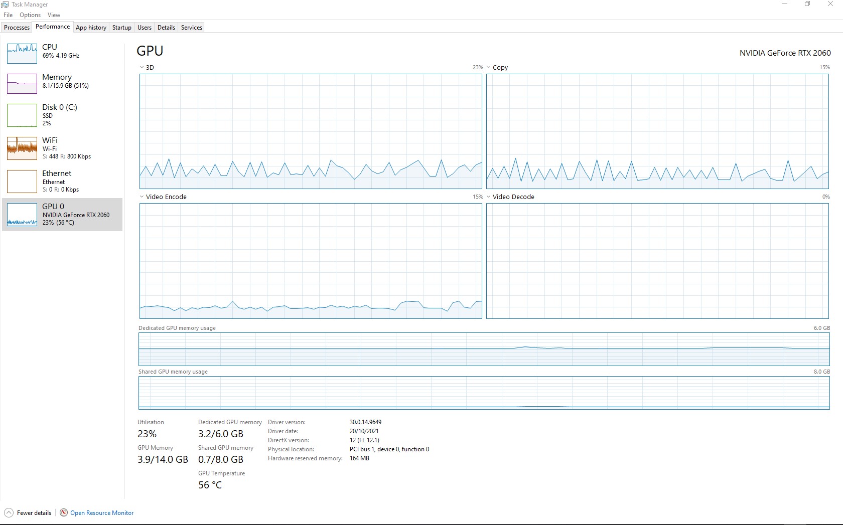

Excellent work Dominique, no issues with the install of either your software or the lime. Working well on a i5 laptop with a RTX 2060 using a Lime mini.
Cheers John G7JTT

Post by G7JTT » Tue May 17, 2022 7:50 am
This is a screen shot of Task Manager showing still room to spare with resources
