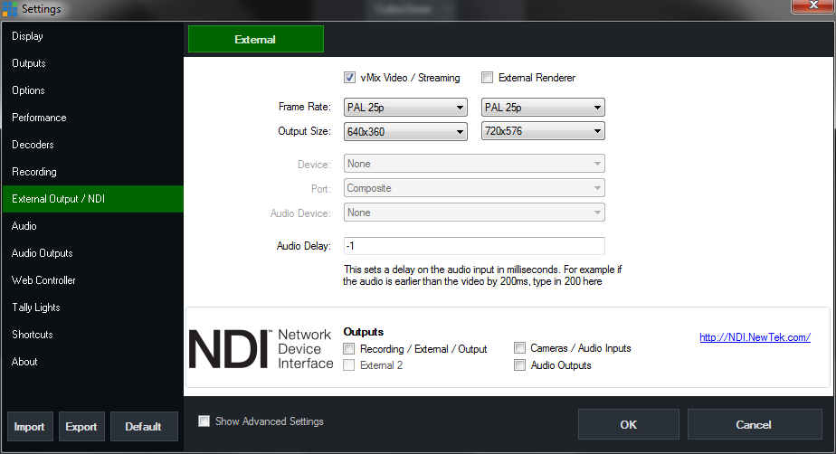

I have selected source Vmix Video in DATVExpress, started Vmix, no display colour bar, when I press OUTPUT no stream.
Can you send me your OUTPUT Vmix parameters ?
73 Franck, Tnx
Screenshot 2018-12-16 09.20.24.png (42.11 KiB) Viewed 9209 times
I am just using the defaults, if you are not seeing the colour bars then you are not
transmitting a proper signal.
