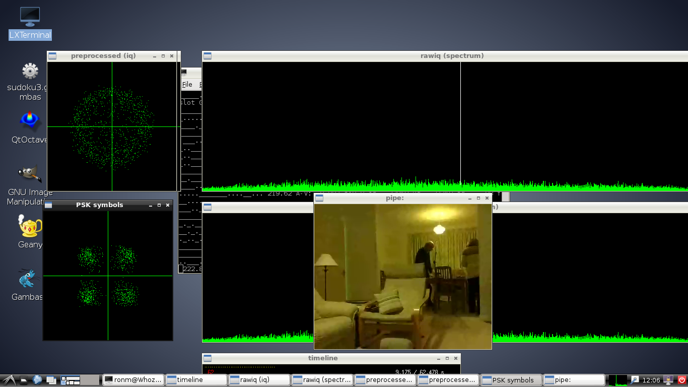

Excellent new version - now working with my non-PLL dongle (-p -10ppm according to kal) at 250ks/s and 300kHz sampling running under Debian in Virtual Box with video signal on 437.5MHz from RasPi using Evariste's 'ugly' mode. Constellation still looks rubbish but a picture emerges.
EDIT: better picture showing none-too-bad constellation.
- lean-3.png (196.89 KiB) Viewed 9600 times

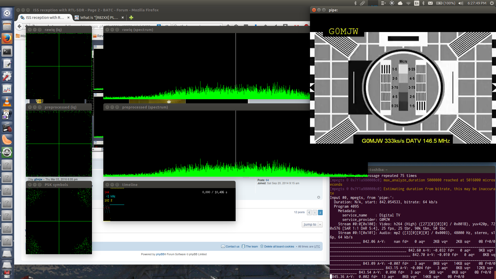

Does that mean you can receive my video?
- Screenshot from 2016-03-03 18_27_49.png (654.41 KiB) Viewed 9435 times
