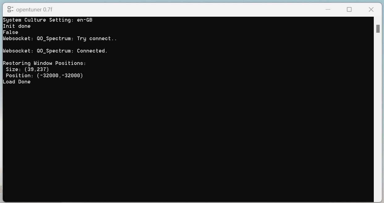

My PC has three screens connected and running Windows 11.
I have lost OpenTuner display.
I get the same results on my BATC MiniTioune and my Pro V2.
This is all I get when try to run the program.
Need Help
Need Help

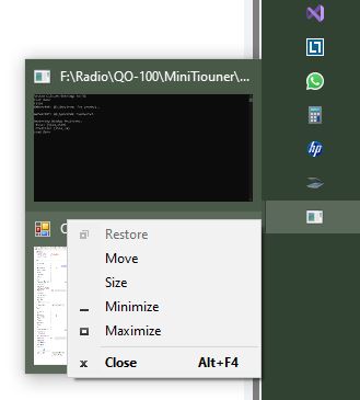

Ohannes ZS1SCI sugested this simple solution on WhatsApp:
- Right click the taskbar icon
- When open and click maximize
Tnx Ohannes!

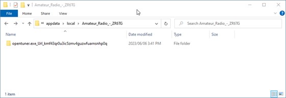

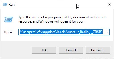

The configuration file is stored under %userprofile%\appdata\local\Amateur_Radio_-_ZR6TG
So your should be able to enter %userprofile%\appdata\local\Amateur_Radio_-_ZR6TG into a run dialog and get the folder
for example:
To open run dialog:
Windows Key + R
Press enter and you should get something along these lines:
Go into that folder and there will be a user.config file you can edit to restore those settings
This information was from Tom when I has the problem.
