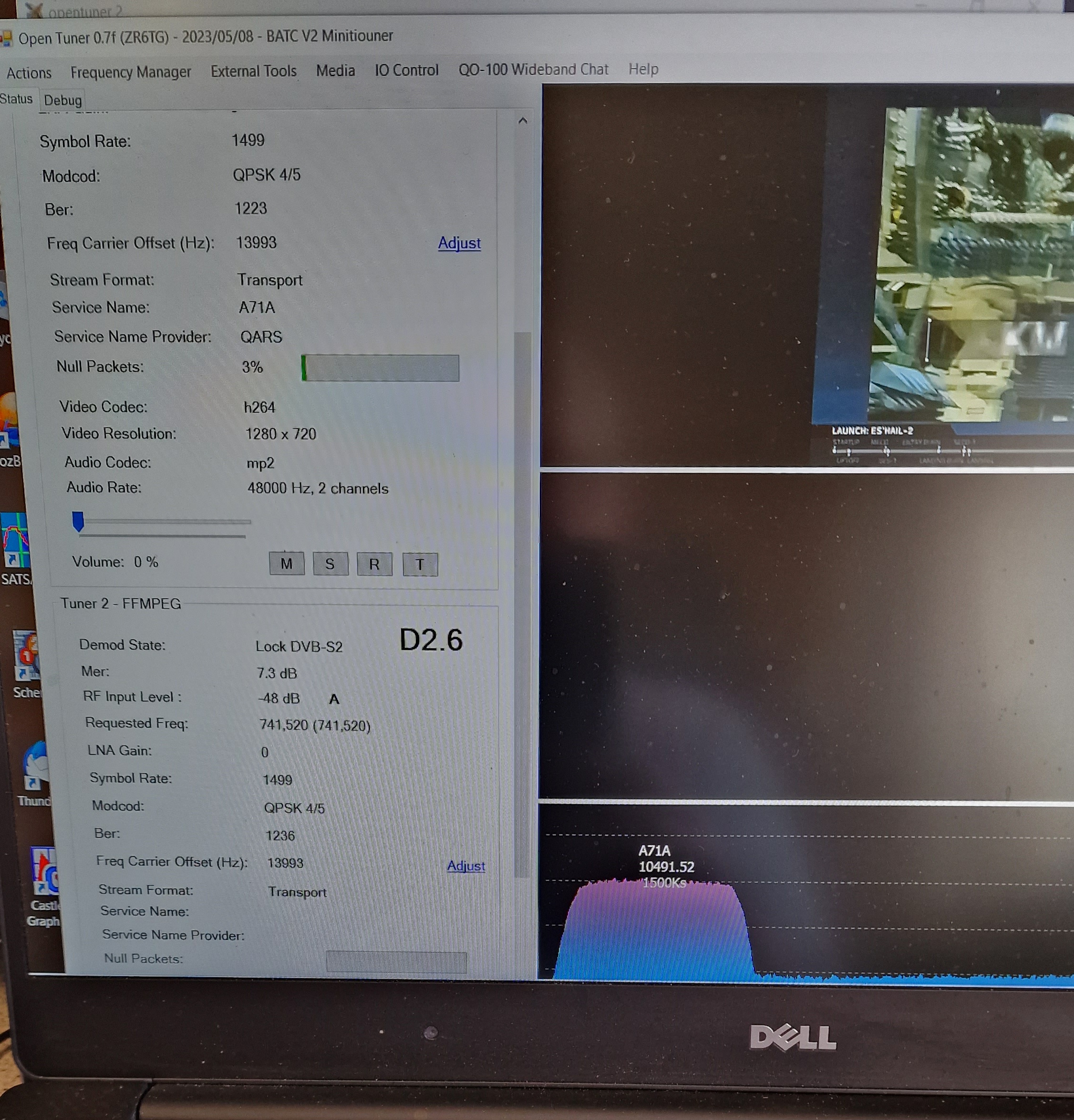

Have reprogrammed the second usb module, now get dual display but window B has info but no stream, need to find out why now.

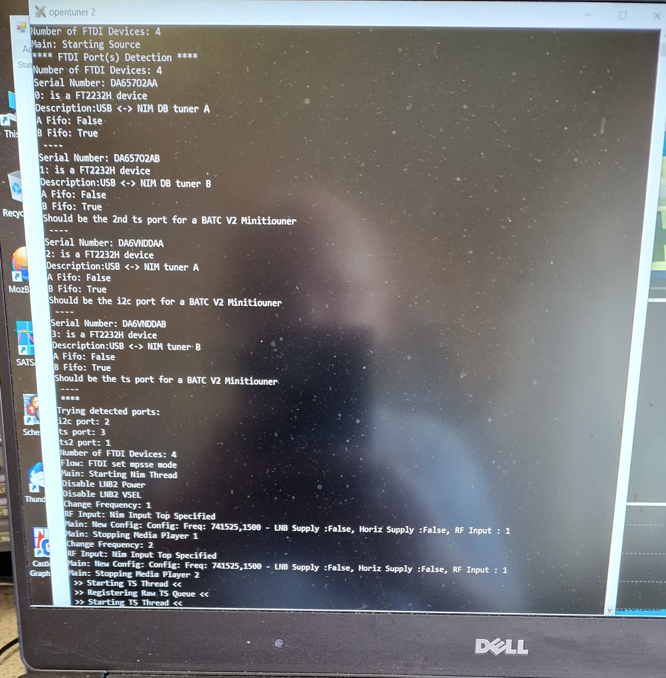

Tom,
Is this what you need

Re: Open Tuner 0.7 - Dual Tuner/FFMPEG, etc
Yes, there it shows the problem. The B port for your daughterboard is not enabled as a fifo port. Are you using the template, or did you directly change the USB descriptor strings?
On that screenshot ftdi device 2 and 3 (which is your new module) should show true next to fifo.
Its detecting it properly now, but your module isn't configure 100% yet.
- sorry for slow replies, I'm busy travelling for work.

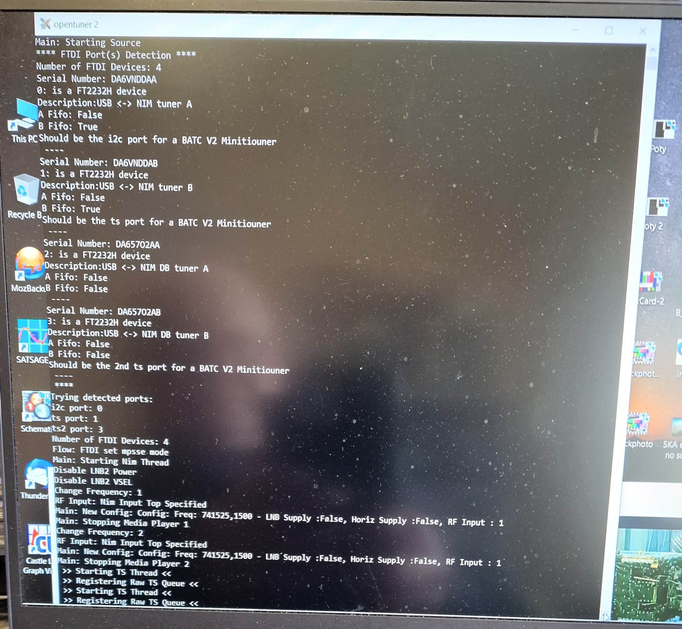

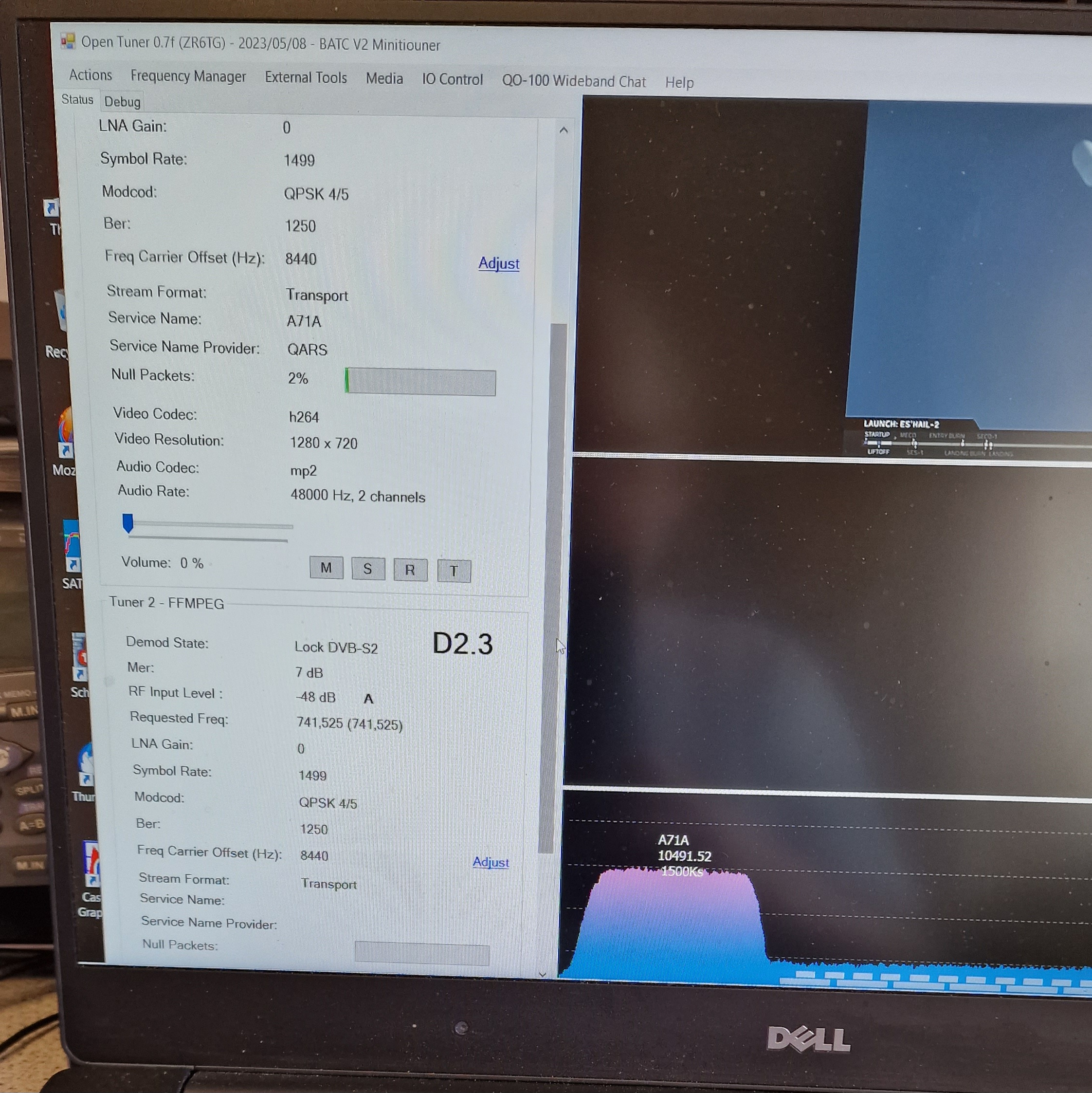

Tom,
Reprogramed usb 2 from file again, now its says fifo true for B again no video so not sure how to proceed, any more info or checks I need to do.
