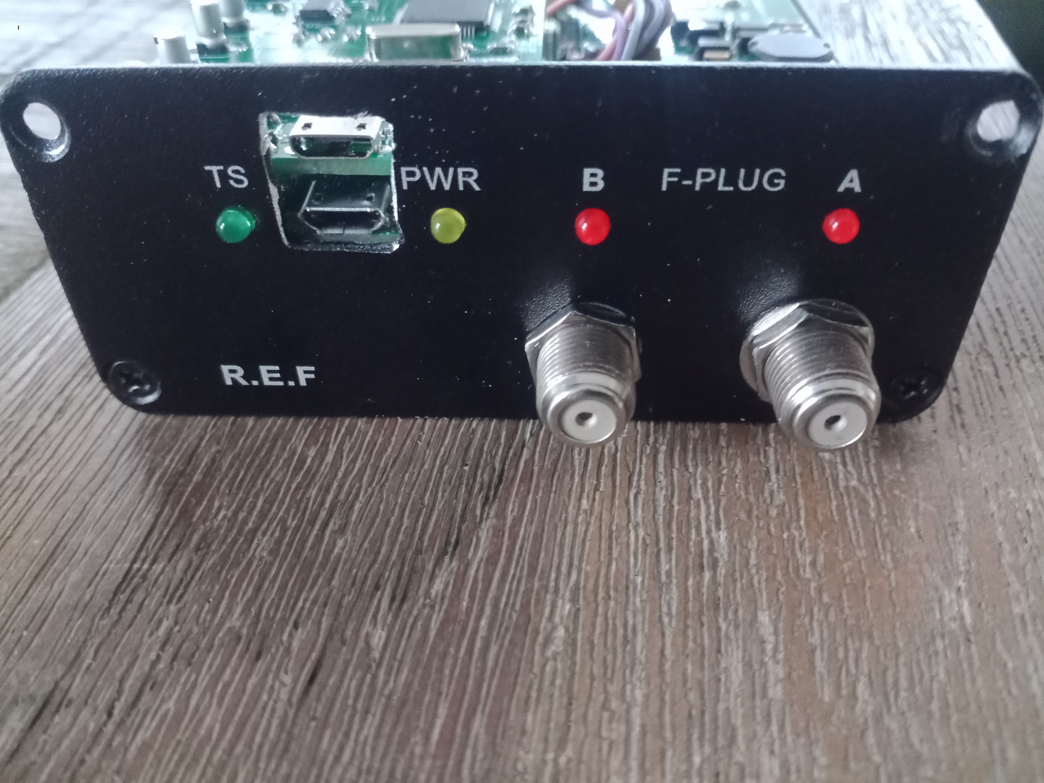

Done a couple of Rob PE1CHYs version.
Had an existing hole in the front panel so used that :-)

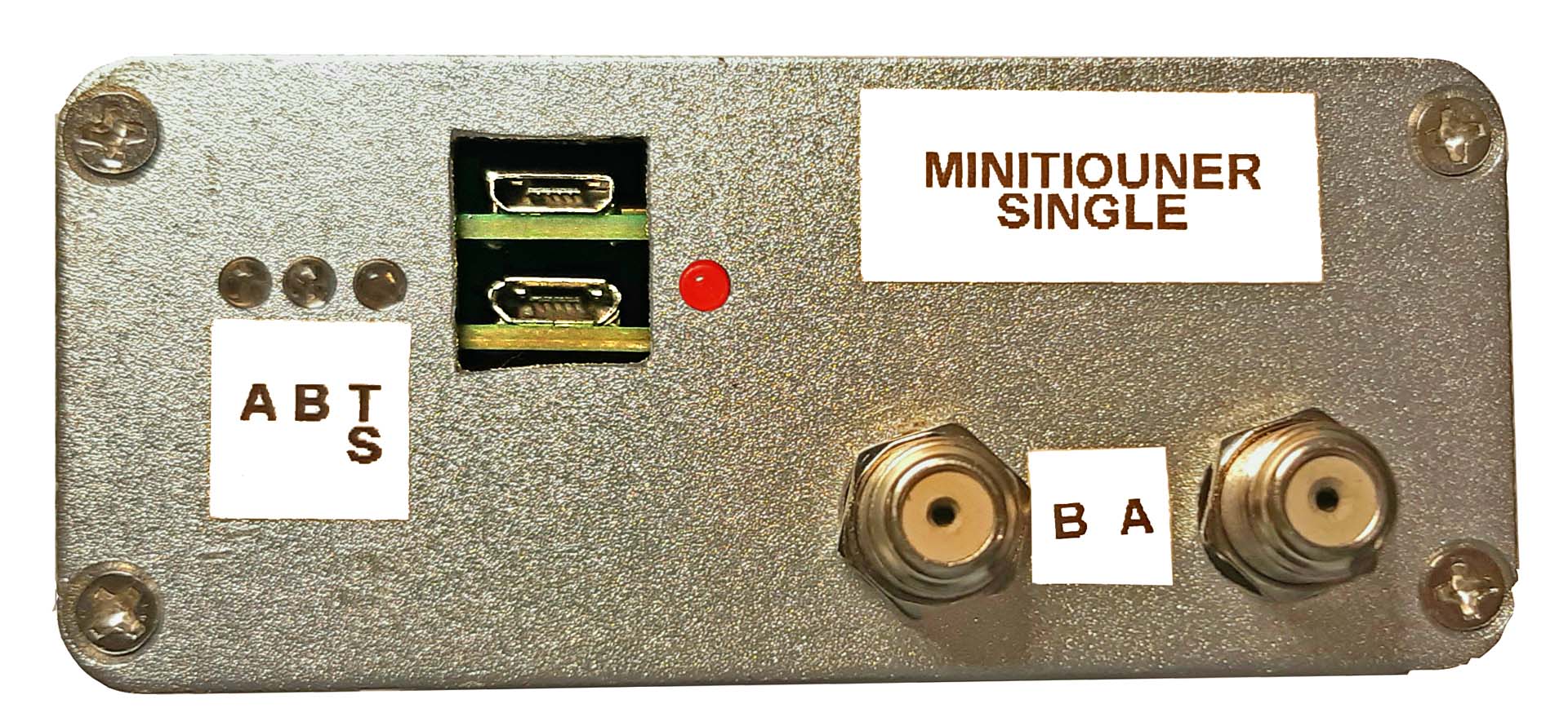

Post by DG2AAO » Tue Jun 20, 2023 10:18 am

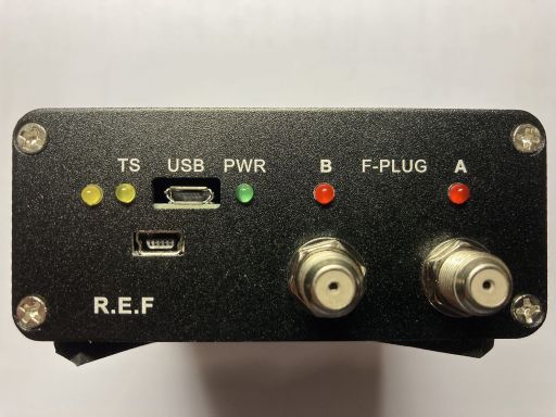

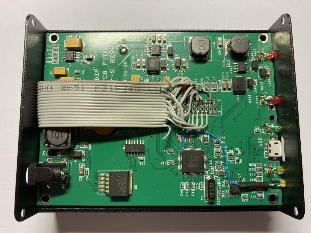

my modification of the MiniTiouner-S with 2nd USB port and 2nd LED for TS at pin 32 of the FT2232H
(thanks Benno PA3FBX for the idea)
Front mit 2. USB und 2. LED für TS.jpg (34.42 KiB) Viewed 19898 times
Anschluß Tuner und 2. LED für TS an Pin 32.jpg (142.81 KiB) Viewed 19898 times
Platine Verdrahtung.jpg (59.69 KiB) Viewed 19898 times
Platine eingebaut.jpg (92.14 KiB) Viewed 19898 times

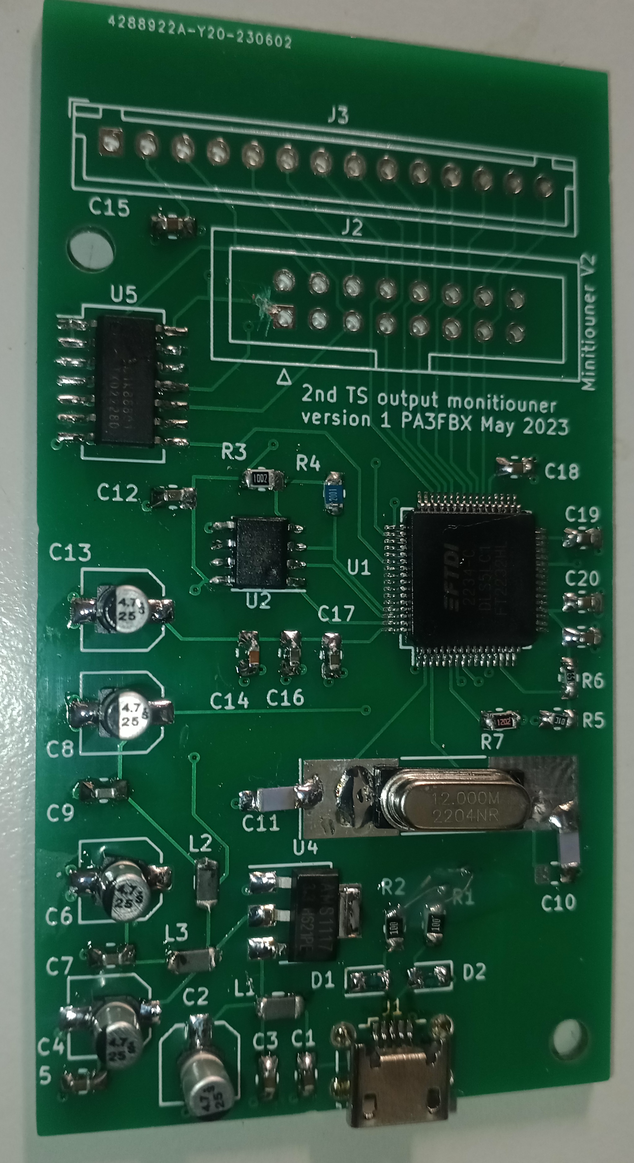

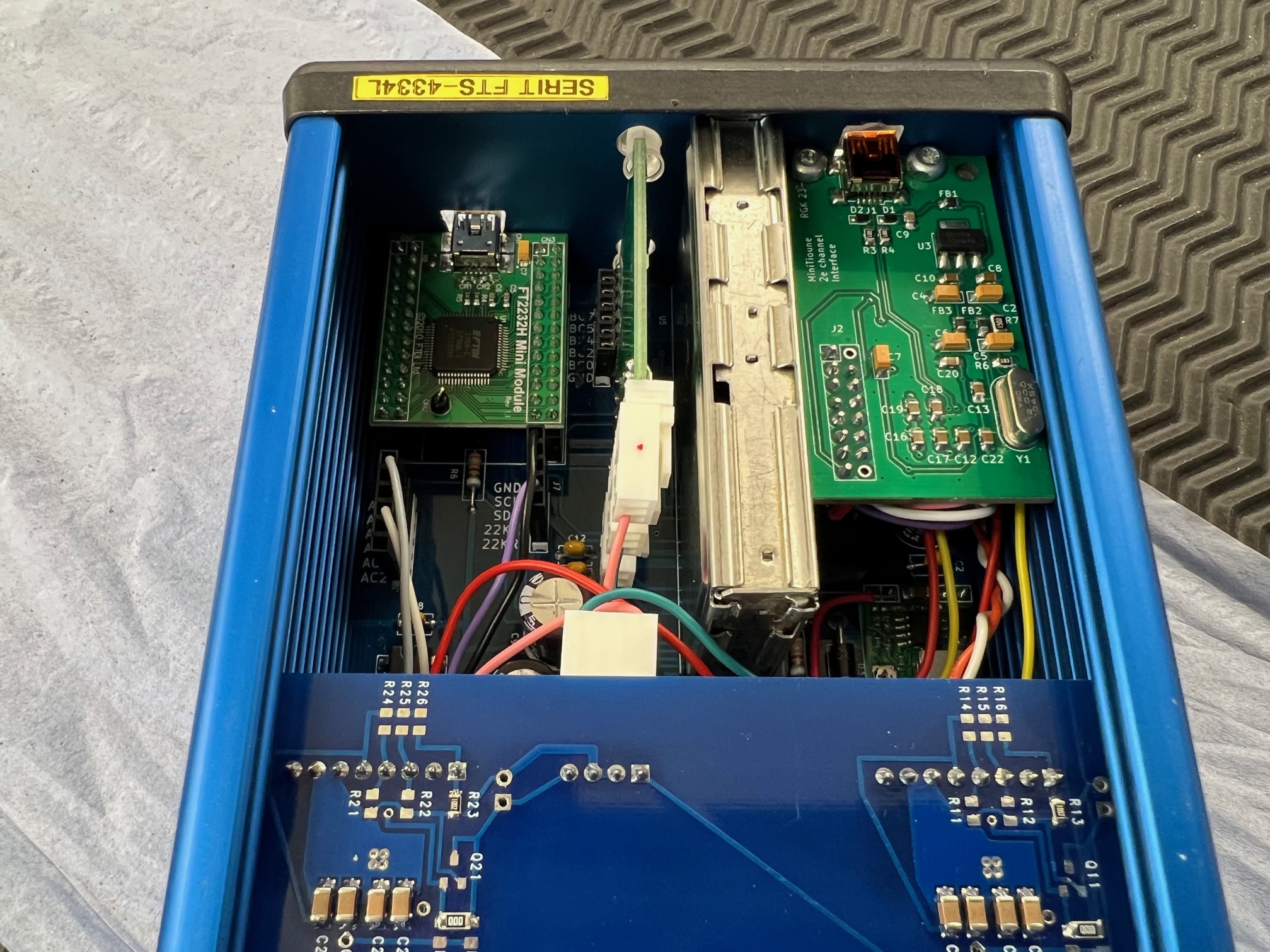

Post by Pa3fbx » Tue Jun 20, 2023 8:52 pm
Great job,

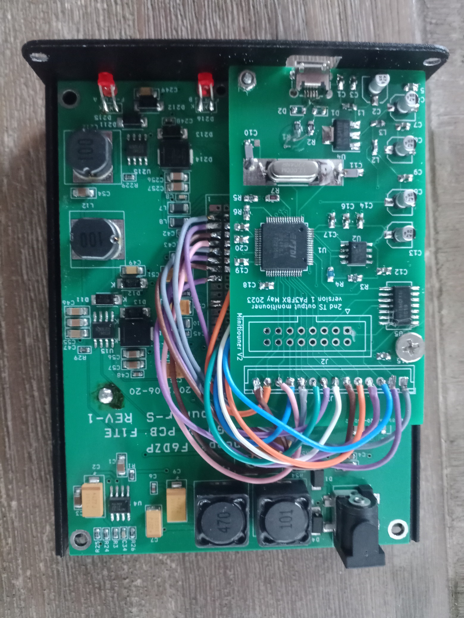

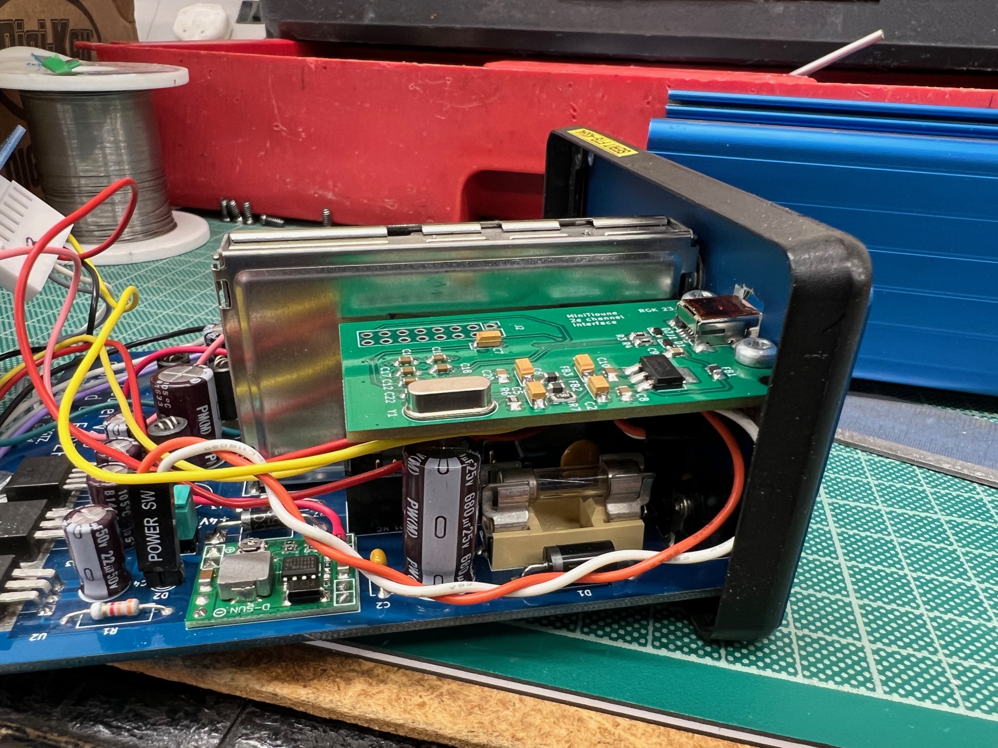

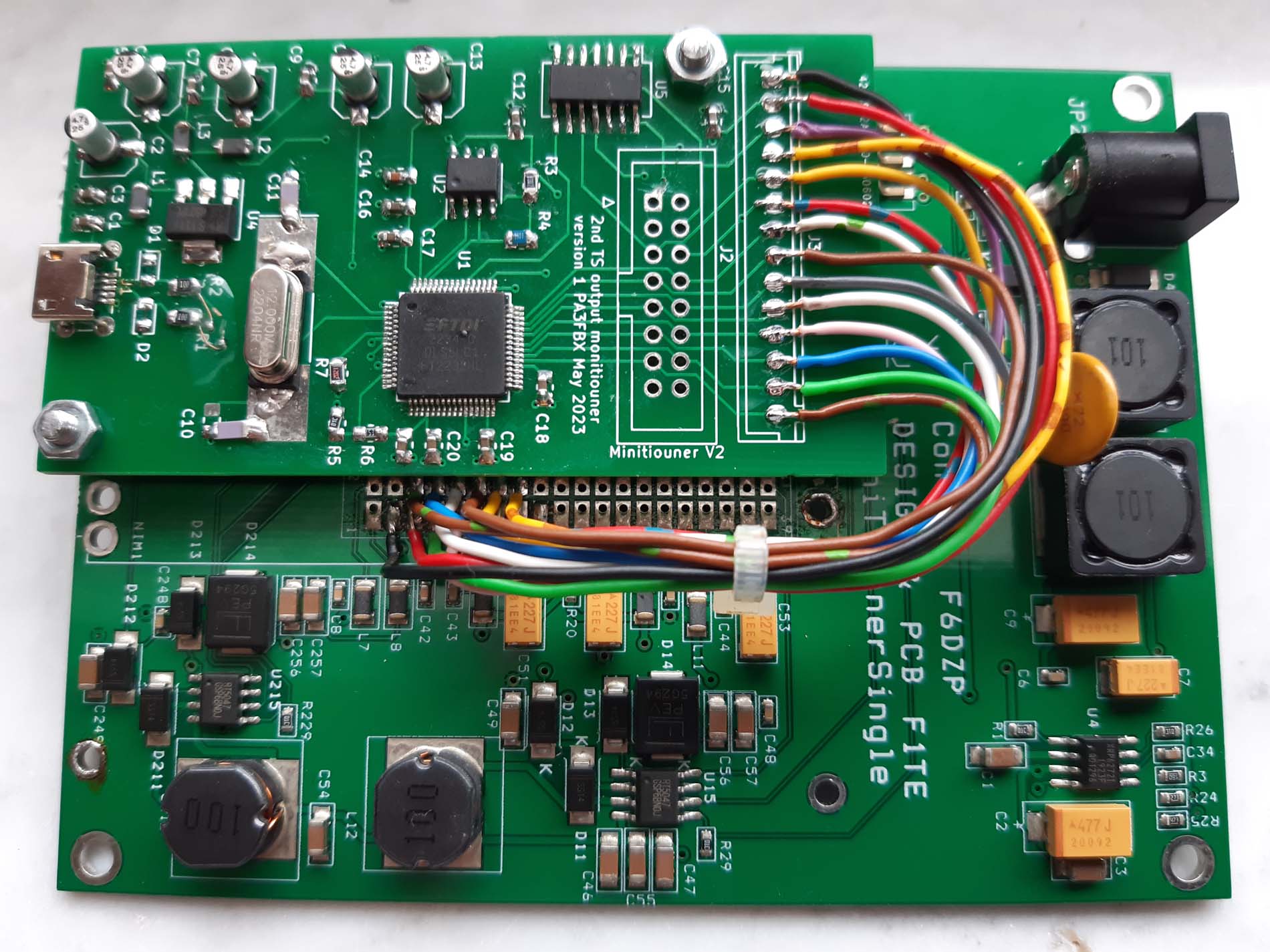

I just finished mine
mounted in the S...
2nd board fitted topside.jpg (1.08 MiB) Viewed 19892 times
2nd board fitted front-side.jpg (1005.55 KiB) Viewed 19892 times

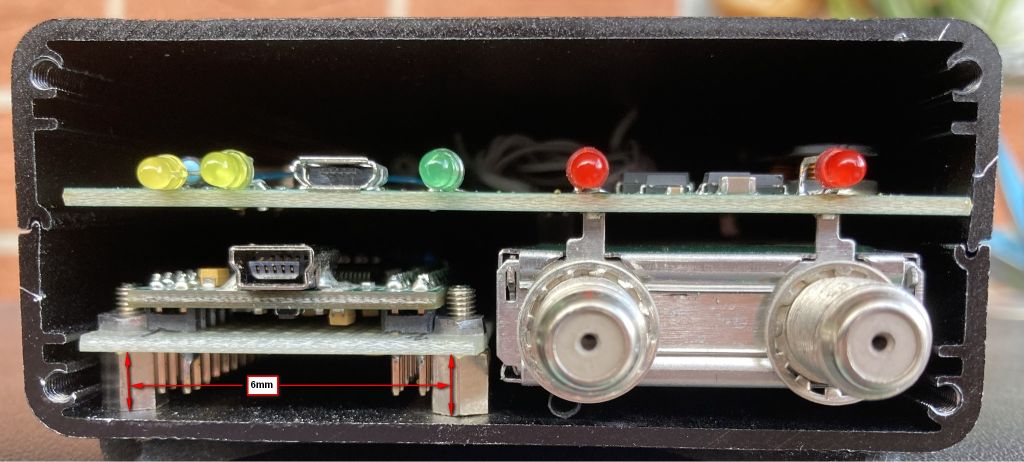

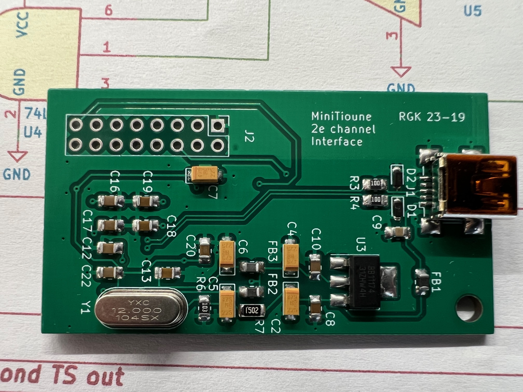

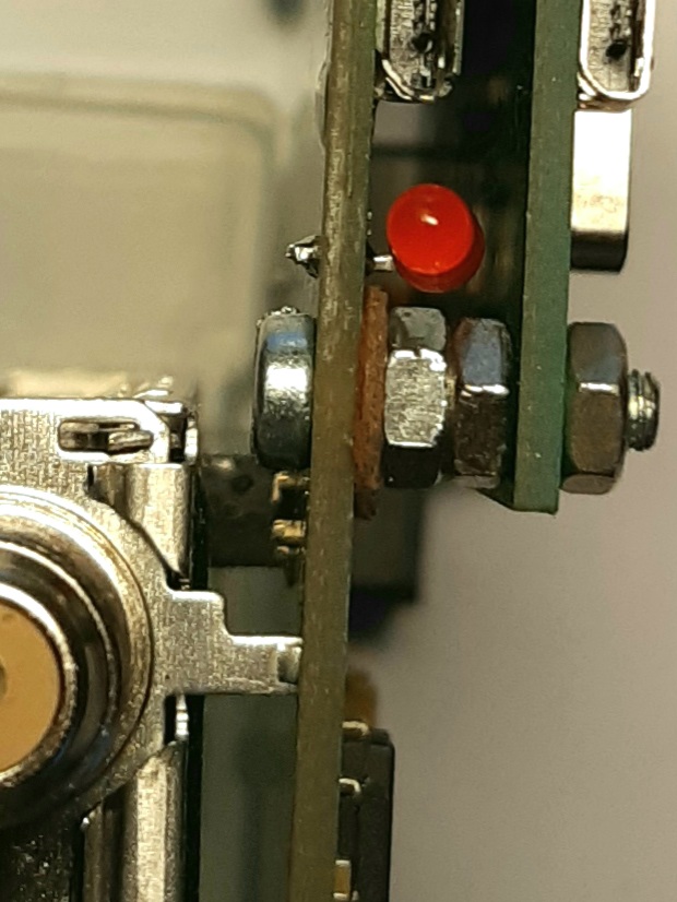

Post by on6py-Rudy » Mon Jun 26, 2023 10:40 am

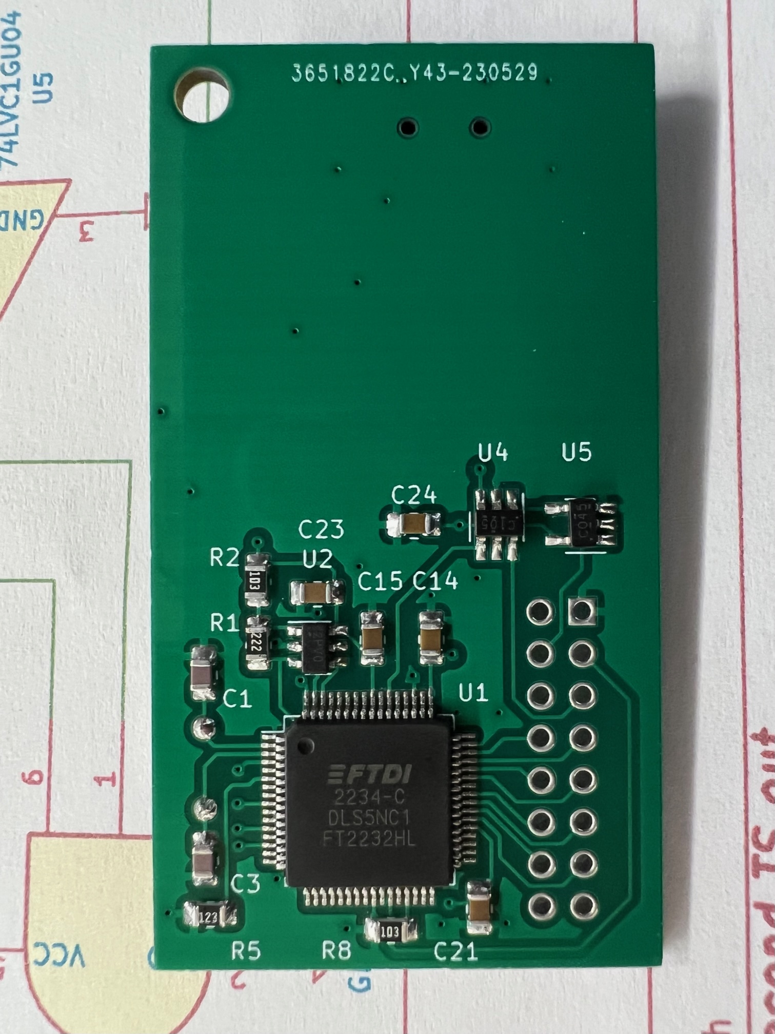

Here you can see the nice result of the extension of my Minitiouner-S (older version) with a second TS output. The PCB, designed by Benno PA3FBX, fits very well on the main board and can be built into the aluminum box perfectly. Do use an insulating washer between the PCB and the nut to prevent unwanted connections!
frontpaneel ON6PY.jpg (299.07 KiB) Viewed 19753 times
20230622_195007 klein.jpg (292.94 KiB) Viewed 19753 times
