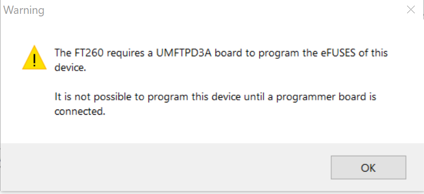

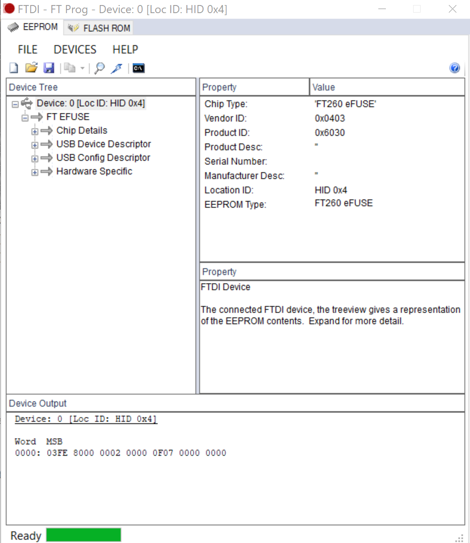

I'm having some issues programming a band new FT2232H from Digikey.
Screenshot 2021-02-13 170128.png (156.02 KiB) Viewed 16702 times
Screenshot 2021-02-13 170005.png (35.3 KiB) Viewed 16702 times
Re: Programming the FT2232H
Post by g8gtz » Sat Feb 13, 2021 6:03 pm
Having programmed over 1,000 of these I can tell you that's not right!
Either you have other FTDI devices plugged which it found or what you think is an FT2232H just isn't one....

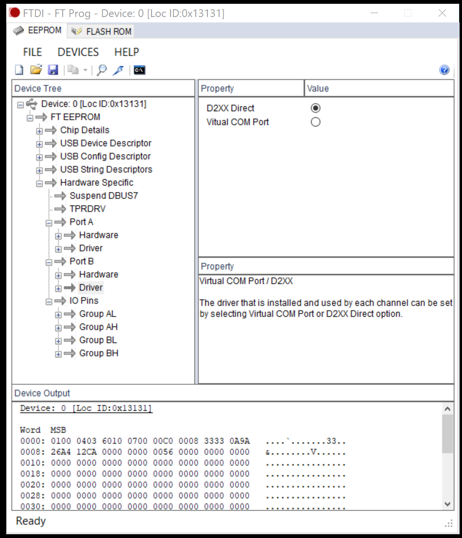

I popped the unit in a Minitiouner and programmed it ok. Do these settings look correct?
Screenshot 2021-02-14 001036.png (204.13 KiB) Viewed 16640 times

Post by g8gtz » Sun Feb 14, 2021 8:44 am
For future reference, the USB module must be plugged into a PCB to be programmed (shorts out 2 power pins) but power does not have to be applied to the PCB as the USB supply is adequate.
Difficult to say, presume you used the xml file from here for MiniTiouner https://wiki.batc.org.uk/MiniTiouner_ha ... USB_module or here for Knucker https://wiki.batc.org.uk/Knucker#USB_Module
