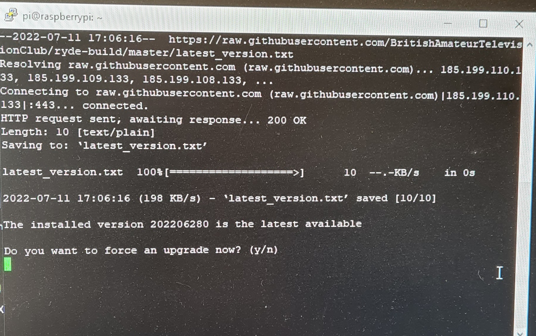

Re: Ryde + pi 2gb, MiniTiouner
Dave,
I was just looking to see if a keyboard or mouse made any difference but no, I do use ssh to pi 4b
Picture with details attached.
- EC78503D-04BC-49D5-B346-9A15ECE8FD3A.jpeg (604.89 KiB) Viewed 6434 times
Dave,
Sorry forgot to add soft ware on mini sd from batc shop, now updated.
