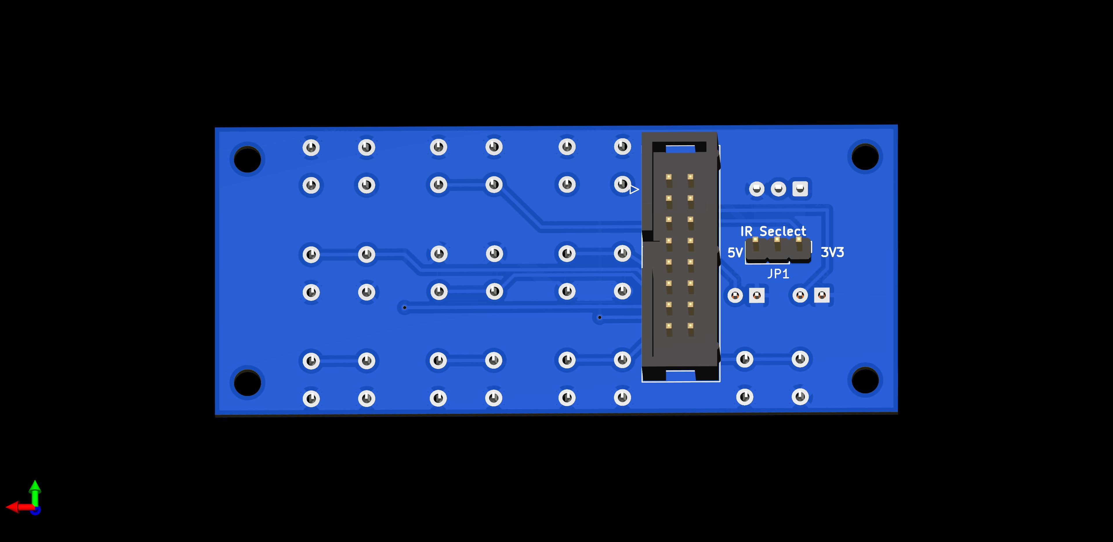

On the ryde schematic there is a JP1 listed ….but I have not found this anywhere on the Ryde front panel board ….does this link need to be in place somewhere…

Turn the board over and look at the other side... JP1 selects 3.3V or 5V IR sensors. Use a 3.3V sensor and set that jumper to 3.3V.

Post by g0mjw » Wed Dec 15, 2021 7:22 pm
Maybe this helps.

Hi mike
Thanks for that ….obvious now :oops:
