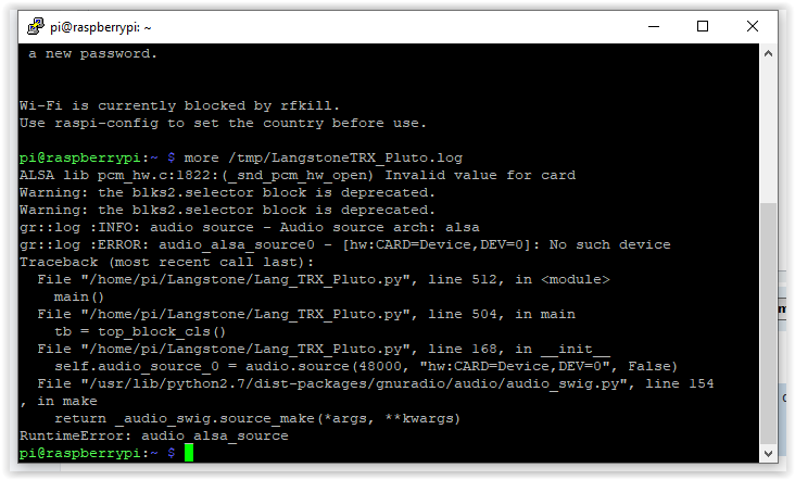

I have the same problem here. From the log file I think it is a sound card problem. I have used two different sound devices and with Pluto and Lime so far, but no solution. Which sound card is proved to work?

Posts: 2742
Re: error on Langstone
Post by g0mjw » Wed Apr 24, 2024 12:34 pm
Looks like the wrong sound device being used? Are you using the specified dongle? See the Wiki.

Post by OE3GBB » Wed Apr 24, 2024 1:07 pm

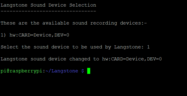

./set_sound did it! Thanks so much. 73 Gerhard

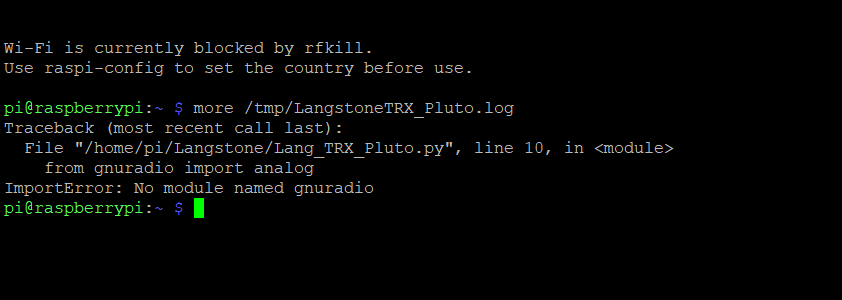

I get this for the log. There's an error but I'm not sure how/if I need to deal with it.
Get this for the ./set_sound command

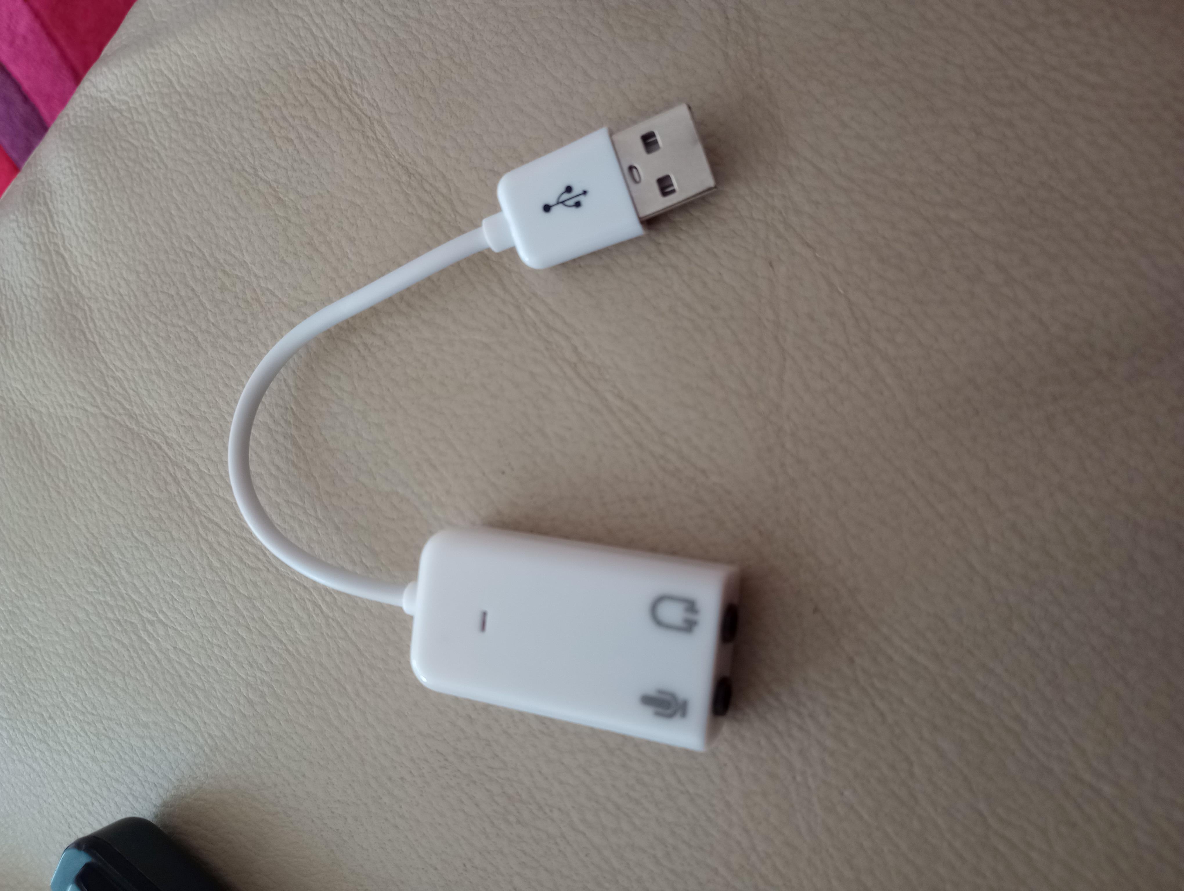

This is the USB audio interface I have. Looked the same in the eBay pictures but this has black instead of white 3.5mm sockets.

Your problem is not sound card related. The one you have should work OK.
The error log indicates that the GNURadio system was not installed correctly. This is needed for Langstone to work and is normally installed automatically by the install script. However internet problems can cause installs to fail.
I would suggest re-installing Langstone.
Colin G4EML
