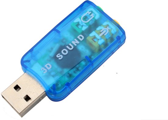

Hello, everyone
Just assembled one, but difficulties with audio
I've got several USB Dongles , Blue ones like, shown in picture
Allthough recognized by the Linux, Langstone does not start up properly
Can you specify for which dongle it is written ?
There seems to be quite a difference
Tnx 4 answer
JP, ON7MA
Tnx 4 answer
JP, ON7MA
- 3D USB Dongle.jpg (22.92 KiB) Viewed 224449 times
It is written to use one of these
But some people have used other types. It may be necessary to edit the files Lang_TX.py and Lang_RX.py to change the device name. It is currently set to ‘ HW:Device ‘
If you log into your Pi and enter ‘ aplay -L ‘ it should give a list of device names. Look for the ones that start ‘ HW: ‘
Colin G4EML
Colin G4EML
Collin,
Tnx for answer, yep, did the trick..
in the python scripts you are looking for "hw:CARD=Device, DEV=0"
but the 3D dongle was named "hw:CARD=Set,DEV=0", so I changed, and rerun'd with succes
Now I have noise, for ex on FM, but the Sound = chopped in a freq of 3-4 Hz.. is this normal ?
JP, ON7MA
JP, ON7MA
Hi JP,
No the sound should not chop. Someone else had a similar problem and eventually replaced the Dongle.
It may be that some dongle sample rates are not very accurate. That can cause chopping of the audio because it runs out of samples.
At the moment I do not know how to fix that problem!.
Colin.

OK, Colin
I just read Claudio had the same problem
After replacing his dongle, it worked
Mine is ordered..
I'm waiting for it
Tnx, Jemp

hi Jemp,
the dongle I used is exactly the same as yours...
with the suggested one it's ok now.
unfortunately the UK ebay shop where I bought it lists another model now!
Claudio
