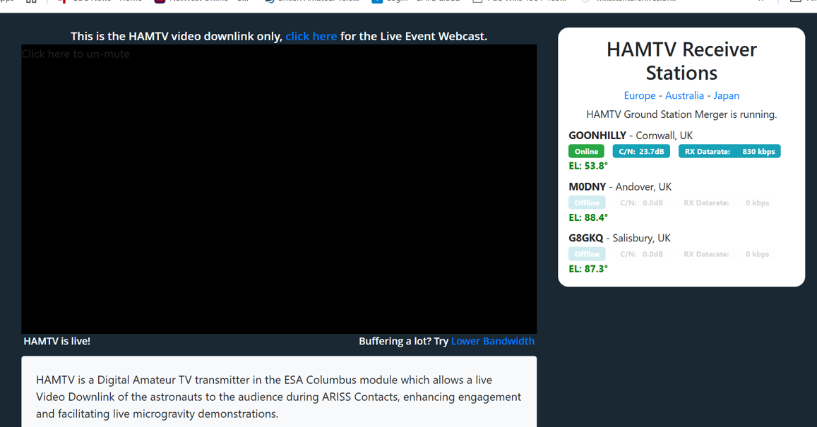

just for info, I monitor the ARISS HAMTV Goonhilly Ground Station Merger (Link below) which not only shows the ISS path position but also the live HAMTV downlink video received on 2395 MHz. This presently shows the Black Screen as soon as Goonhilly locks onto the ISS Signal. The C/N and RX Datarate are indicated along with the ISS Elevation at Goonhilly.

This what you see on the Goonhilly HamTV monitoring site. This was a pass at approximately 12.00 BST today, max elevation 69 degrees. The C/N peaked around 23dB and gave a very useable signal down to very low elevation.
