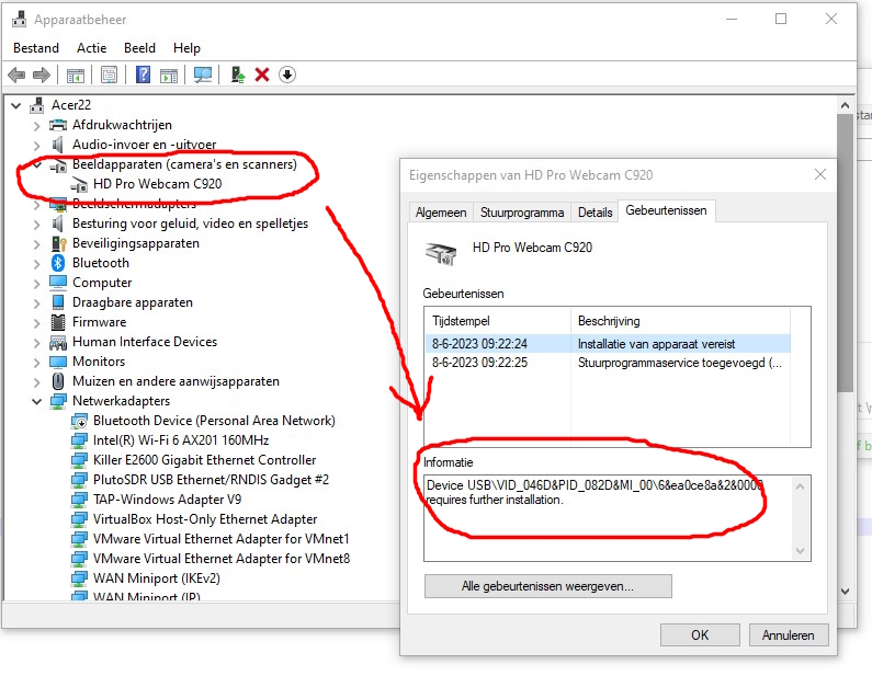

The Portsdown should work with an "old" Logitech C920 camera. Maybe you have one of the newer types with brandname "Logi" on it instead of Logitech. These C920 have different USB VID and PId and won't work.
Easy way to find out the VID and PID is to plug in the camera on a windows computer and go to setup > device manager.
Then you select the C920 camera and look at the properties:
I have not tested with a PIcam, but the Picam may need a sound input device as Brian already wrote.
