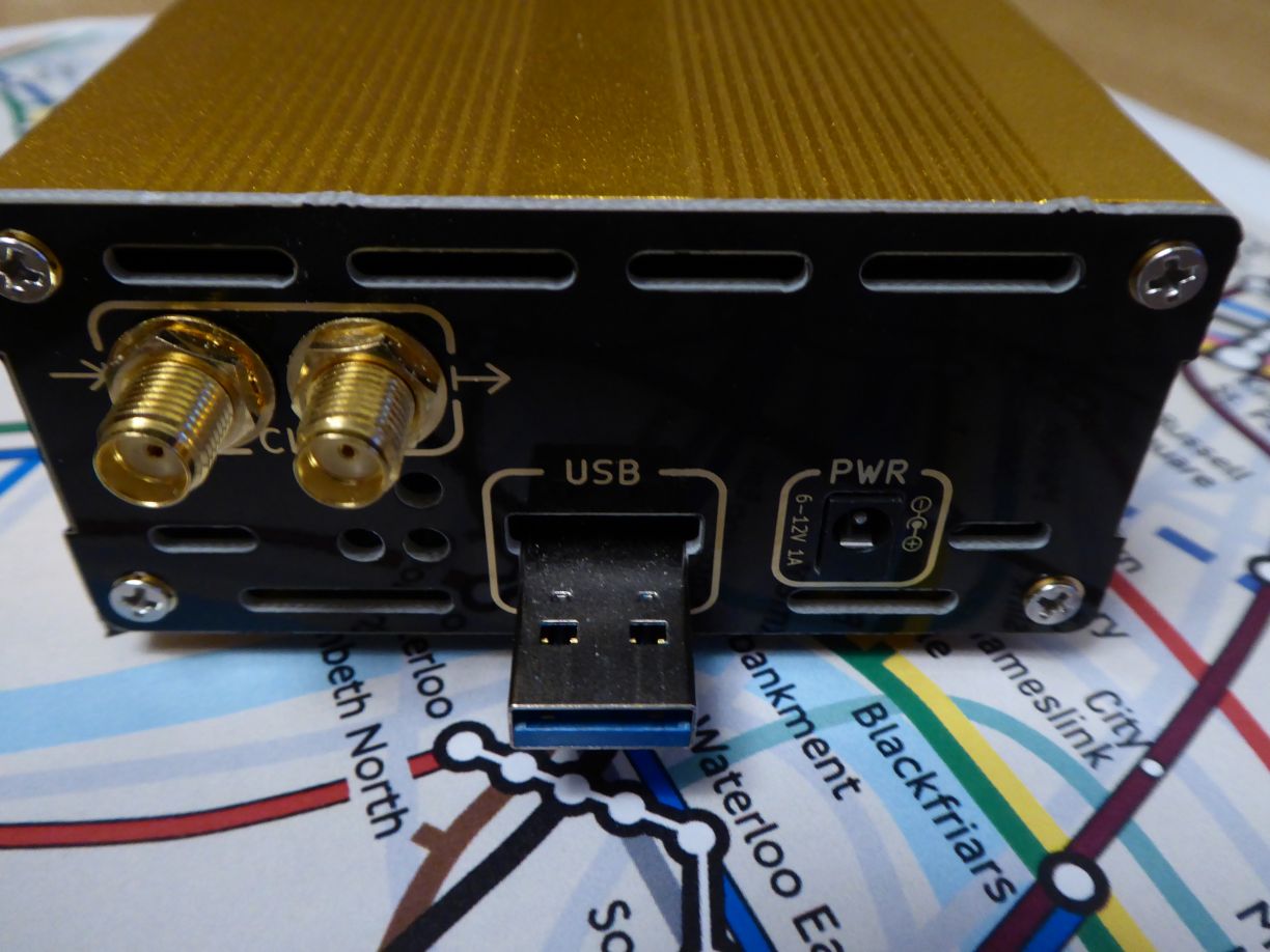

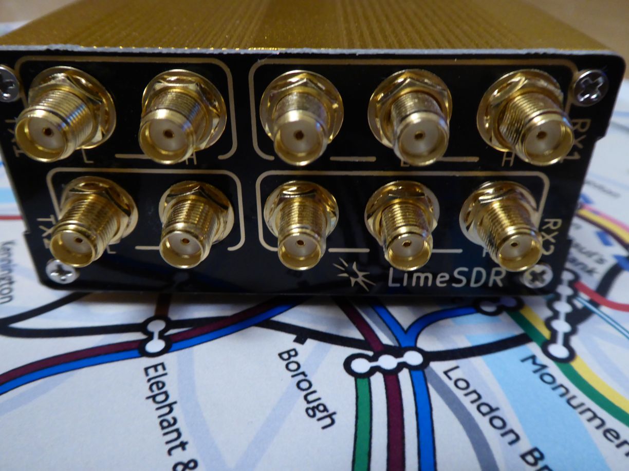

Hi Mike,
They get very hot so I suggest a small fan blowing air over the PCB. There was an affordable case available, I am not sure it still is.
This is basically two PCBs front and back and a cheap metal clam shell enclosure with a hole for a fan.
