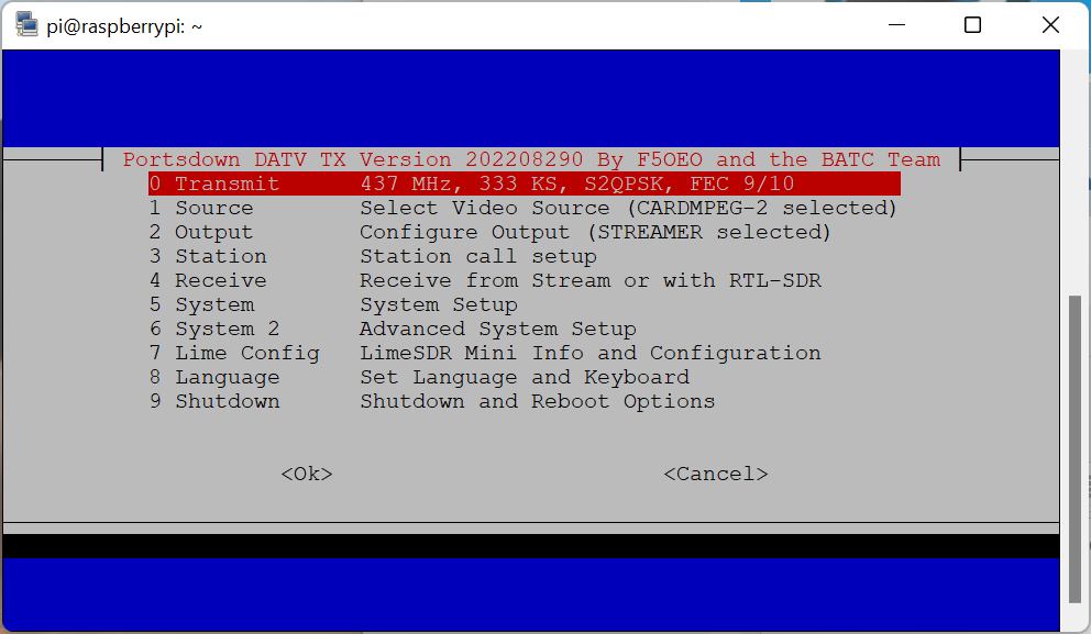

Post by g0mjw » Fri Sep 02, 2022 7:54 pm
you type menu in the console. It should show this:
console

Re: Portsdown 4
Post by g6hfs » Fri Sep 02, 2022 8:15 pm
Ok, so gui is menu to me but all working now is there a reason you have enter info in the menu, and not from touch screen?

Re: Portsdown 4
Post by g0mjw » Fri Sep 02, 2022 8:24 pm
Hi Brian
Good, where are you streaming to?
The problem with using the touch screen is the keyboard and the amount of development work it would need. Also the original method was this, ncurses https://en.wikipedia.org/wiki/Ncurses and the touch screen came later. Dave has done a fantastic job making this so much more accessible, but occasionally the command line is required. The text mode 'gui' that you see is like a menu system from the 80,s but even now 40 years later, sometimes you need to be familiar with the console. It makes it easier with menus that look like windows but it really a text mode interface.
Edit - PS, you might be able to enter this via the touch screen, I always use the menu because it is so much easier than an on-screen keyboard.
